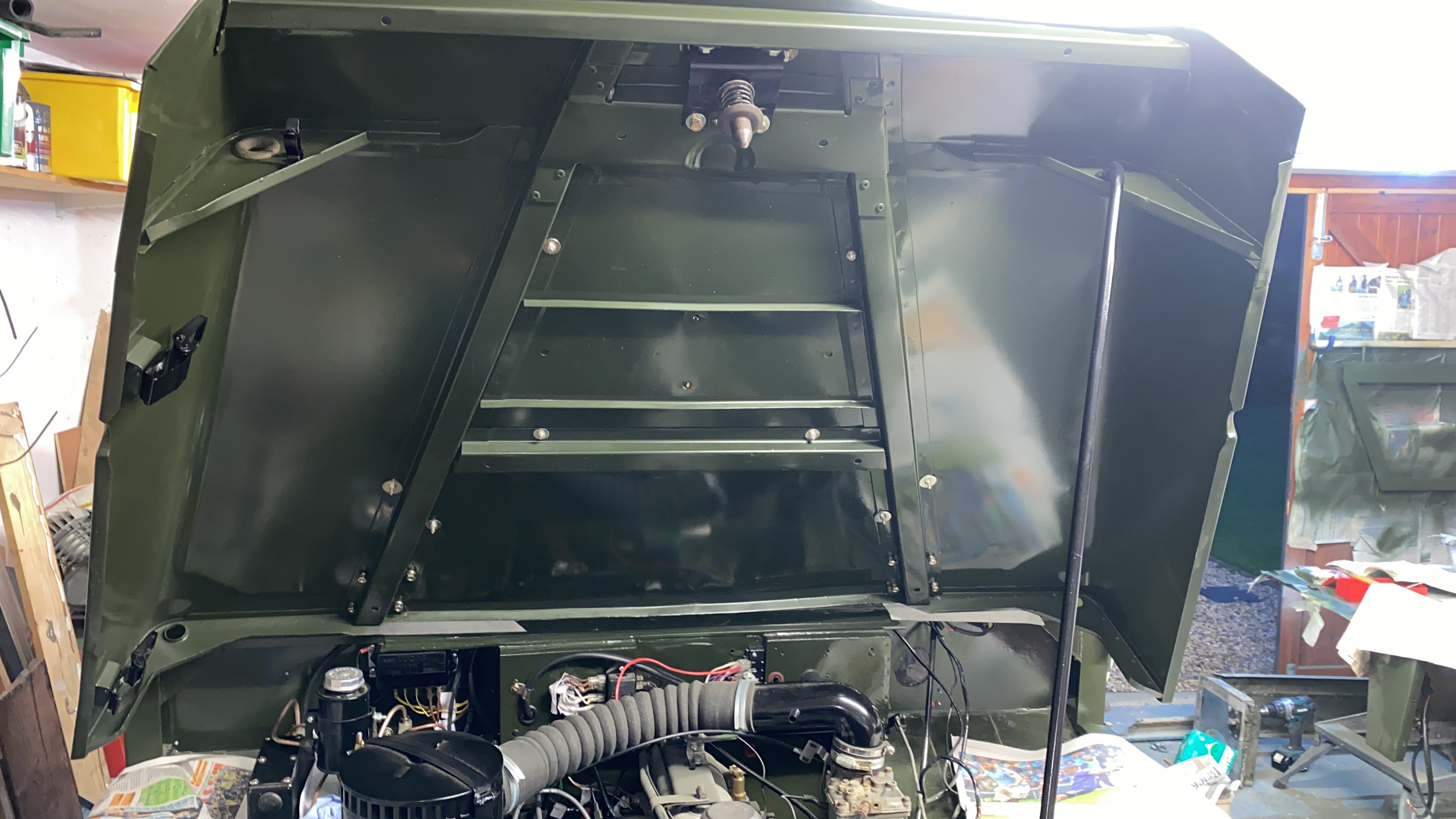

Post by landylees » Wed Jun 17, 2020 11:01 pm
Fitted all the bits to the bonnet, now ready to go in the truck

Post by landylees » Sun Jun 21, 2020 10:07 pm
No progress this weekend as I have been visiting my mum. Thursday though I fitted the bonnet.

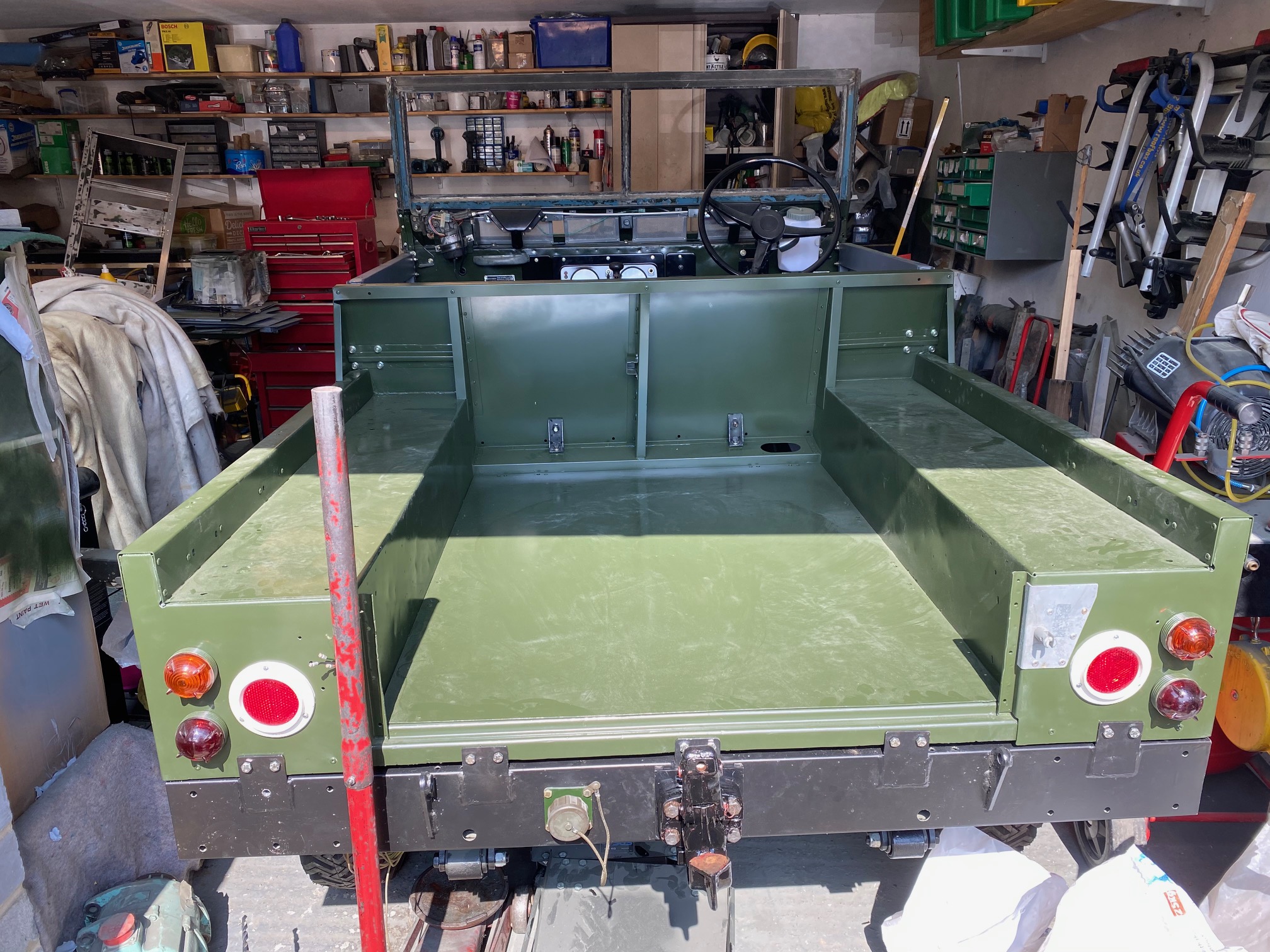

Post by landylees » Fri Jun 26, 2020 10:52 pm
Fitted the rear tub today, hopefully for the last time. The spacers that I made for the outriggers were the wrong size so I had to make some more. Fitted a new passenger side door lock and now the door latches properly. in the last few days I have also painted and fitted the NATO tow hook that brinv8 kindly hand delivered last week.

Re: Series IIA Chassis up rebuild
Post by landylees » Sun Jun 28, 2020 9:00 pm
Rear tub fully tightened down.
Rear indicators, tail lamps, stop lights and convoy lights connected and tested.
Leak from clutch master cylinder found and rectified.
Front right side light and indicators connected and tested.
Horn wired up and tested.
Found the issue with the headlight floor switch, now have power at the headlights.
Main beam warning light doesn't illuminate and rotary lighting switch has a couple of dead spots so needs stripping down.

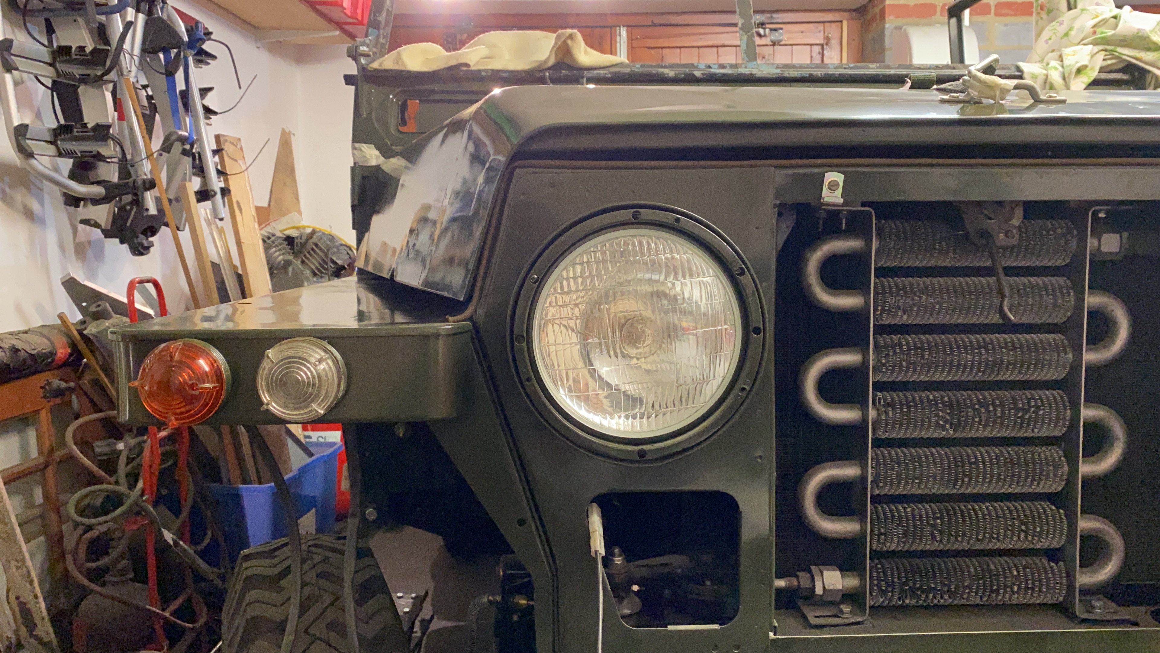

Post by landylees » Mon Jun 29, 2020 11:26 pm
Refitted the 6 way rotary switch.
Wired up the head lights and tested, main beam indicator light now works also.
Discovered that whilst I tightened up the unions on the the clutch, I also need to do the same to the brake pipe junction - note to self (not sure why as I won't read it),when you write notes of things like "tighten brake & clutch unions when bulkhead secured" that you should actually read it and then do it! I suppose the same applies to the "tighten front gearbox output shaft nut" as this might explain why EP90 is leaking from behind the prop shaft.
