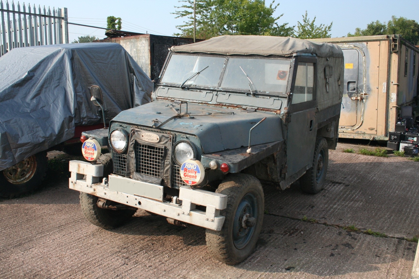

I bought the Land Rover in May 2017 and had it delivered a couple of months later once I had cleared a space in the garage. I bought it from “John Richard Surplus” in Hinstock who I have used and visited regularly for many years. My other Lightweight, 1976 Series III, came from there 25 years ago.
Whilst I already knew that it’s back was broken (and it needed a new chassis), it had a seized V8 in it and was generally in poor condition, my initial assessment showed it was as bad as it could have be.
  • Seat bulkhead cracked and bent
    Large hole drilled in lower bulkhead using series of drill holes (to aid airflow to heater ?)
    Passenger side wing butchered to fit V8, lots of corrosion to both wings
    Hole in gearbox where starter motor pinion may have been ejected at some point in the past
    Left hand bulkhead leg and associated chassis cross member missing completely
    How made fuel balancing system between the tanks
    Large bow in the middle of the windscreen

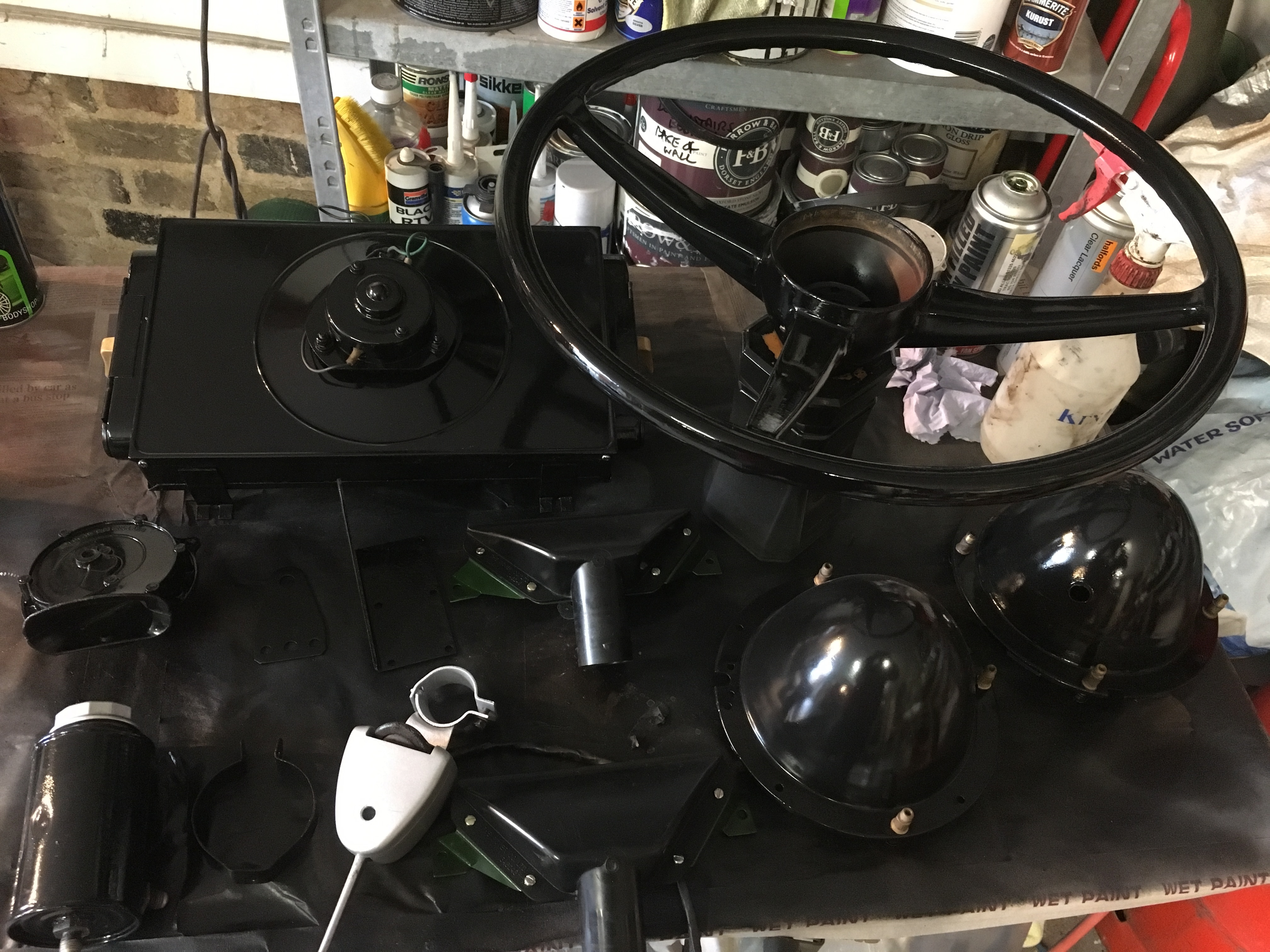

Since all my previous rebuilds have been held up the time taken to refurbish minor parts and I don't have a new chassis to start fastening parts onto, I have I have started with the "minor" parts...

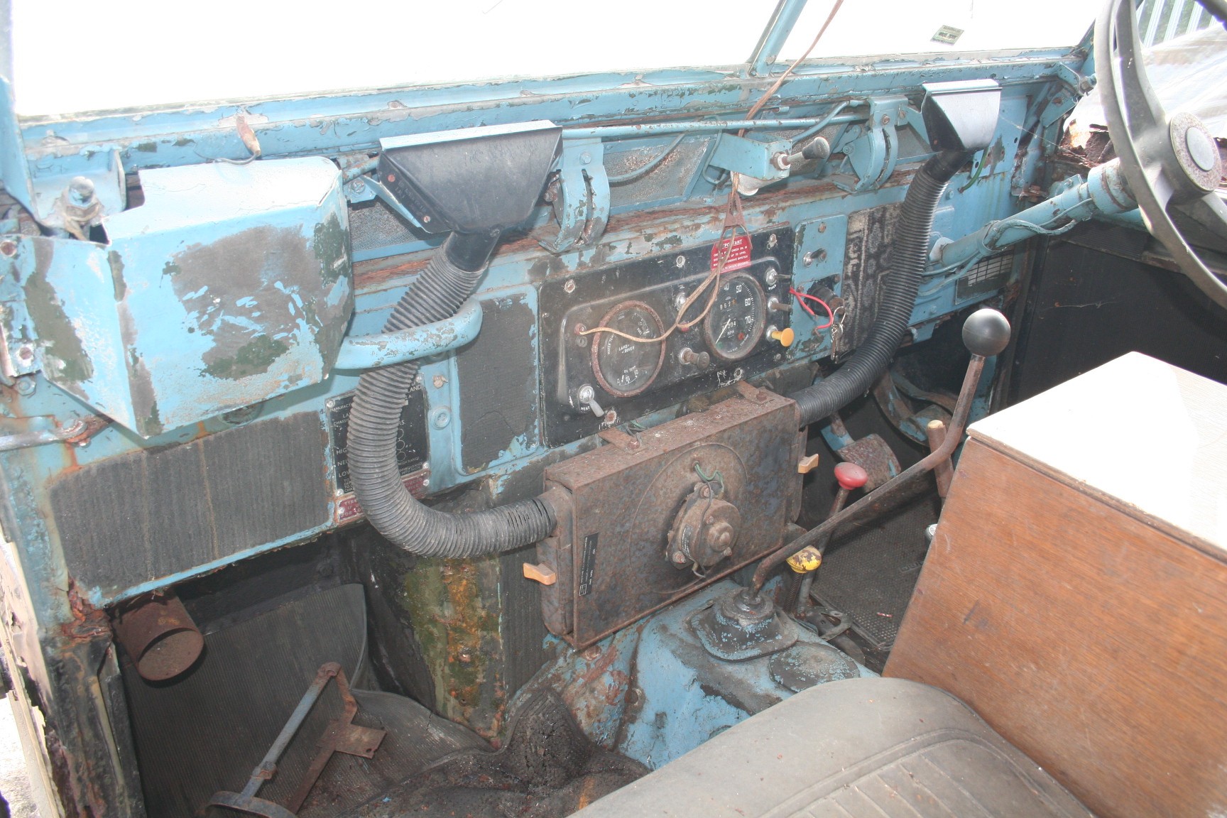

Do I spy some indicators of its having been winterised? Do you know its history?
Fred

Re: Series IIA Chassis up rebuild
Post by landylees » Mon Feb 05, 2018 8:23 pm
I don't know its history other than it has been in a barn for 10 years albeit a barn with a very leaky roof.
It does have quite a lot of evidence of it being winterised, various cleats and insulating material in the back and on the doors - however it really has been messed around with and there is nothing that can really be saved from that perspective i.e original engine gone, carpet stuck to the bulkead, oil spillage in rear that has caused rubber to blow out. I will take pictures of all the evidence.
My other FFR Lightweight was also winterised with the pipes still in place for the artic heater and various holes for pipework in the seatbase. I have a full kit and new 24v artic heater in my loft that I intend to retrofit one day.

Managed half a day in the garage today.
  • Won in my struggle to take seized clutch pedal apart, although quite possibly a hollow victory since I had to cut through the shaft and the bushes! I didn’t damage the pedal or the housing though.
    Finished preparing oil bath air filter, air filter elbow & pedal boxes for painting
    Started taking the steering box and column out.
In lieu of photos from today, I have attached some Land Rover porn…parts I have been collecting for the rebuild…will take some photos tomorrow.
Post by landylees » Thu Feb 08, 2018 4:19 pm
All is not what it seems, the washer bottle is actually a very good repro. and the rubbolite reflectors are actually white plastic (which I believe are later and replace the perished white rubbolite ones that came off the truck). I don't think there are any other hidden surprises in my stockpile though!
