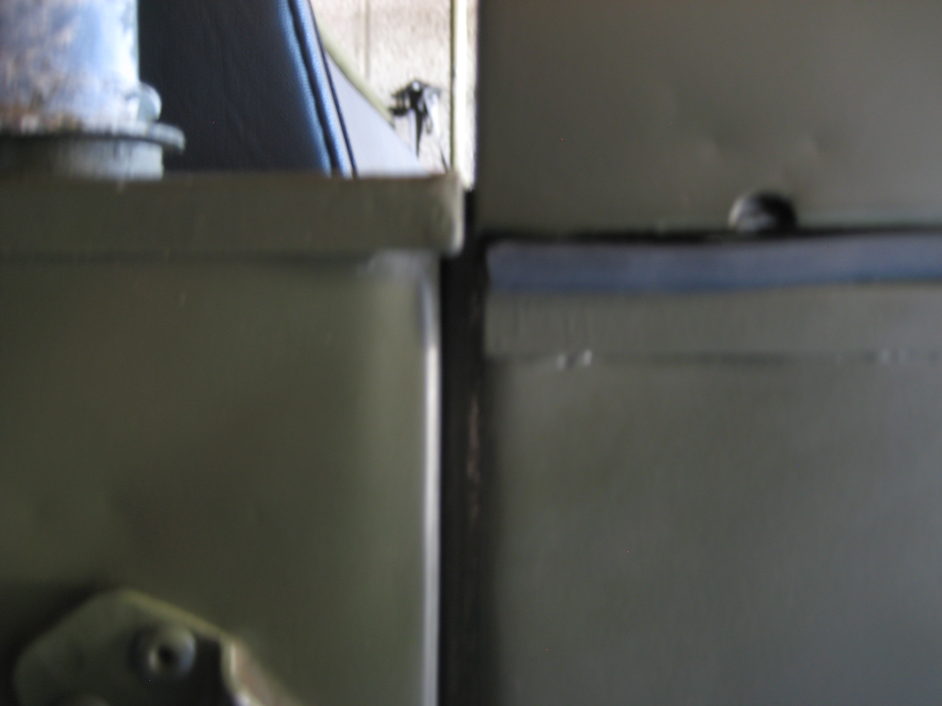

Hi Guys,hope your all well. I hope you can help me as its rather frustrating, I removed my bulkhead years ago and with time free Ive been putting it back together but I cannot line the doors up.
landrover door.JPG (985.12 KiB) Viewed 875 times
I have pulled the bulkhead as far forward as possible but only using the upright that is attached to the front of the footwell with the 3 screws attaching it to the chassis.I had the door opening and shutting like a Bently until I placed the door top on, and it hits the windscreen. Ive tried moving hinges also
Any Ideas will be appreciated .

if it is hitting the windscreen, is it possible the screen is lying at slightly the wrong angle?

jor henderson wrote:
Wed May 27, 2020 1:28 pm
If that is the cause - with a rebuild it is easy to have the windscreen rake too great as it droops without everything else in place - remember there are adjusters on the windscreen securing brackets which also give you a bit of play. I had the same problem when I was finishing my rebuild - I also found that, with the windscreen at the correct angle, the seal between the windscreen and the vent panel was too thin and left a gap. I ended up buying a thicker sealing strip which solved the problem. At least, I think it did - I have not driven it in the rain since so I may be wrong!

I have just done this, loosen everything off as Looloo says and tighten up the tie rod until you are happy. I had to tighten mine up alot and there was some horrible creaking from the bulkhead. Once you have done that tighten up the steering column/bulkhead supports. Don't forget that the hinges also have some adjustment up and down / front and back, so make sure the front edge of the door is parallel to the bulkhead before you start, then you just have to worry about the height and the rear gap being parallel to the rear tub.
