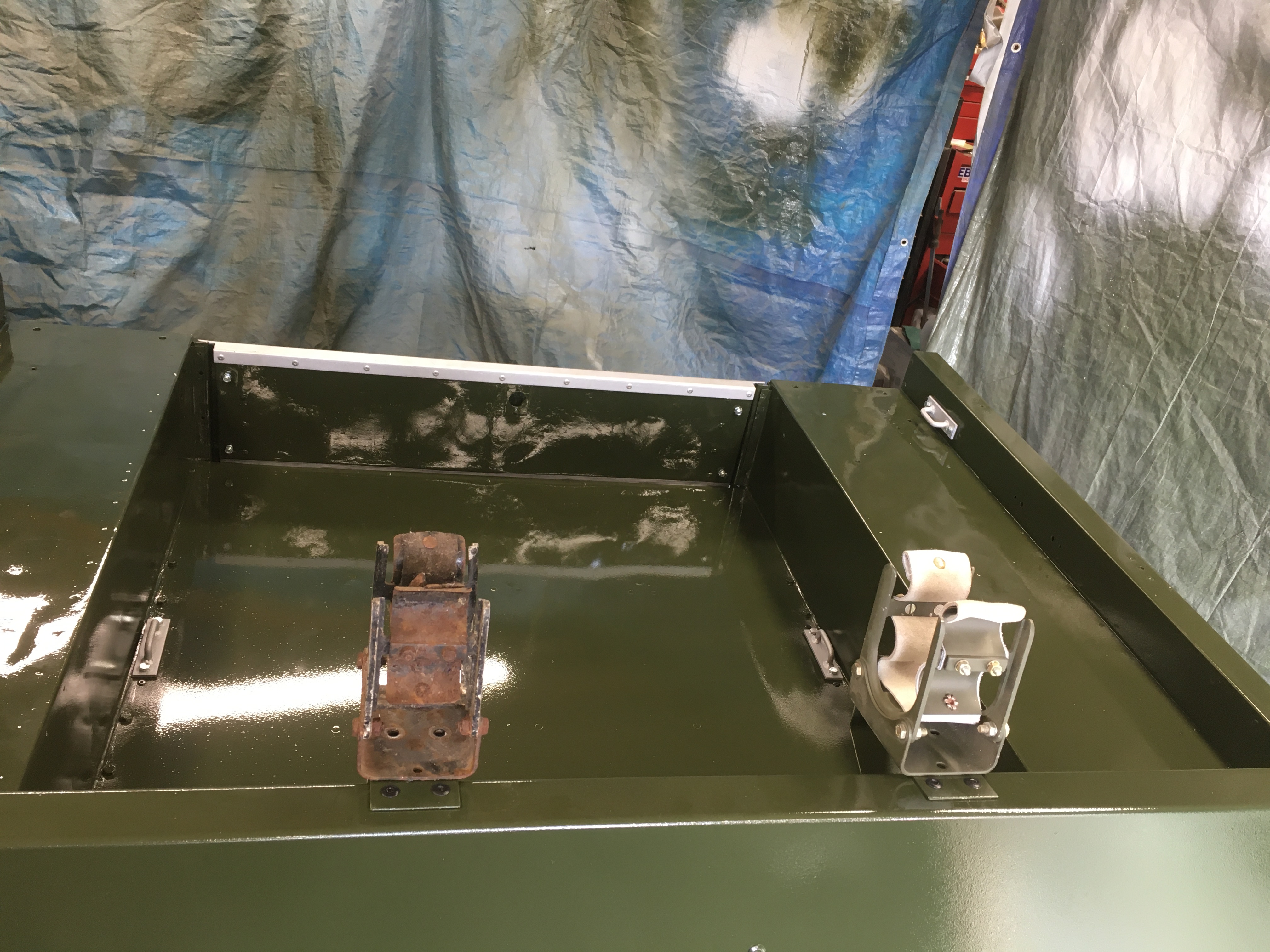

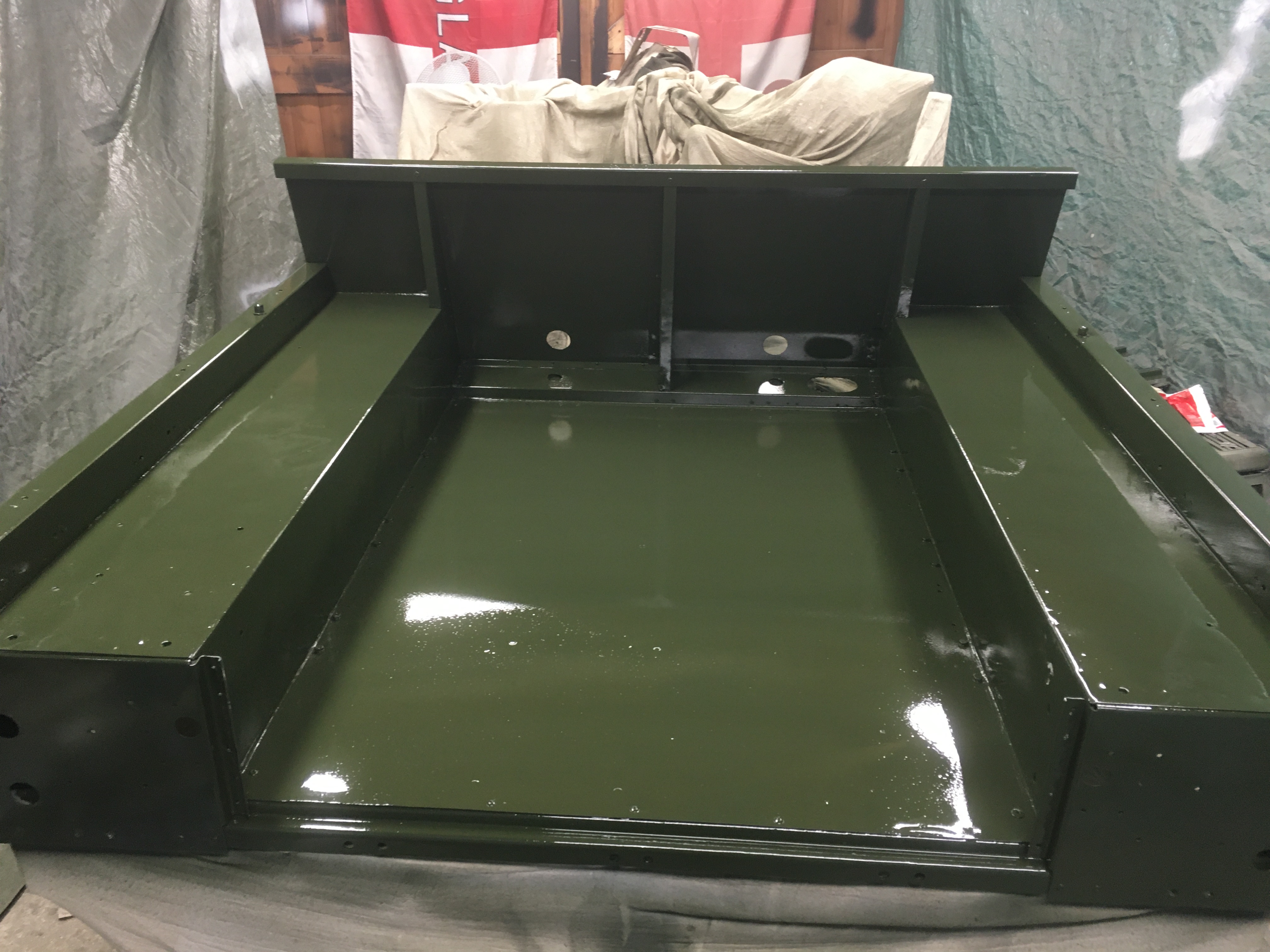

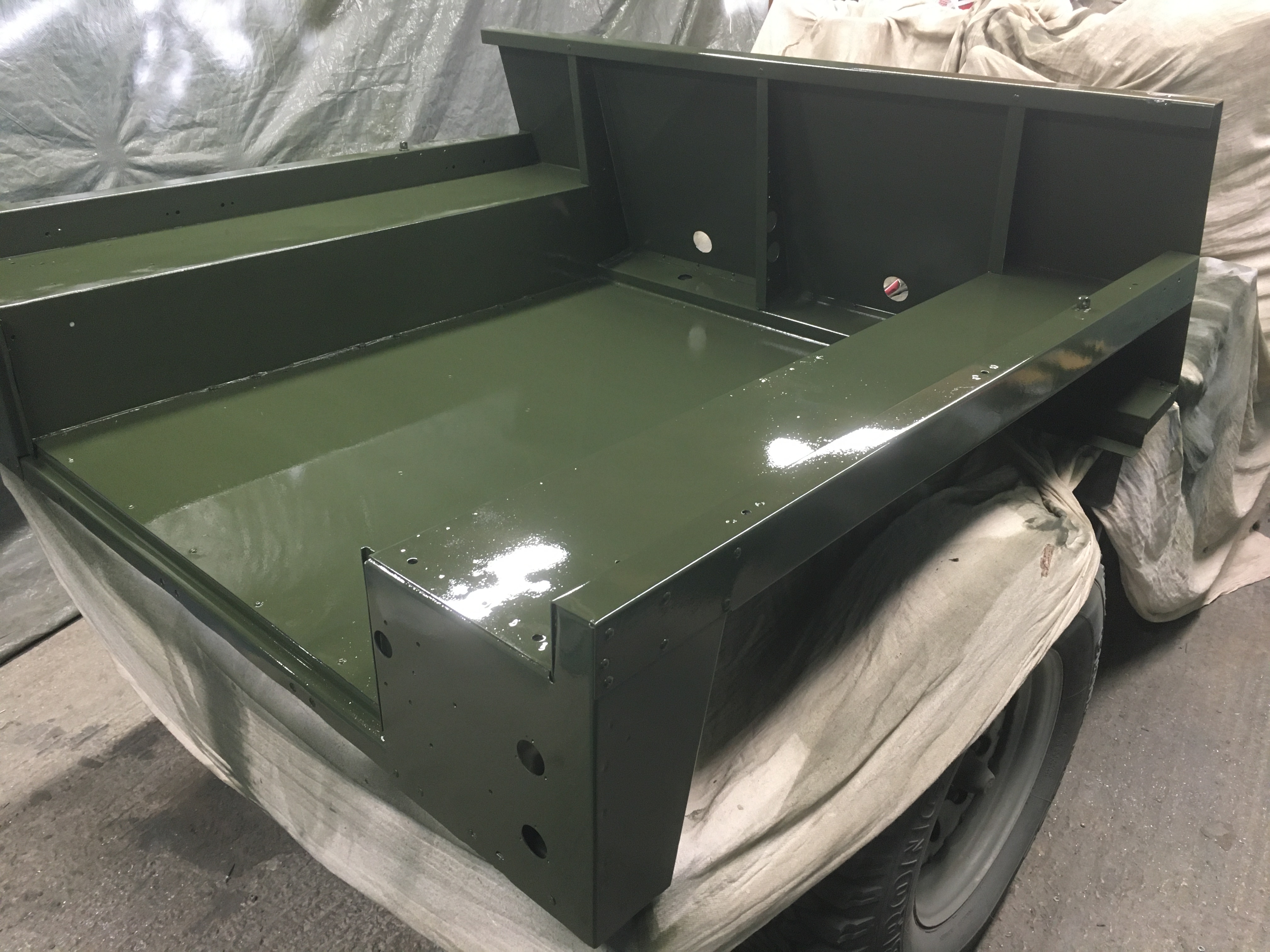

Managed to get another coat on the tub, looks a lot better, far from perfect, bit of dog fluff and some dust on it😂
Few more brackets etc coated up too, fingers crossed pick up the last 2 bits of the tub on Wednesday ish then can paint them then start putting it all back together 😂

oooh. Shiny! :mrgreen:
Re: 19FM37
Post by landymad » Sun Jun 07, 2020 11:09 pm
Wow looks great!

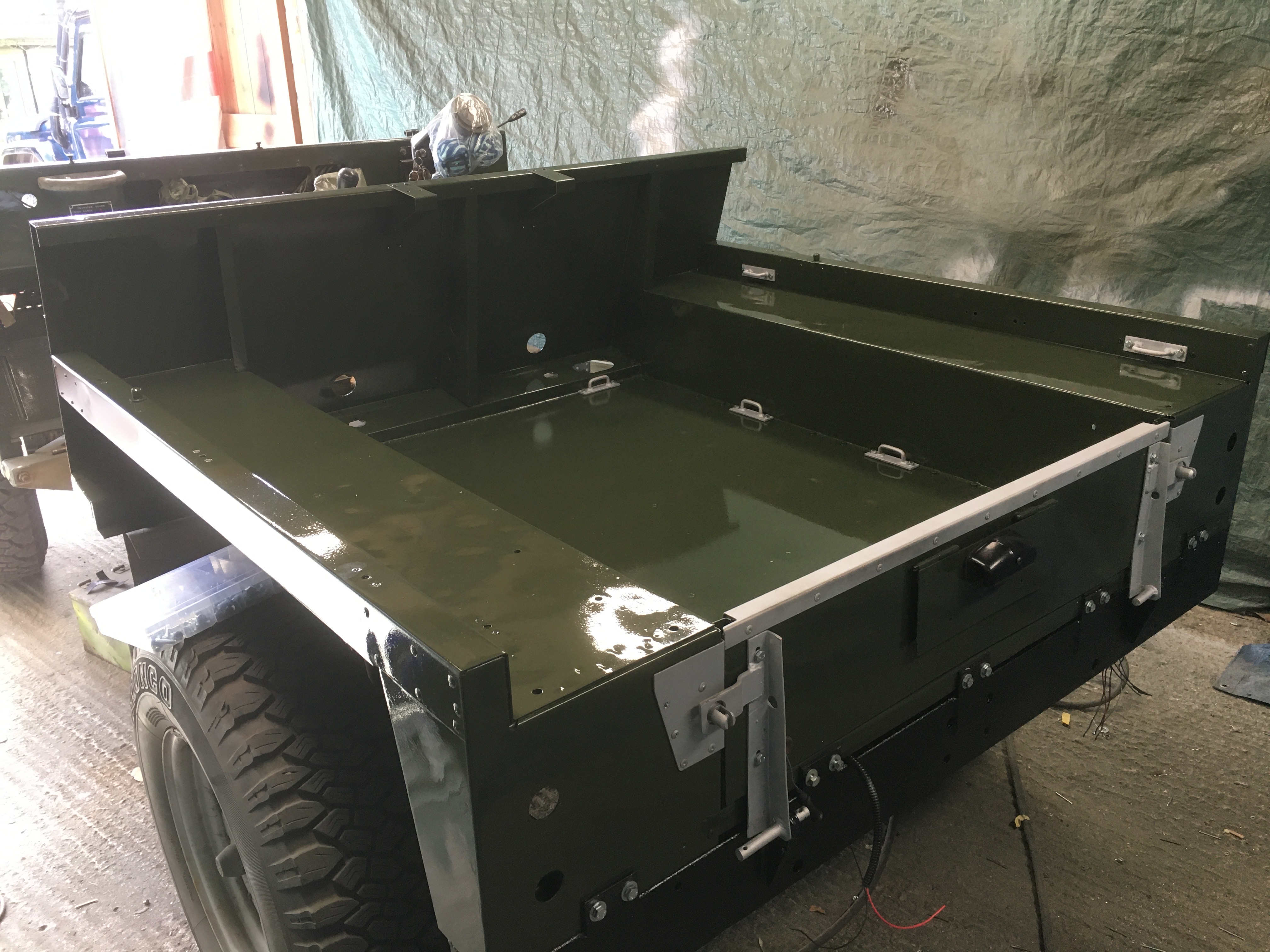

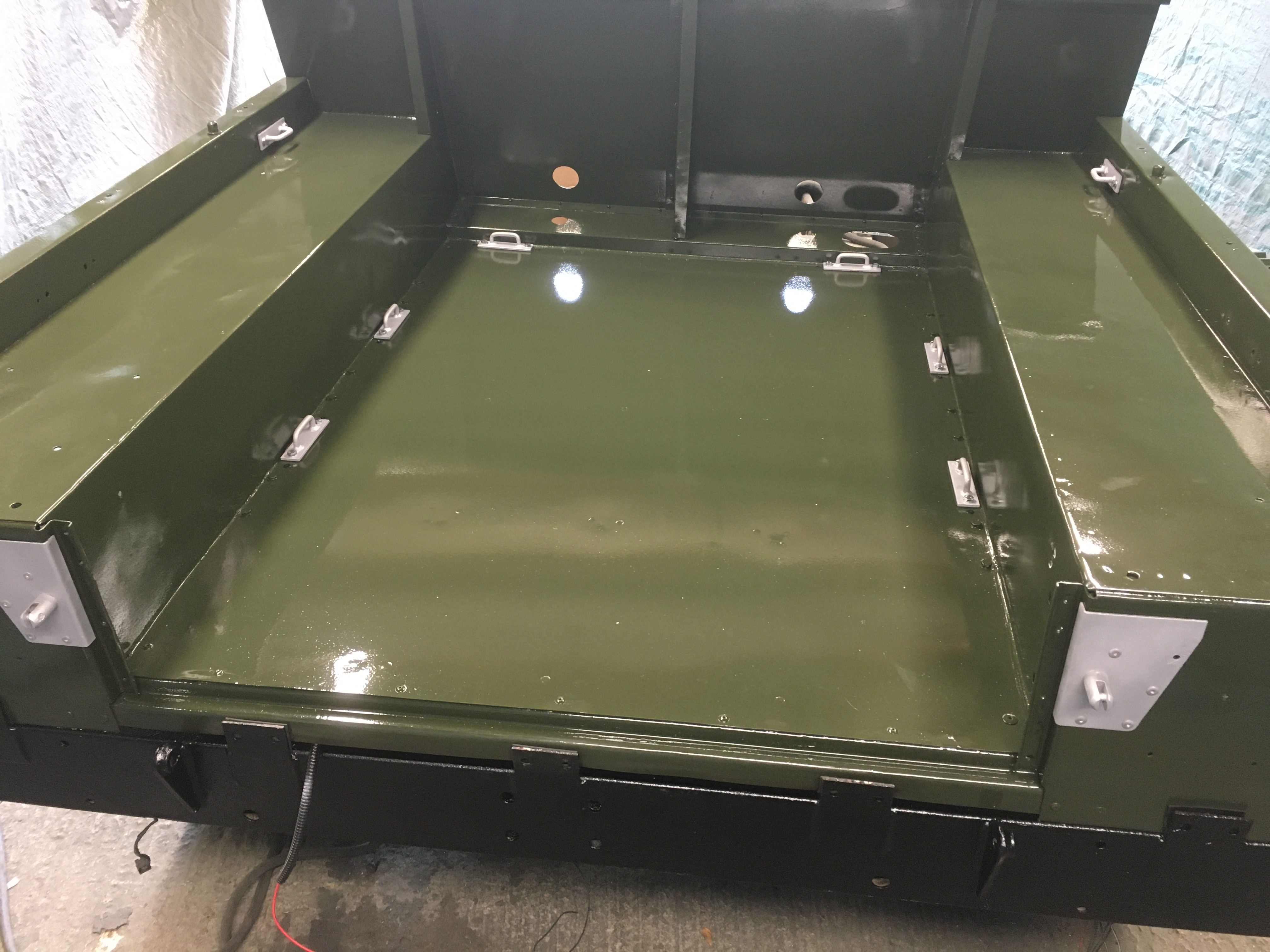

Bit of messing about today, lashing points (except as need new nuts welding on the plates) fitted, tub bolted to the rear crossmember, lower tailgate fits😳 tight on one side, but it closes, it didn’t fit that well before!
Slr brackets fitted, have got one mint clip but the other isn’t great but they will do.
Will put a straight edge on tomorrow and see how far out it is again with the bulkhead, could be fun🙄

Looks good - the rifle clips can be refurbed with split leather (cheap on eBay), and the metal parts are just bolted / screwed together so maybe you could just do that as a mini project once the rest of the truck is finished.
Tailgate looks nice and straight - mine still needs work, including a crack welding up around one of the holes.

Both upper and lower tailgates were nasty, managed to braze up most of the extra holes and straighten enough that they look ok, not overly happy with the fit but it’s amazing what die grinder can do😂 lower needs to go to the drivers side a bit and drop a little on the near side, had to slam it before it was stripped tho.
The “sameness” of parts has cropped up in the build too, I built the tub up using the original vehicles upper offside tub, the donors doesn’t fit well, high at the front with the tub bulkhead but the other does🙄 factory tolerance again!

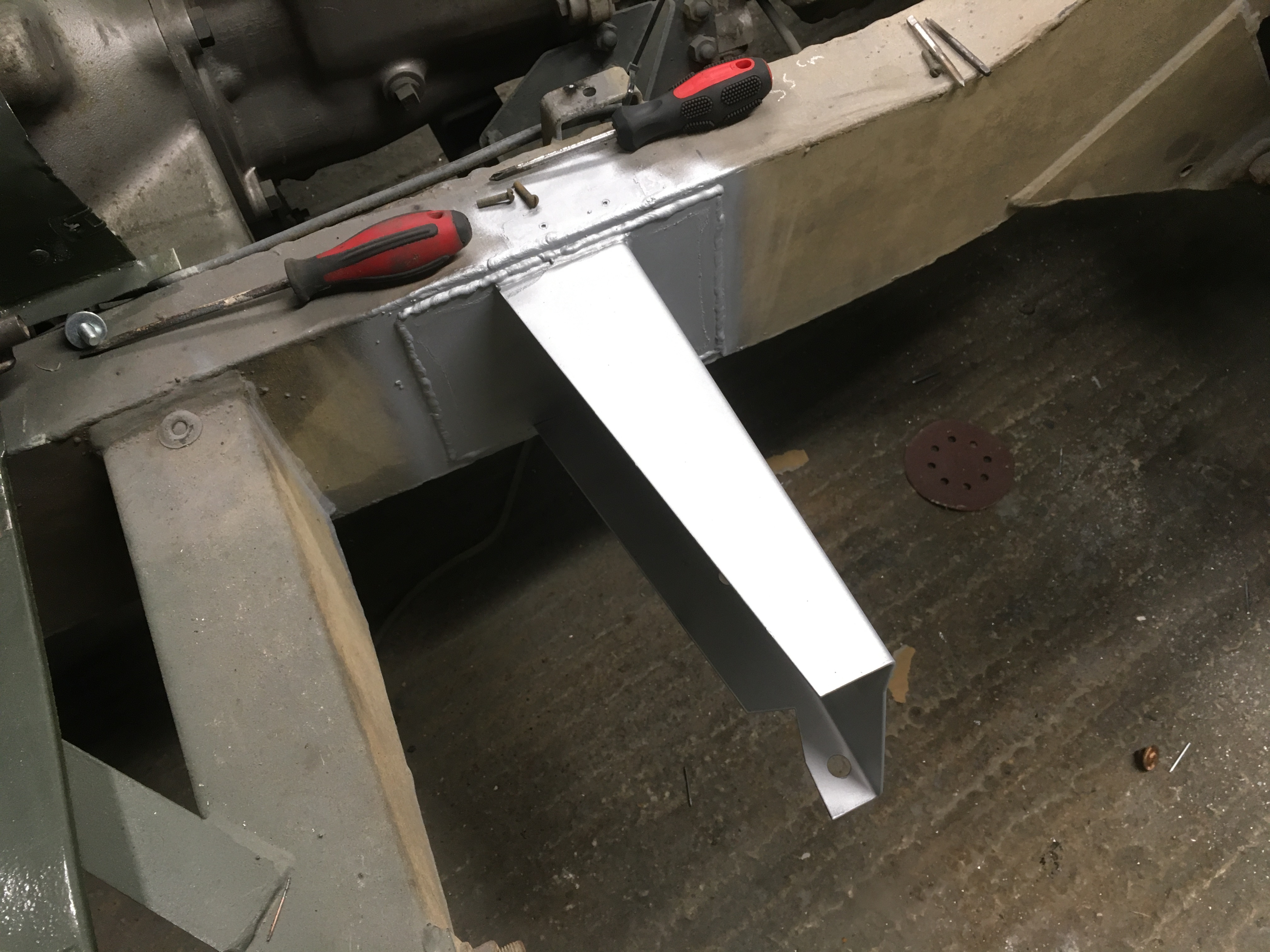

Busy day today, chap came to do the welding,
Front offside bulkhead outrigger shortened so the sill fits,
Near side front fuel tank outrigger fitted, chassis never had one, well it did but was riveted on and the tank fell off before I owned it.

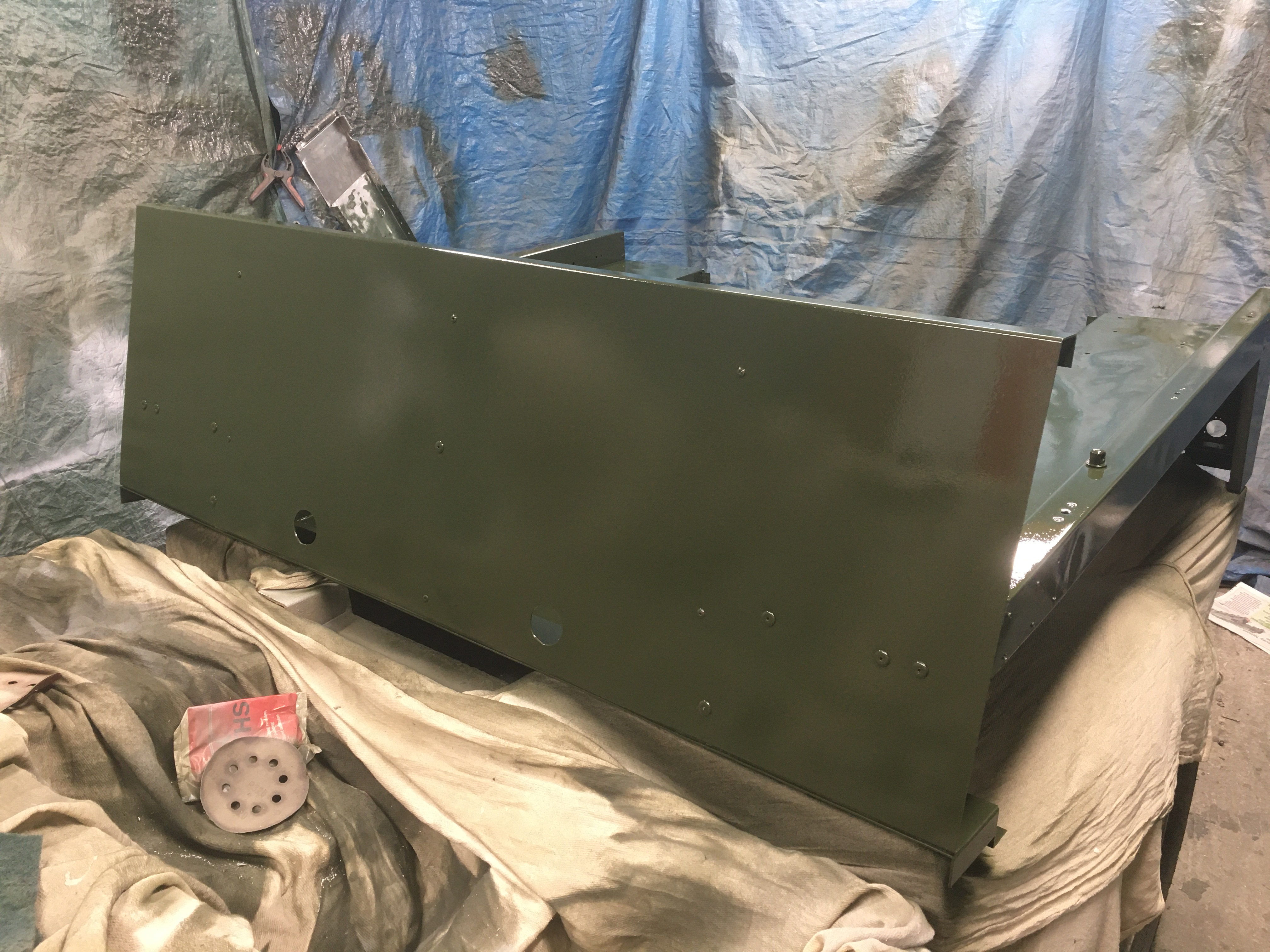

Waiting on more etch primer then I can get ready for doing lots of green😎
Having great fun with the last tub bits, one fits perfect after some tweaking but the other is trying my patience, probably due to the one they copied being bent out of shape big time🙄
Will get there though, won’t be perfect but much better than when I started😂

Post by landylees » Sun Jun 14, 2020 12:13 am
Welding looks great, wish I could weld like that
