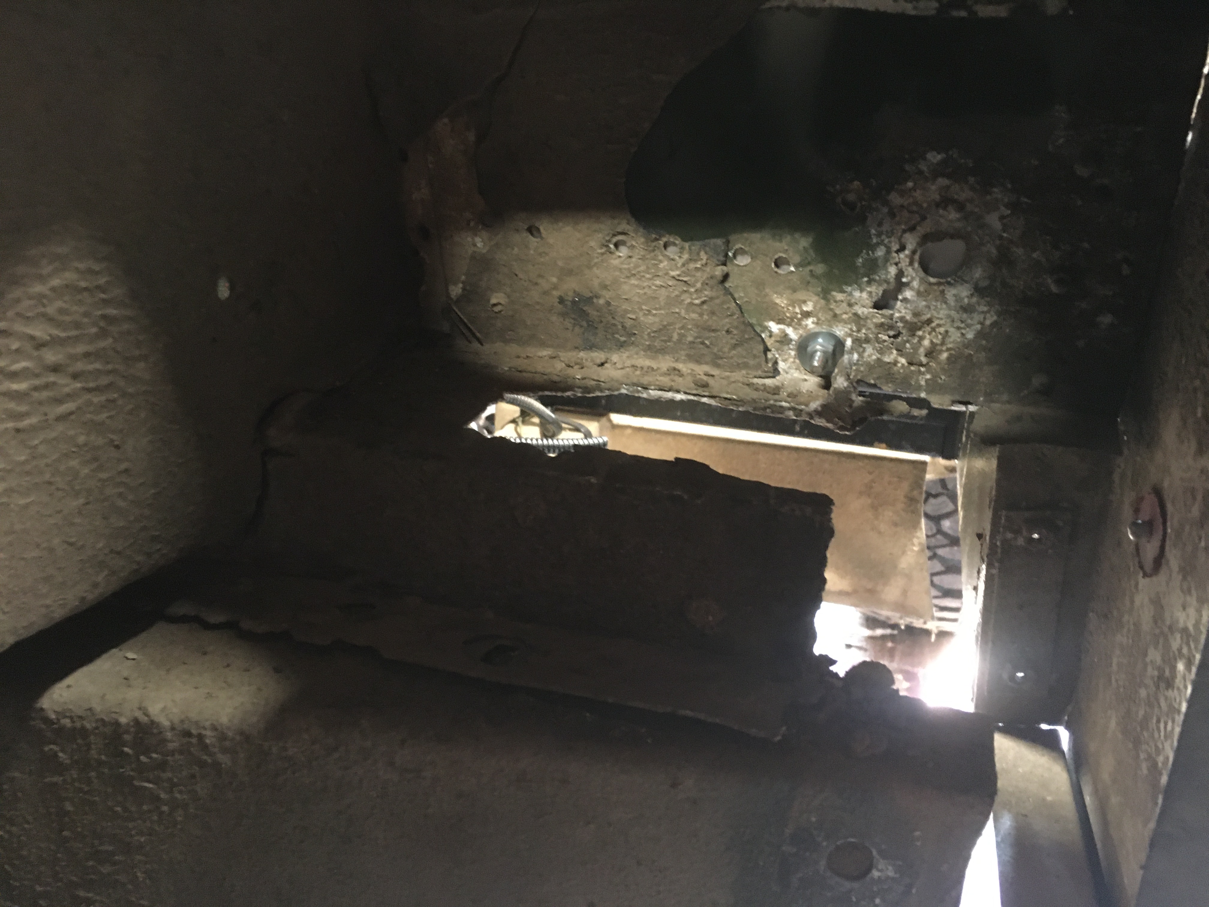

Was put on a new chassis, galv bulkhead and grille/ rad panel.long before I bought it, some issues to sort!
I’m giving it a respray in deep bronze green and putting lots right along with sourcing bits that are missing!
Terrible wiring! I’ve not modified the wiring, this is the previous owners doing ( I know I’ve owned it 20 years but never got round to sorting it)
Bulkhead outrigger sticks out through the sill :shock:
Wing filler neck meant there was no lower outer seatbelt anchor :o

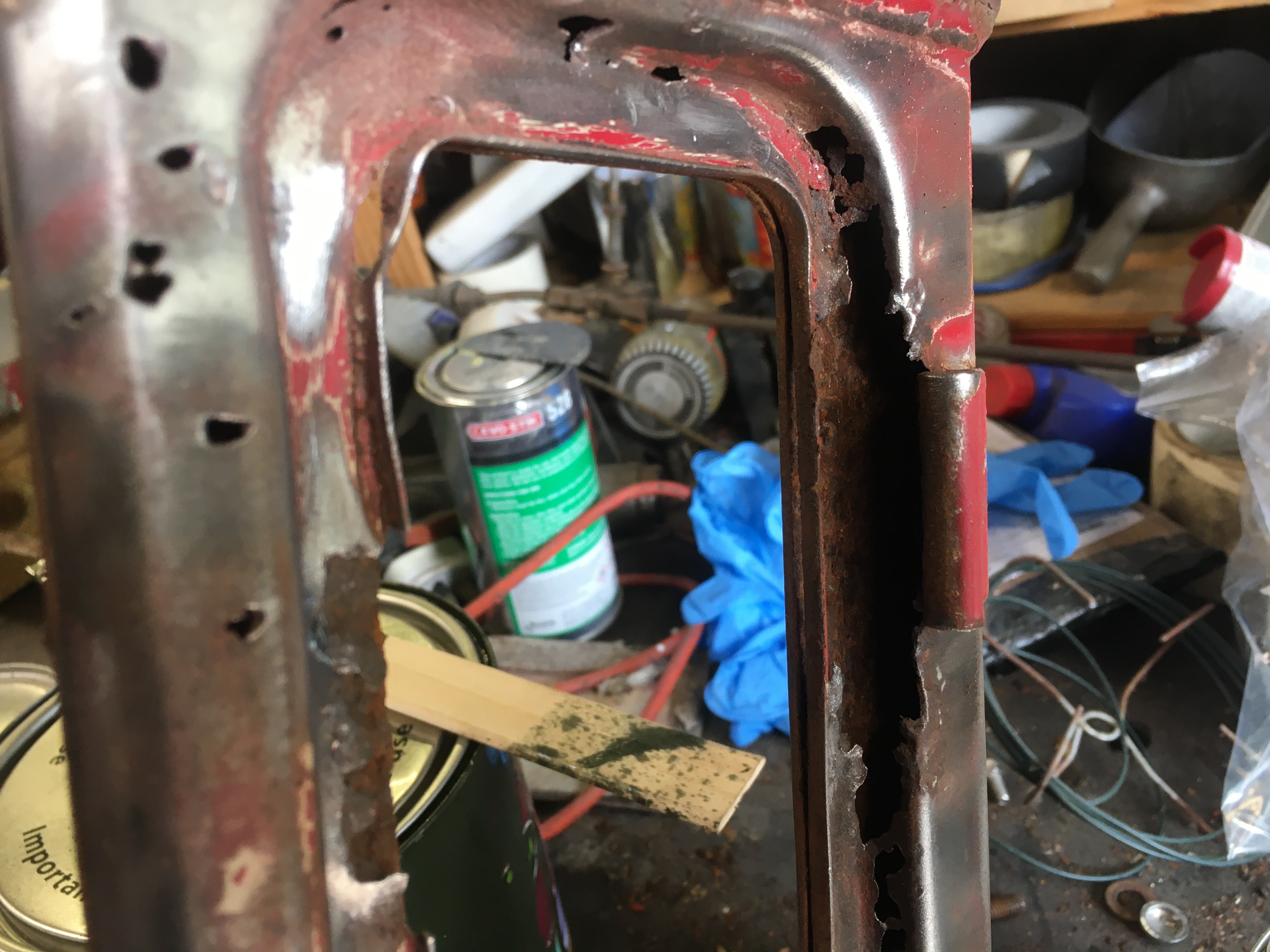

Bit of progress, Swiss cheese vent panel 🙄 last time it was painted they just used filler on it😩
Teaching myself to spray, inside of the bonnet looking ok other than a few missed bits.

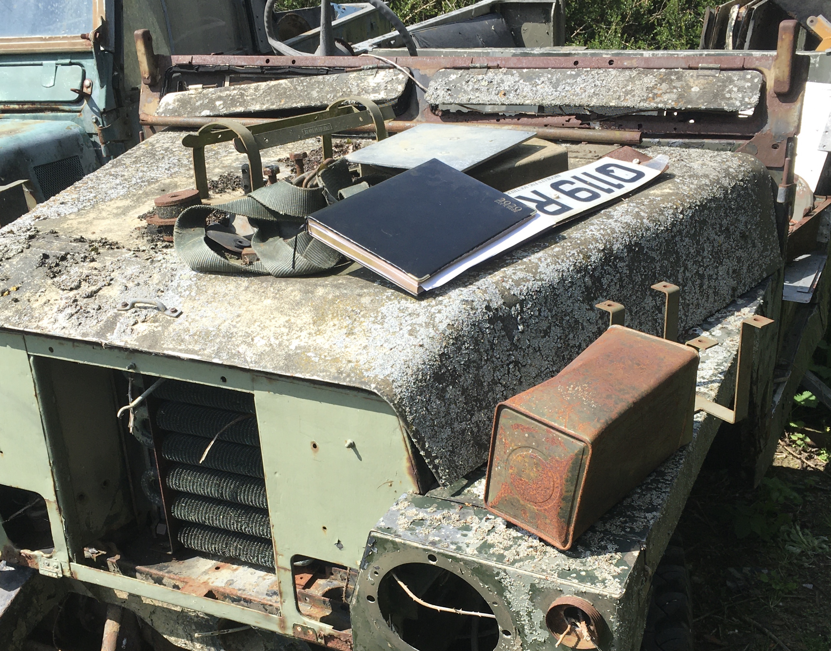

Re: 19FM37
Post by removeduser185 » Sat May 09, 2020 9:41 pm
Bigdon1981 wrote: ↑
Sat May 09, 2020 9:39 pm
I did wonder if the 4 holes might have been for an antenna box, but as it’s a GS I don’t know
Quite a few GS Lightweights have had ATU boxes fitted to the front wings during their civilian careers, so you could well be right.
