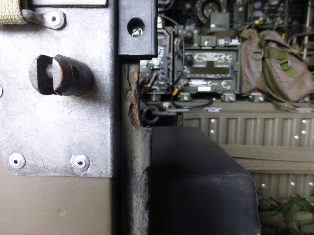

Mystery cut out;
I have often wondered the purpose of this, I've seen the same on another vehicle some time back.
I know the vehicle at some stage in it's HK life was fitted with a 'dog cage' as the mounting holes are present on the tub upper sides, but I cannot really relate it to that.
Any ideas?
Anyway, what prompted this was the fact I'm in process of replacing the tailgate seals as they are well past it. Was going to do it last year when I refurbed the tub but never got round to it.

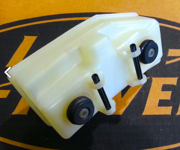

After a few weeks of trouble free motoring, I now have a weeping brake master cylinder to attend to.
So what are the options, I can get a genuine cylinder NRC6096 (without reservoir) from Blanchard's which I assume will be Lucas/TRW, I can also get the reservoir AEU1045 from them but one question is how is the reservoir fitted to the cylinder? Any info on this technicality would be appreciated.
Re: 19HF27
Post by Loulou » Sun Aug 01, 2021 11:33 am
Hello Bob,
Two large rolled metal pins which cross the foundry and are fixed on either side under the tank.
I have a complete new kit in advance (never too careful…) which also comes from Blanchard; the master cylinder is indeed TRW-Lucas and the tank is "unbranded" on the other hand the cardboard box of this tank looks furiously like Brit…

Re: 19HF27
Post by Bob Fell » Mon Aug 02, 2021 8:02 am
Loulou wrote: ↑
Hello Bob,
Thanks Loulou, that's just the info I was looking for, I assume the tank push fits onto the master cylinder ports?
