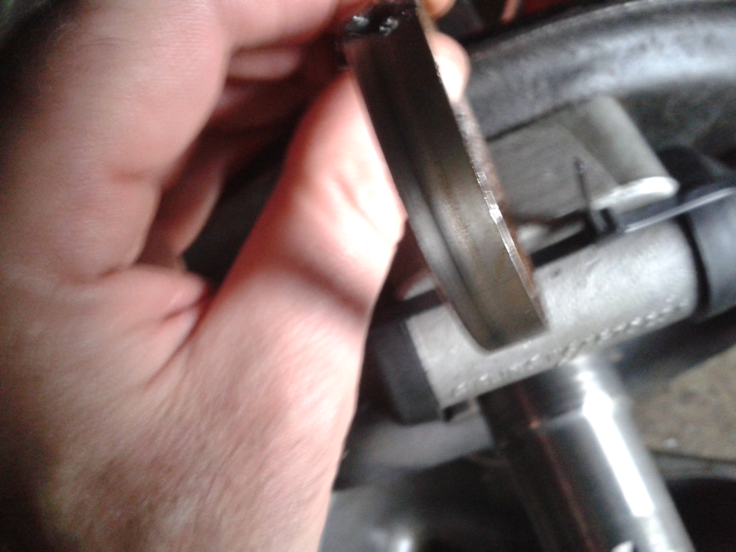

At the weekend stripped down the rear o/s hub and removed the seal carrier, all went well....
The old carrier was well knackered..
New one (from Blanchard's) fitted, went on a treat with some gentle tapping with an aluminum drift..

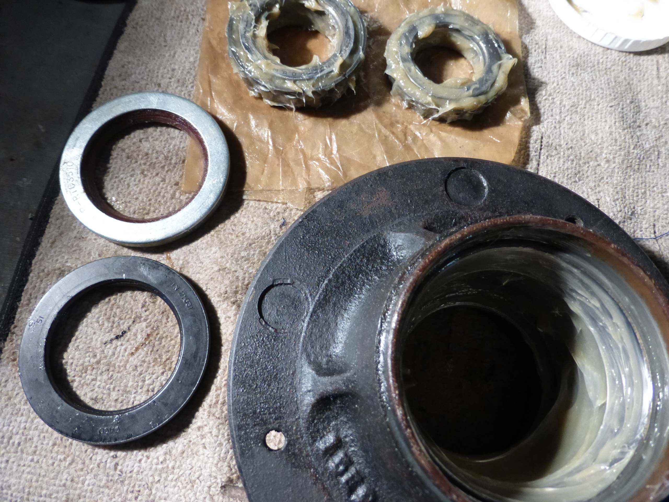

Never got time to do anything of consequence last week but here's today's latest installment;

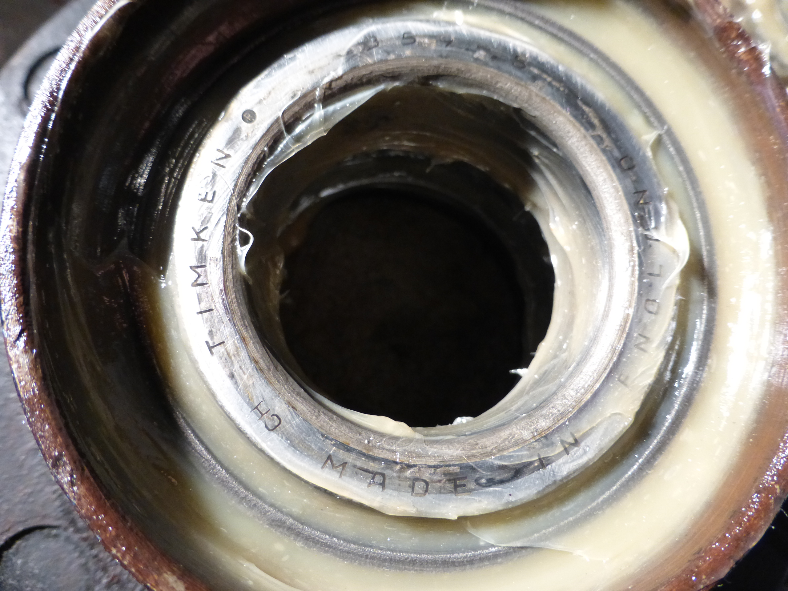

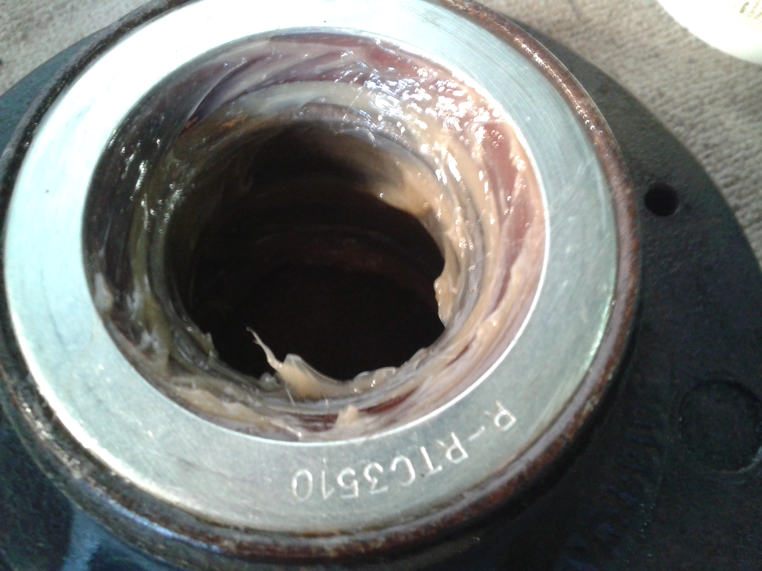

O/S rear hub cleaned out, shells and bearings inspected,all found ok and greased..
Inner race fitted, Timken, outer is SKS..
New seal fitted, having bought both types decided to go with leather as it is a much tighter fit, I've had it soaking in grease for 2 weeks and had to be careful to ensure flush fit to hub casing or it fouls the bearing race..

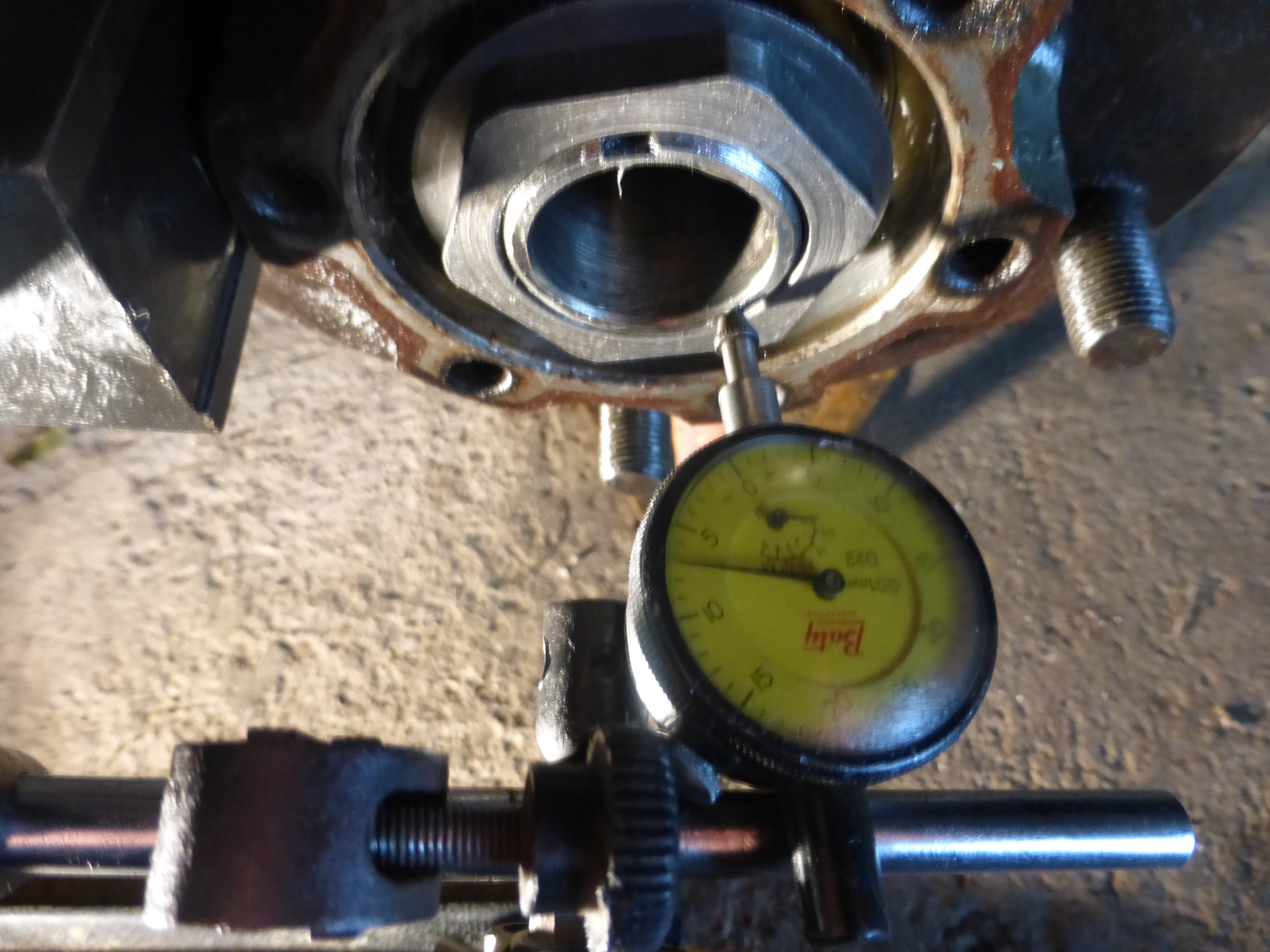

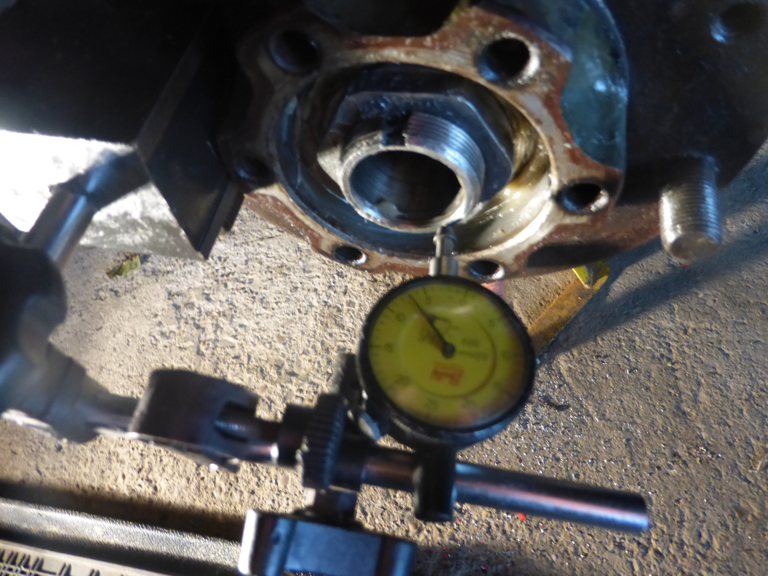

Set up float..
Recheck float with lock nut fitted and tightened..
After that ran out of time so will lock off nuts with tab washer tomorrow.

Bravo Bob, nice work in the rules of the art; bearing settings, etc.

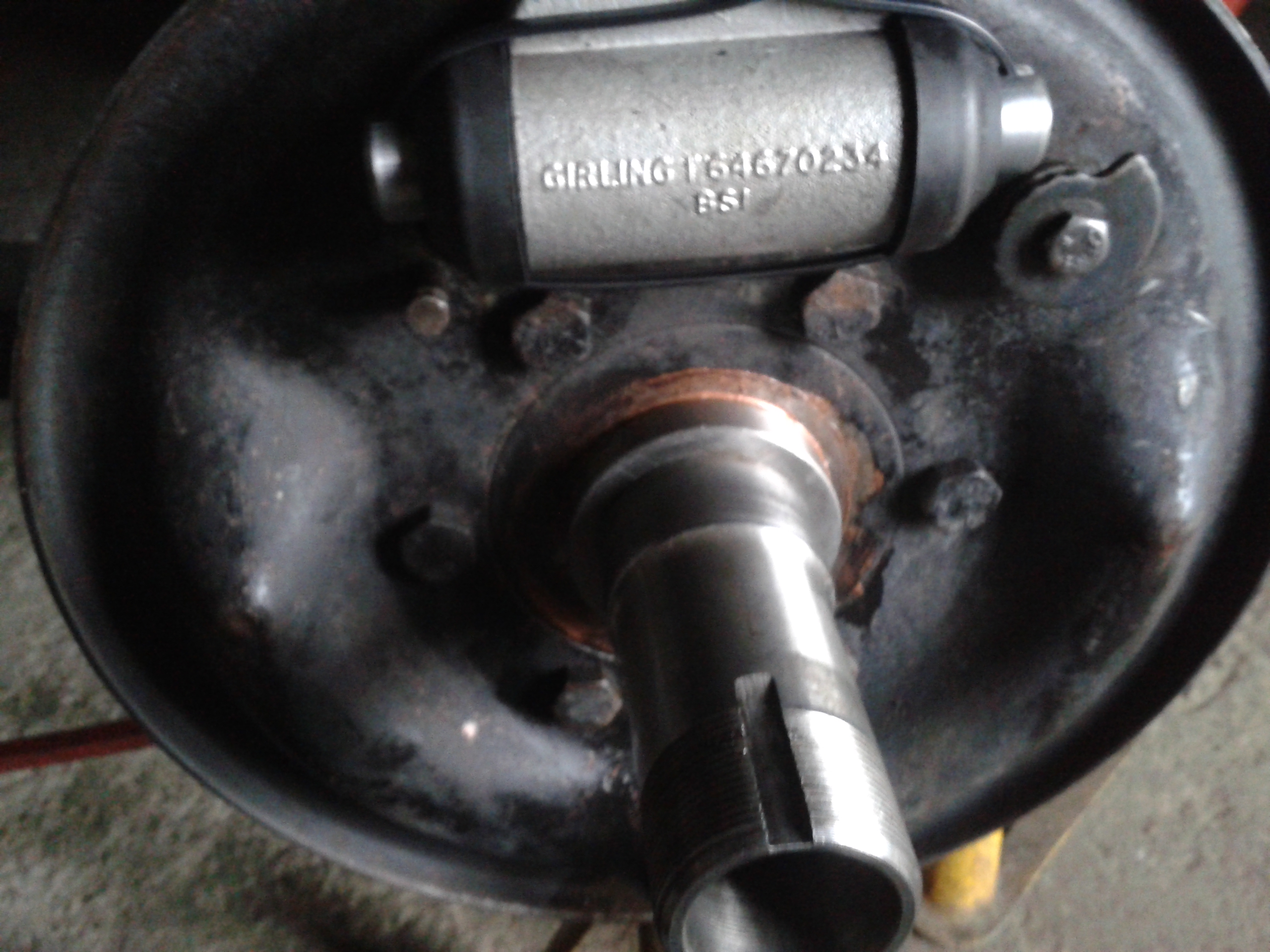

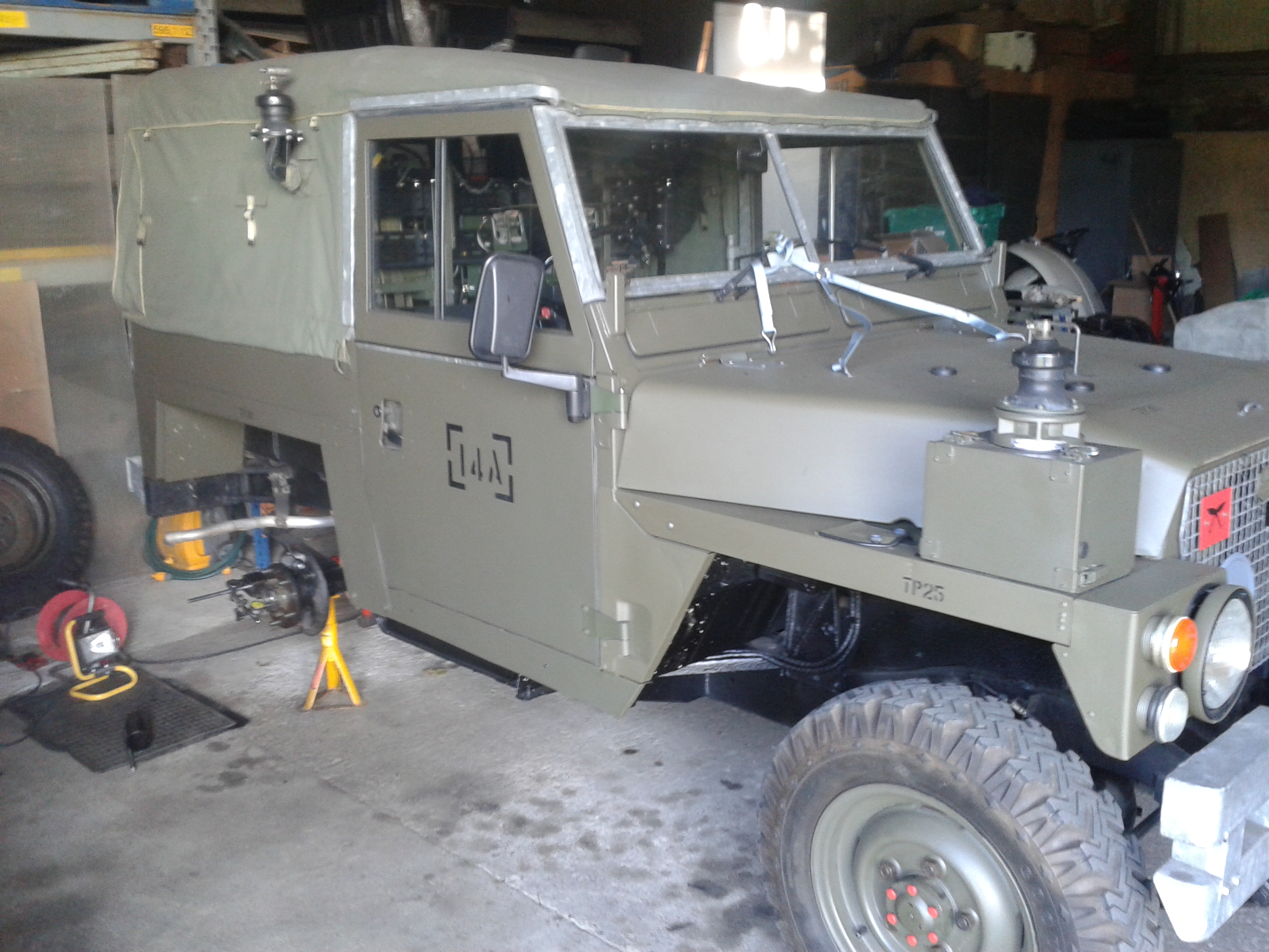

Re: 19HF27
Post by Bob Fell » Mon Oct 28, 2019 7:57 pm

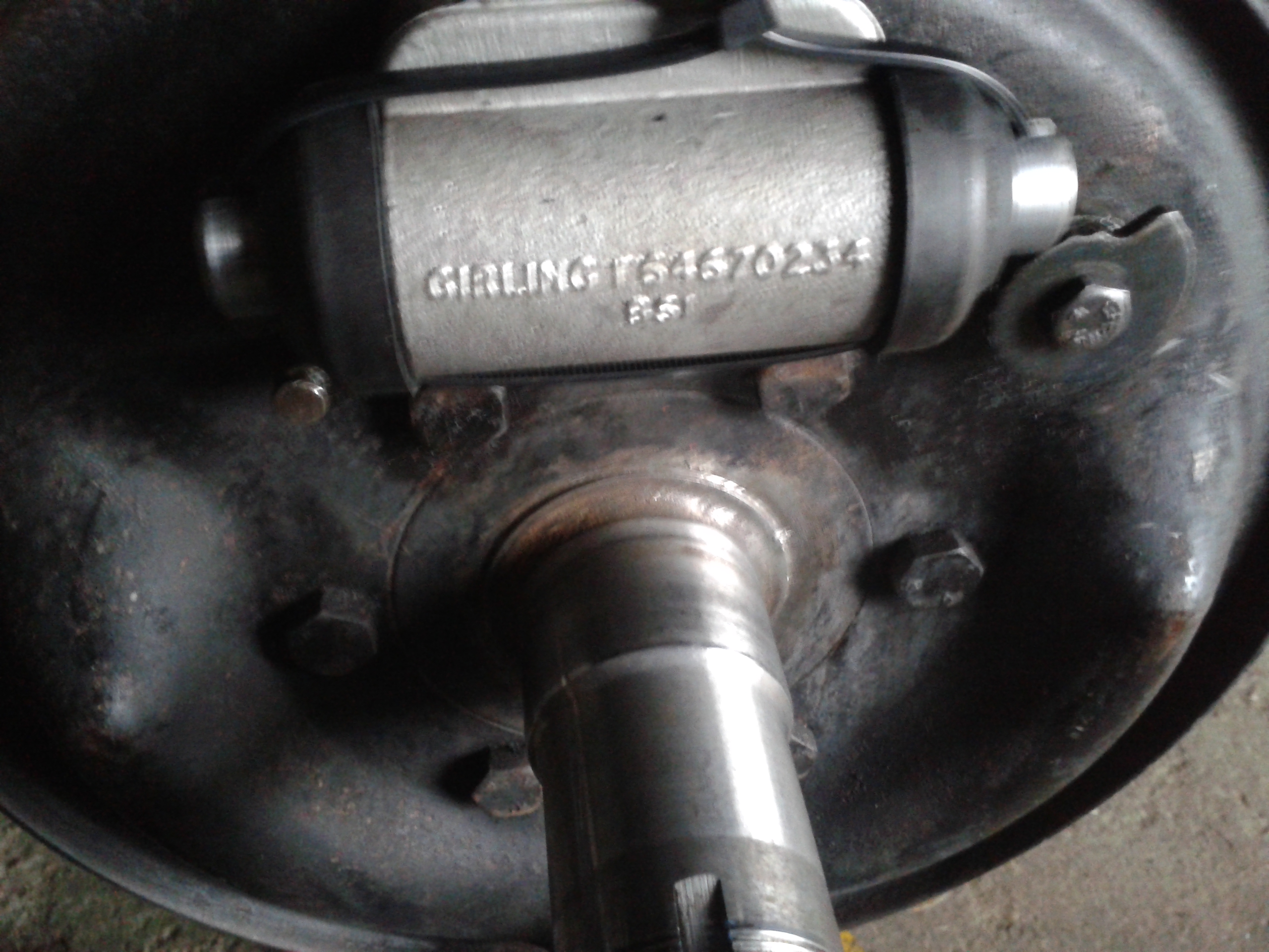

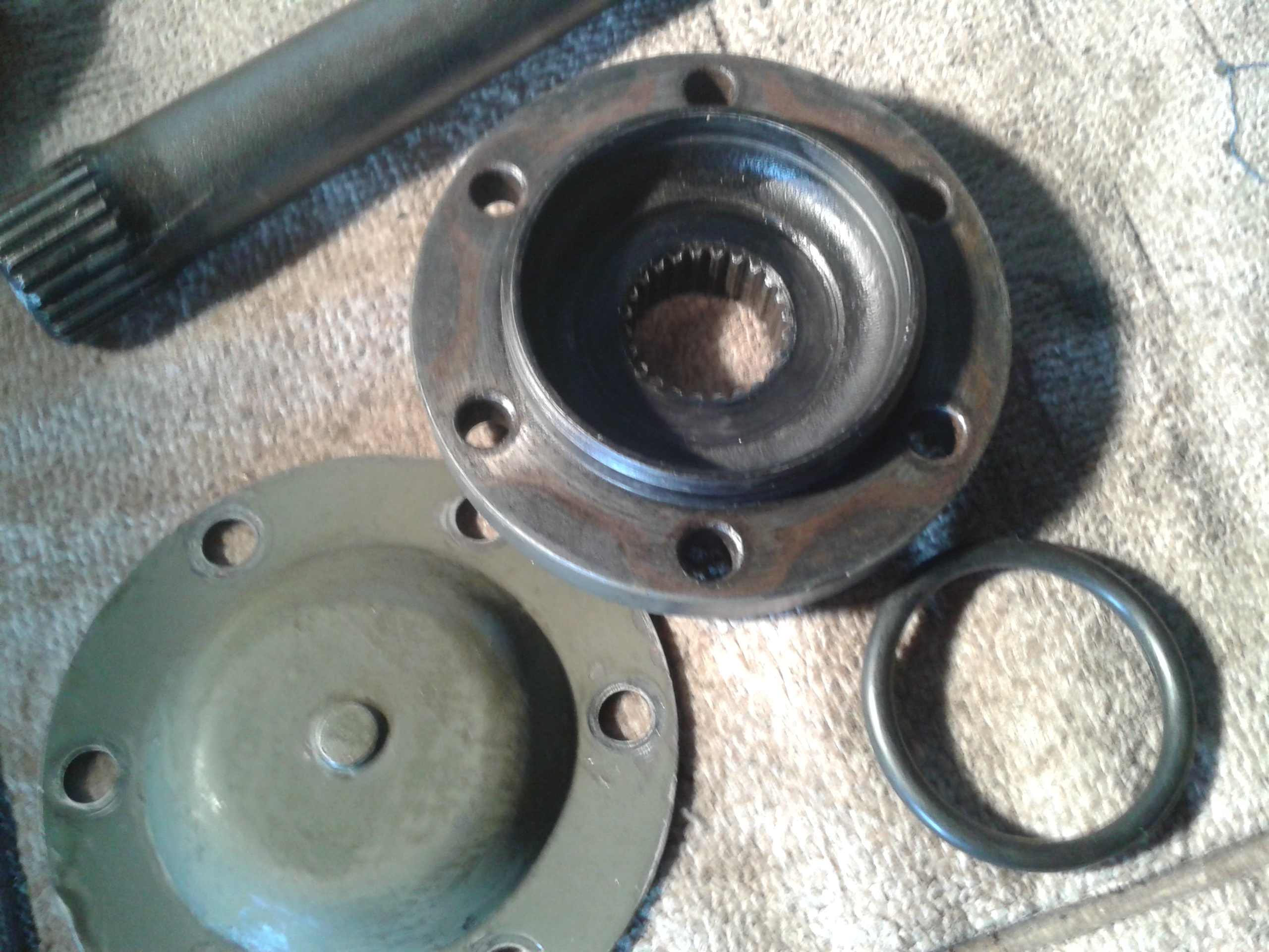

Here's from yesterday;
Thought it looked a bit sad sat on the axle stands, but no gain without pain..
Drive end cleaned up and half shaft inspected, all ok..

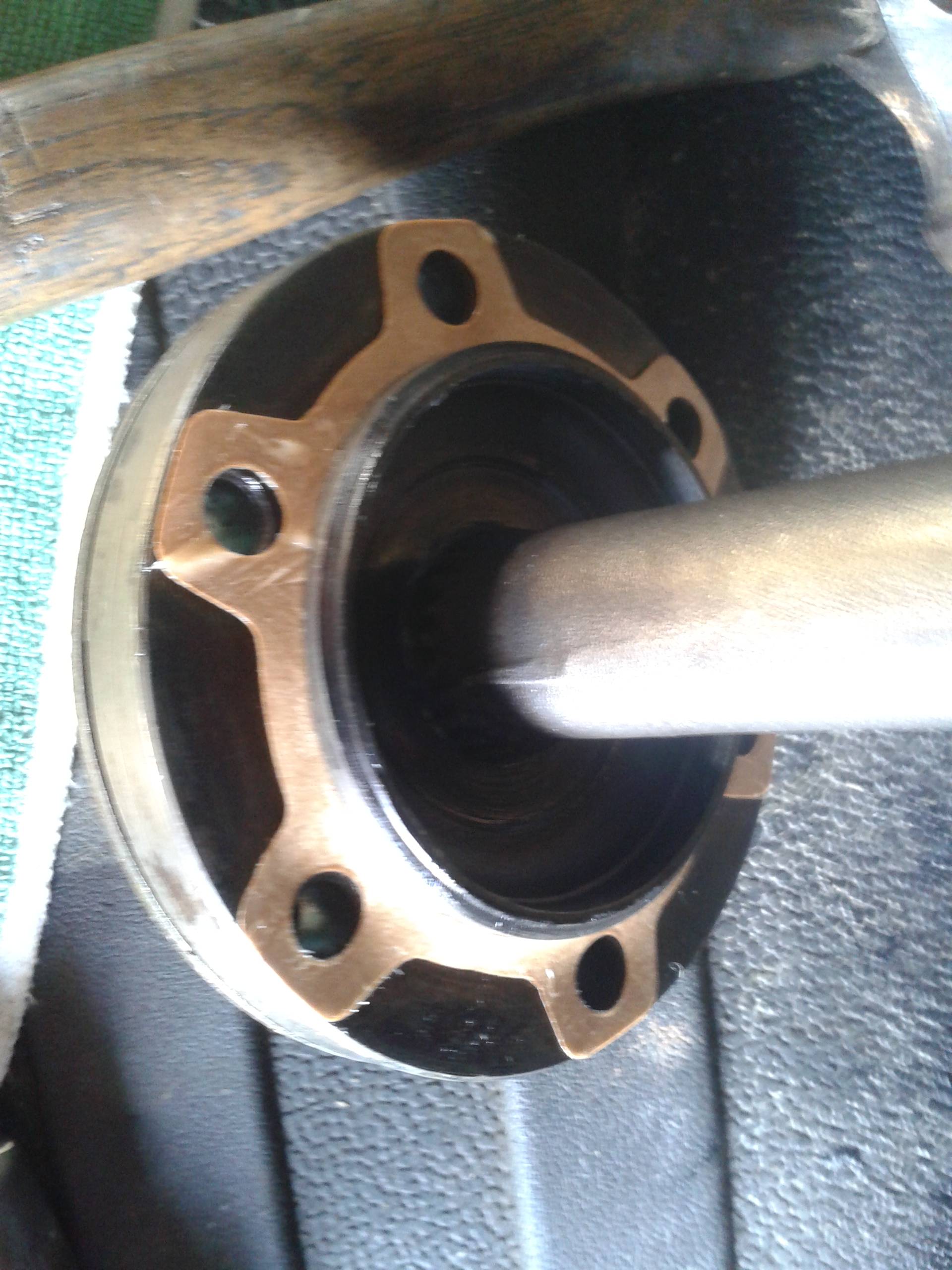

New 'O' ring fitted..
New drive end gasket..

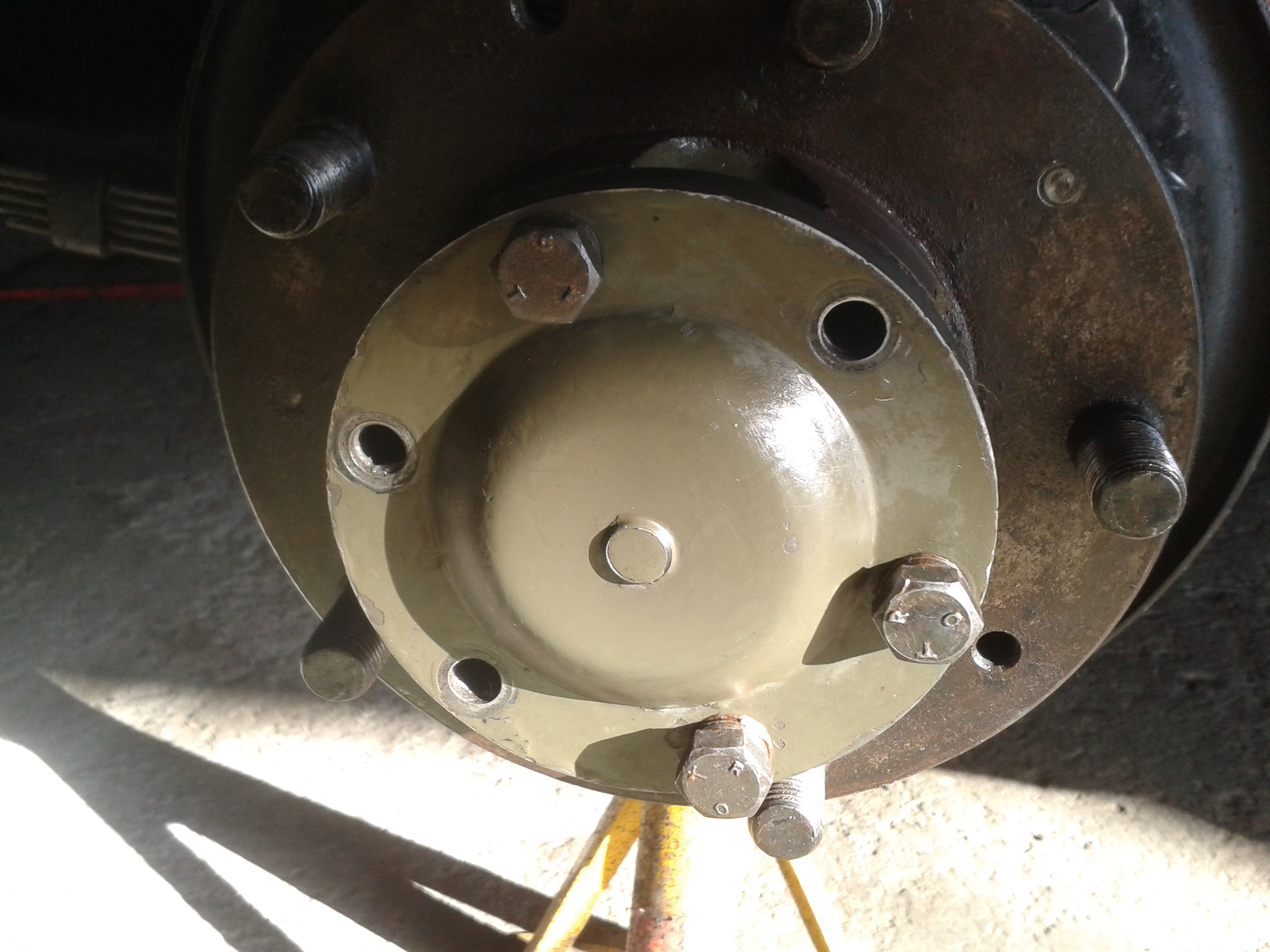

Re: 19HF27
Post by Bob Fell » Mon Oct 28, 2019 8:20 pm

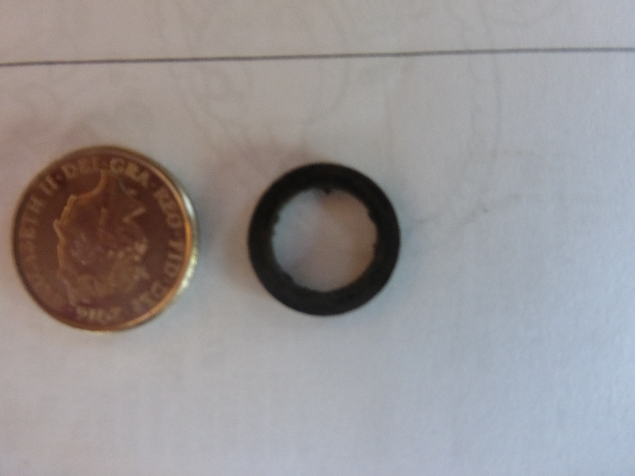

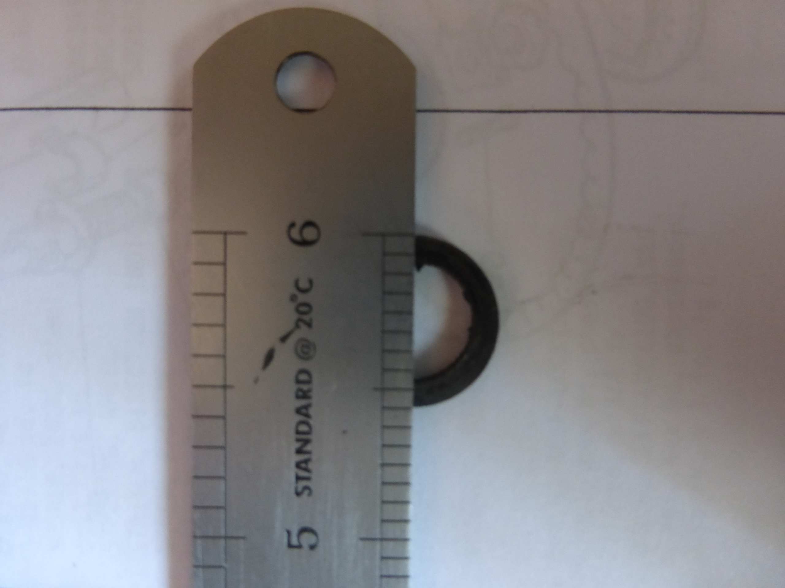

Now comes a leading question because I cannot find the answer and unfortunately the pic does not really show what follows, excepting for the lower bolt where you can just see it.
Here is the drive fitted, I'm using the original drive end bolts and spring washes as I believe in keeping original as is..
But, on my vehicle there is a thin plain washer fitted up against the end cap with the spring sandwiched between it and the drive bolt head. Here it is below, I cannot find reference to it anywhere, is it a PO thing or original spec, pre 1980? They have definitely been there a long while and some are missing hence the question..
ID is 3/8" obviously.
OD is 9/16"
Thickness is about 1/16"
Anyone has the same....... :?: :?:
The usual suspects have thrown up a blank and the parts book does not list it.
Re: 19HF27
Post by removeduser185 » Mon Oct 28, 2019 8:55 pm
I didn't have them, but, there is a possibility I was thinking of. One of the problems with the driving members is that they leak. And, of course, the threaded holes for the retaining bolts are blind. Over time they get filled with hardened grease. It could be that a previous user put washers under the bolts to increase the pressure on the gasket as the bolts weren't going fully home, so causing a bit of a leak. A couple of my bolts were actually shortened - perhaps an alternative "solution" to make the driving member oil-proof against the washer. I took some pains to completely clean out my holes which were indeed full of hardened grease in the bottoms.
Just an idea. By the way, thanks for the pictures of your maintenance - really interesting.
