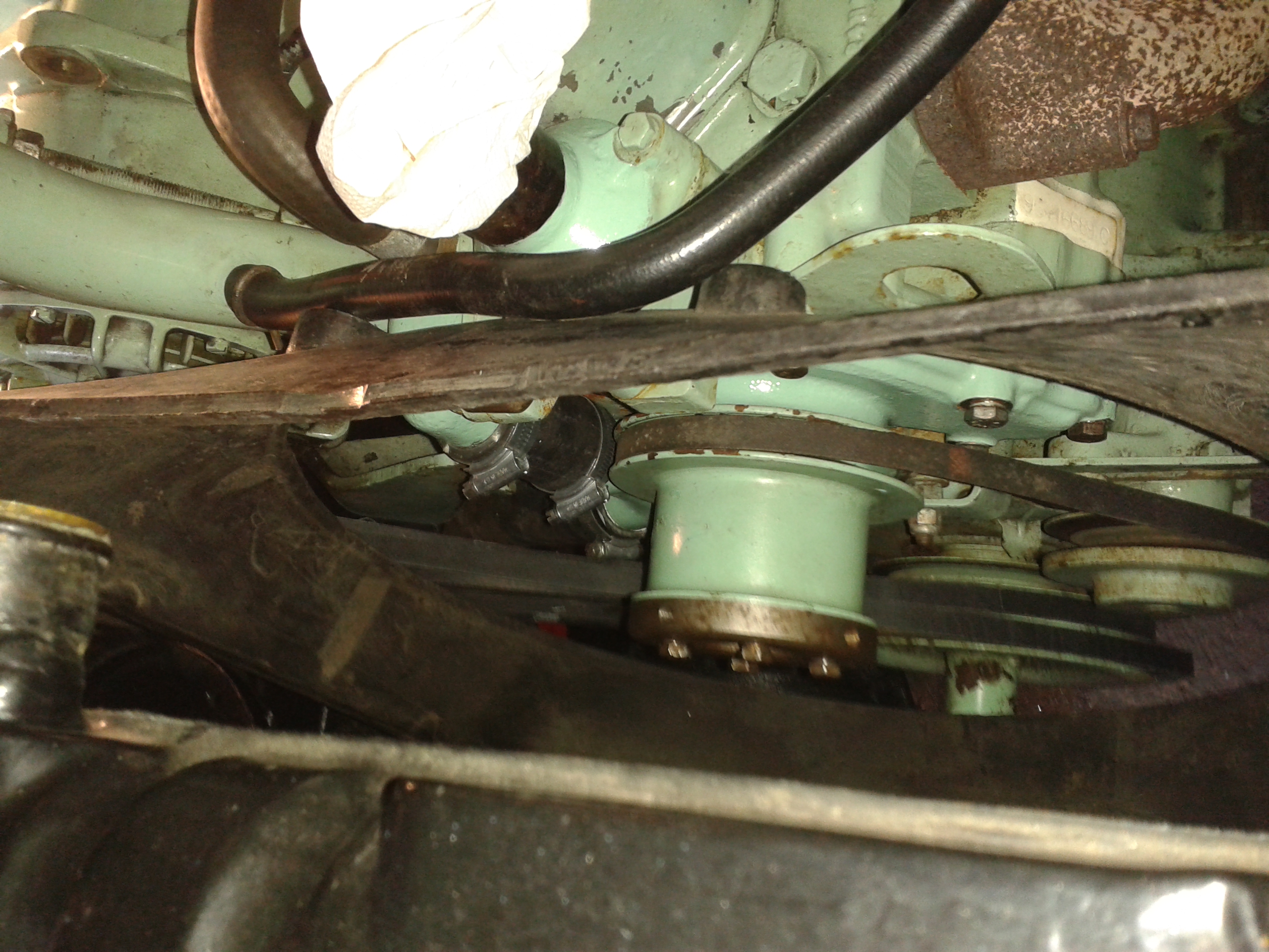

Update and advice on fitting hoses.
Been doing all the prep work for fitting the new water pump, all fasteners cleaned up or replaced and heavily copper greased, the pump has had 3 coats of paint over the week.
Thinking about the new hoses, they are tight obviously so to fit them to the ports I'm planning to soften them with hot water but how about a bit of silicone grease to help ease them on ??
I'm planning on fitting the new pump with the hoses attached as that's how I took the old one off, it should certainly prevent an awful lot of pain trying to fit the bypass hose later having had the experience of that with my 2A years ago.
Here's a pic of todays limited progress, its been too cold to do anything else - must get a space heater.

Post by Bob Fell » Sun Mar 07, 2021 1:55 pm
Hiya Neil :D
The hot water did the trick, the bypass hose slipped on a treat.
Anyway, had a good couple of hours in the sun, the end result being one new pump fitted which gives me plenty of time to put everything else back tomorrow.

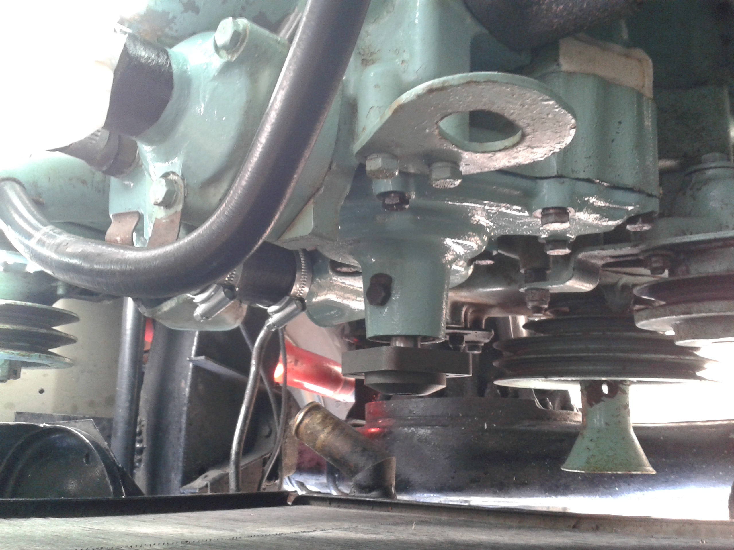

Hi Loulou,
In answer to your question, yes.
The radiator stays in, slacken all the belts off, push the cowl back onto the engine and remove the fan then remove the cowl and carry on with the rest. Assembly is reverse, fit the belts loose the the cowl pushed back as before, fit the fan - must be careful here to get the fixing holes aligned, it can be a bit of a pain. See pics on assembling;
Again, thank you for all your advice.
