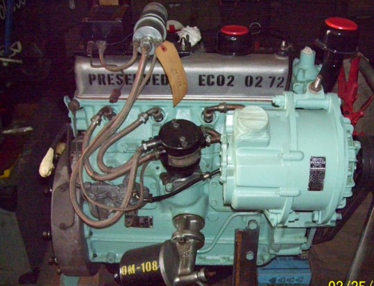

The valve seats, valve guides, and valves were supplied and installed by a resurfacing shop, and they now only use products suitable for unleaded gasoline. The shop also resurfaced the cylinder liners, and I did everything else myself: pistons, main bearings, connecting rod bearings, and valve drive shaft. Now I practically have a new engine.
I'm attaching a photo.
Thank you very much.
Best regards,
Mauro

Re: engine serial number
Ooh. Shiny! We like shiny we do. Shiny, and cake. Mustn't forget the cake.
That's a nice looking engine.
