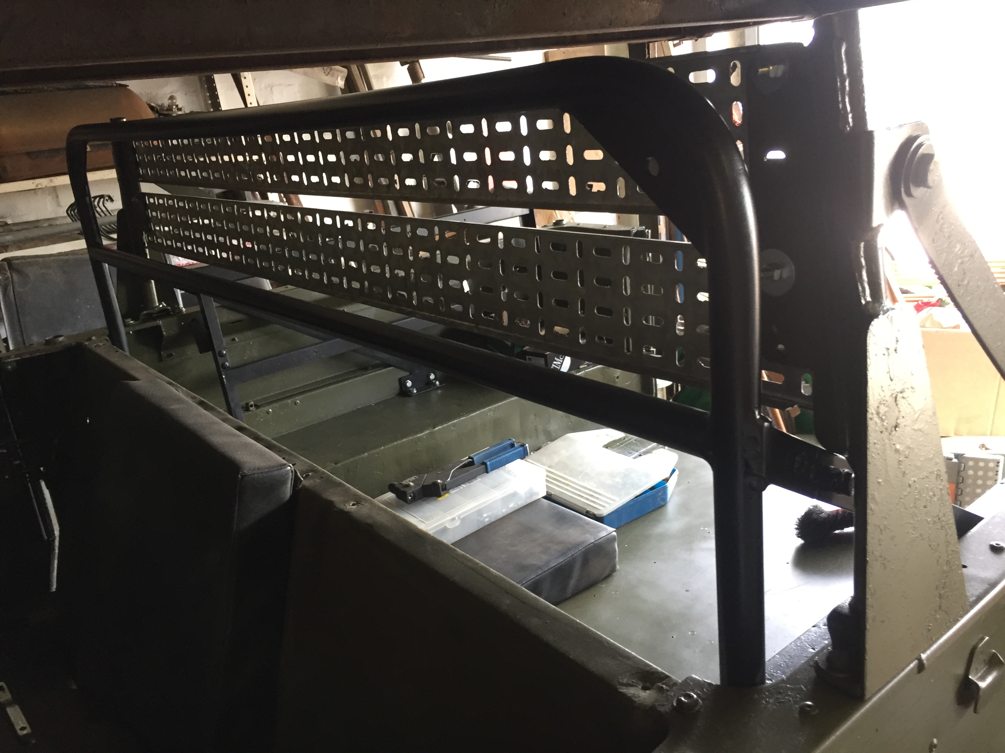

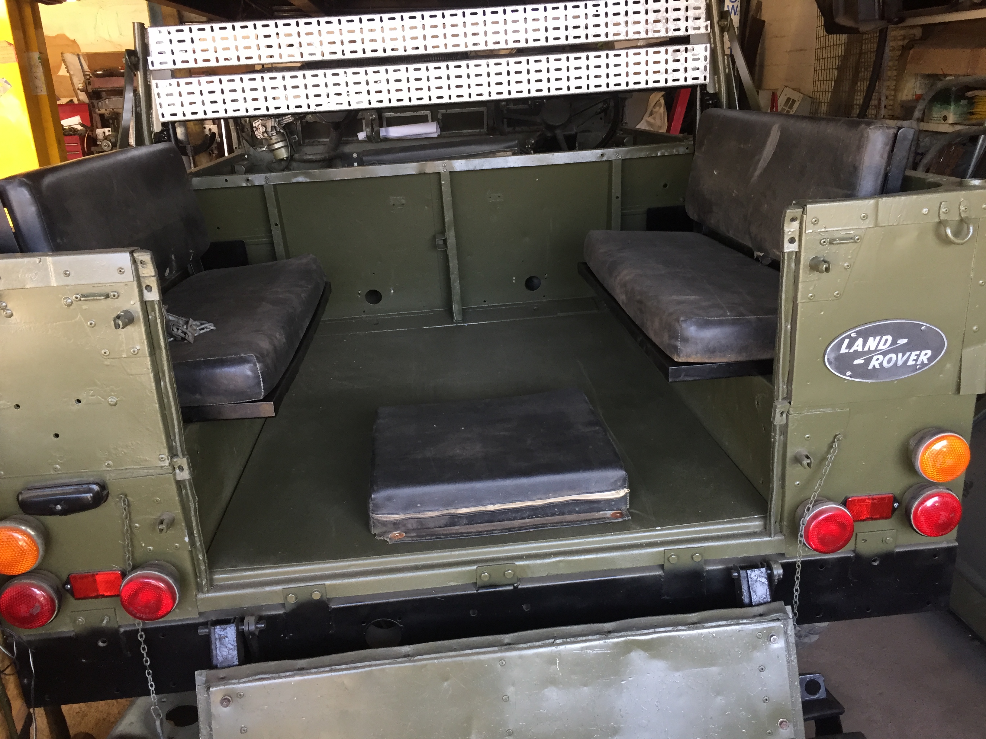

I am at the stage to start sorting the back out.
I have the following, and am making the following assumptions / desisions based on previous answers.
rear tub.jpg (2.06 MiB) Viewed 2948 times
rear tub 2.jpg (1.66 MiB) Viewed 2948 times
Tuam box and mount plate etc on drivers side wing and clansman frame mounted to drivers side of dexion. - Does it just bolt through? is there a correct dimensional layout for this kit?

I know I have the incorrect Dexion, I will sort this when I can find some of the good stuff, but I am mistified about the location of the cable runs? should I also add one of those Tuamm Wire boxes to the top of the wing too?? what other electrical units should I have fitted? (Ive seen some pictures, but am nieve to the part codes needed.)

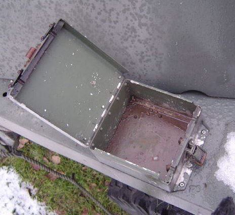

this is the wire box im talking about..
tuaam wire box.JPG (44.89 KiB) Viewed 2945 times
Im guessing there should be a hole in the bottom of the box for cable entry / exit?

There are two types of cable storage wing boxes and later ones had a flap cut into the wing with a under mounted cable storage box.
There are also two types of cable to connect them a spiral plastic covered one and a metal braided one I think both need to be used with the correct storage boxes and route differently to connect to them.
