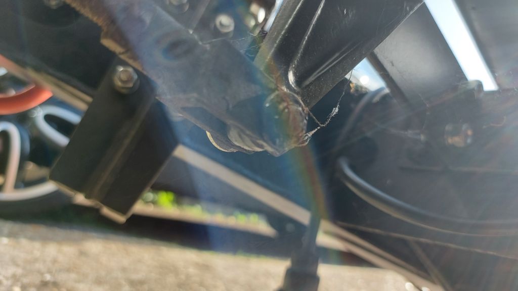

My narrow track Sankey has been stored for the last couple of years at a long suffering friend's. I need to move it, but while the brakes are free and it moves ok, I am not confident that the brakes will operate properly and indeed may not seize at an inoportune moment.
It's towed with the usual nato hitch etc ie everything standard, and the lights will all be working etc, it's the brakes that are the concern. One thought is to put the collar used for reversing in place for the journey, ie effectively leaving the trailer unbraked, and relying on the lwt brakes which are in good working order. The sankey will be unladen and hence the weight of the trailer vs lwt etc means that it will be below the limits for unbraked vs braked trailers, ie if it didn't have brakes then ok. It needs to be safe and legal so while it shouldn't make a difference as to length or journey and type of roads, it's legal and ok or its not, but the journey will be less than 10 miles, not on the motorway, unless the towing rules are different on motorways that I am not aware of, which would be worth knowing but not appicable in this instance.
My thinking is that deliberately disabling the brakes and towing as an unbraked trailer that is within the limits is far safer and more sensible than a trailer where the brakes condition is uncertain where uneven braking etc would be a risk and therefore inappropriate and if not illegal then it should be.

It is illegal to use an unbraked Sankey on the road, if you disable the brakes with the reversing mechanism and get stopped (very unlikely in London) provided you don't say you meant to disable the brakes and insist it was a simple mistake then that's it a simple mistake.

Pull the pin out of the brake linkage arm just below the handbrake,cable tie it up or it will fall to the floor and bend!This wouldn't be an obvious thing for the plod to look at but the reverse saddle is.Wouldn't harm having the tow pintle moving ever if it been stood so long.

cheers Rod, actually that sounds like a plan for at least getting the pintle moving ok with a bit of back and forth on the driveway and seeing how it looks, ISTR there is grease nipple as well to help, and then see where we are, its been so long I can barely remember what the underside looks like and how the brakes actually work, but at least I have found the old manual.......in a box of landy stuff (including the K&N air filter that I really must get round to fitting :roll:), still finding stuff in boxes from when we moved from Hampshire and emptied the garage and that was nearly 7 years ago
