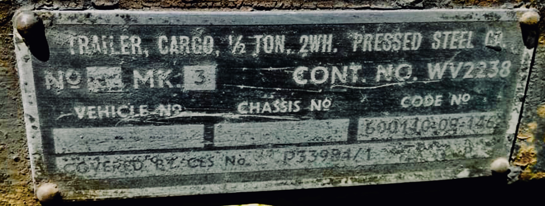

The ID plate is as below.

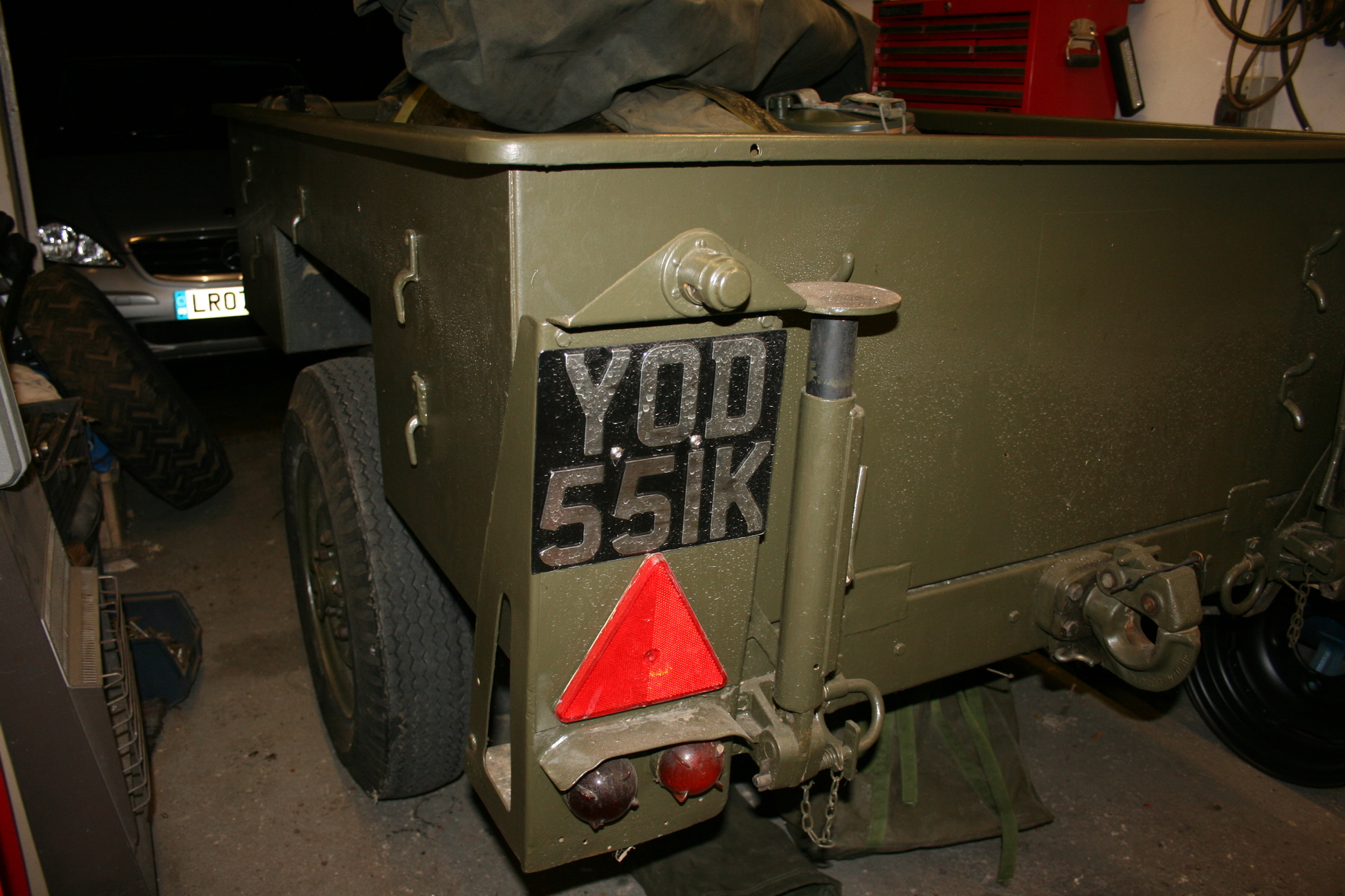

Hi I would say well worth the money a lot of sankeys for sale have very rotten tubs one near me that was complete with lighting and legs went for £300 and you could put your hand through the tub front and sides.
If you have room to store it go for it for that money worth it just for the spares.
My Sankey has a remade by past owner tub Not for the purist but from 10 feet is a great copy there are some pics some where on the forum I posted .
Very simply construction to re fabricate,if you can use a angle grinder and are able to plug weld you could make one not a problem.
All down to if you want the challenge and have the time.

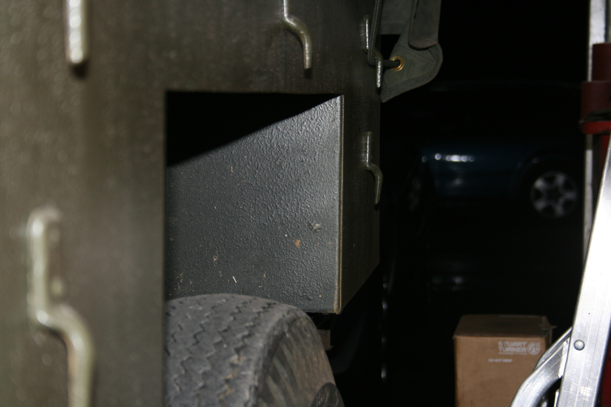

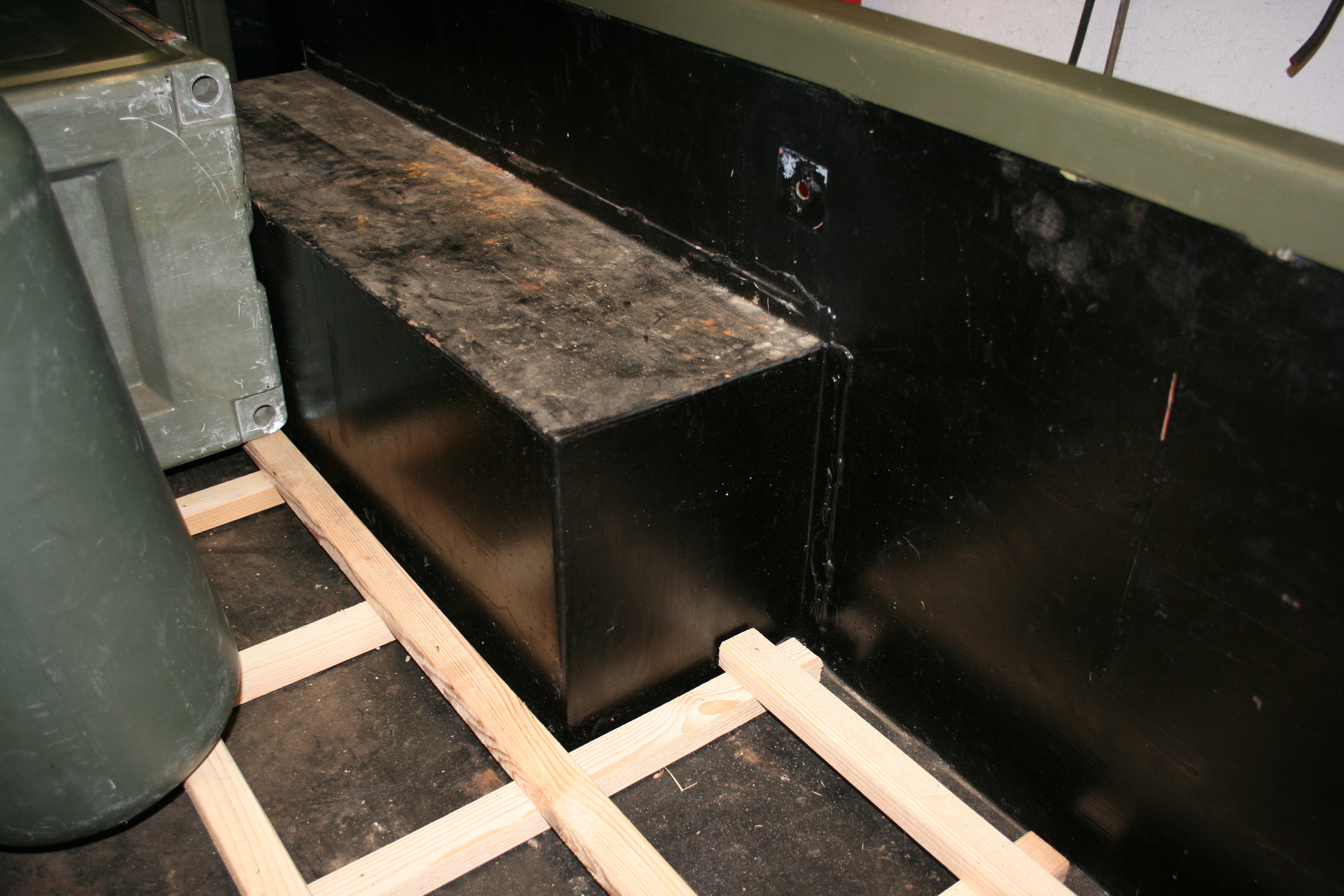

Here,s a couple of pics of my remade tub .
- tub2.jpg (1.91 MiB) Viewed 6719 times
- tub1.jpg (1.88 MiB) Viewed 6719 times
- sankey tub.jpg (1.63 MiB) Viewed 6719 times

Any way to find out history from my plate info? is there a b card type document for these?
