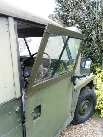

The first thing I did once the vehicle was safely at home was to swap this,
For this,
It just happened that the only glazed doortop I had was for a 90/110, a spare for my other lightweight.
As this swap was neccessary for the purpose of security and keeping the lightweight in my ownership not anyone elses I didn't see it as breaking the no working on it until I retire rule.

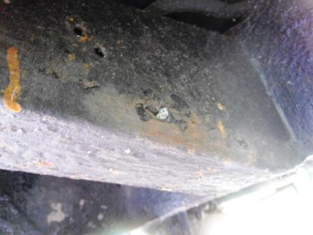

I think a new rear crossmember was the first part I ordered for the vehicle, the inside looks as bad as the outside.

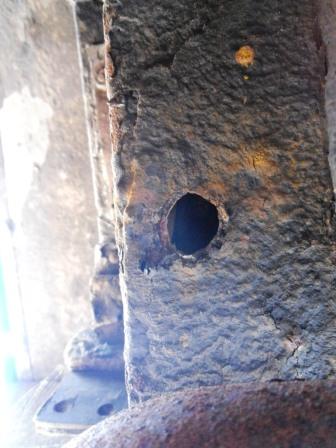

Post by AR4412 » Thu Aug 08, 2013 7:24 pm

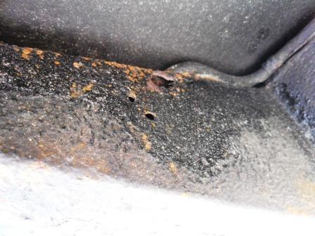

The next two shots are of the main chassis rails between the rear bumpstops and the rear crossmember. A couple of finger sized holes appeared when tapping with a hammer.
What cannot be shown as it was a bit tricky trying to take the pictures are the holes to the rear and inside of the rear spring hangers.

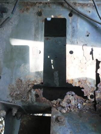

A couple of holes were found hiding in the bulkhead outrigger as well.
Along with the holes you can see the front and rear faces of the outriggers deformed when pressed with my thumb but I'm hoping to be able to cut out the rot and weld in some new steel as opposed to having to fit new outriggers.
Apart from these areas the chassis seems quite sound. I'll know for sure once the body is off so I can check the topside and can give it all a grit blast.

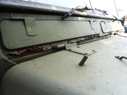

Enough of the underside, what about the bodywork I hear someone shout from the back.
As you can imagine a lifetime in the hands of the Paras and a couple of years with the RLC, who in my humble opinion having served with both, are even worse at equipment care and fault reporting there are a few dents to be found on the vehicle. I won't show pics of these here and now but I will show them and their repair as and when I tackle them. For now I'll just show the usual suspects found on a lightweight.
Starting with the vent panel.
Yep, scrap. :(

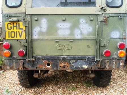

As some of you may have seen elsewhere I started by removing the pioneer tool brackets from the tailgate, these were all bent and need replacing. I have the brackets but do need to get hold of the straps. I've also removed the bumperettes, NATO hook, lash down plates and the trailer electrical socket. This will need to be replaced as it's sat there merrily corroding away since the day it was built and where it sits in the crossmember resembles a clump of damp talcum powder with wires sticking out.
The rear end now looks like this.
So far all I have done is rub down the corrosion where the brackets sat and given it a protective coat of etch primer until I remove the tailgate to repair it and it's bent mountings. The lights will stay in place until I've workrd my way around to the back with my sanding block.
