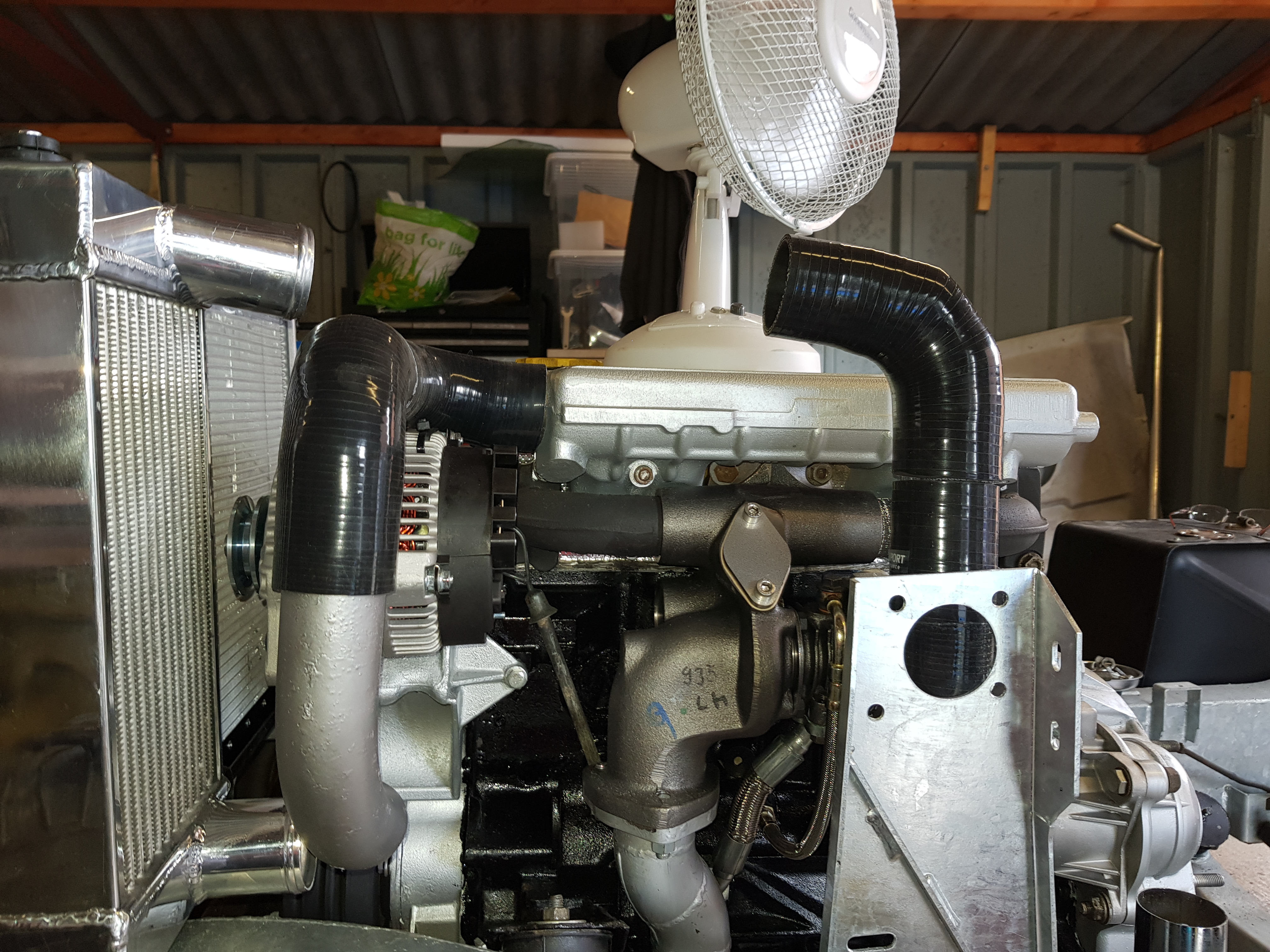

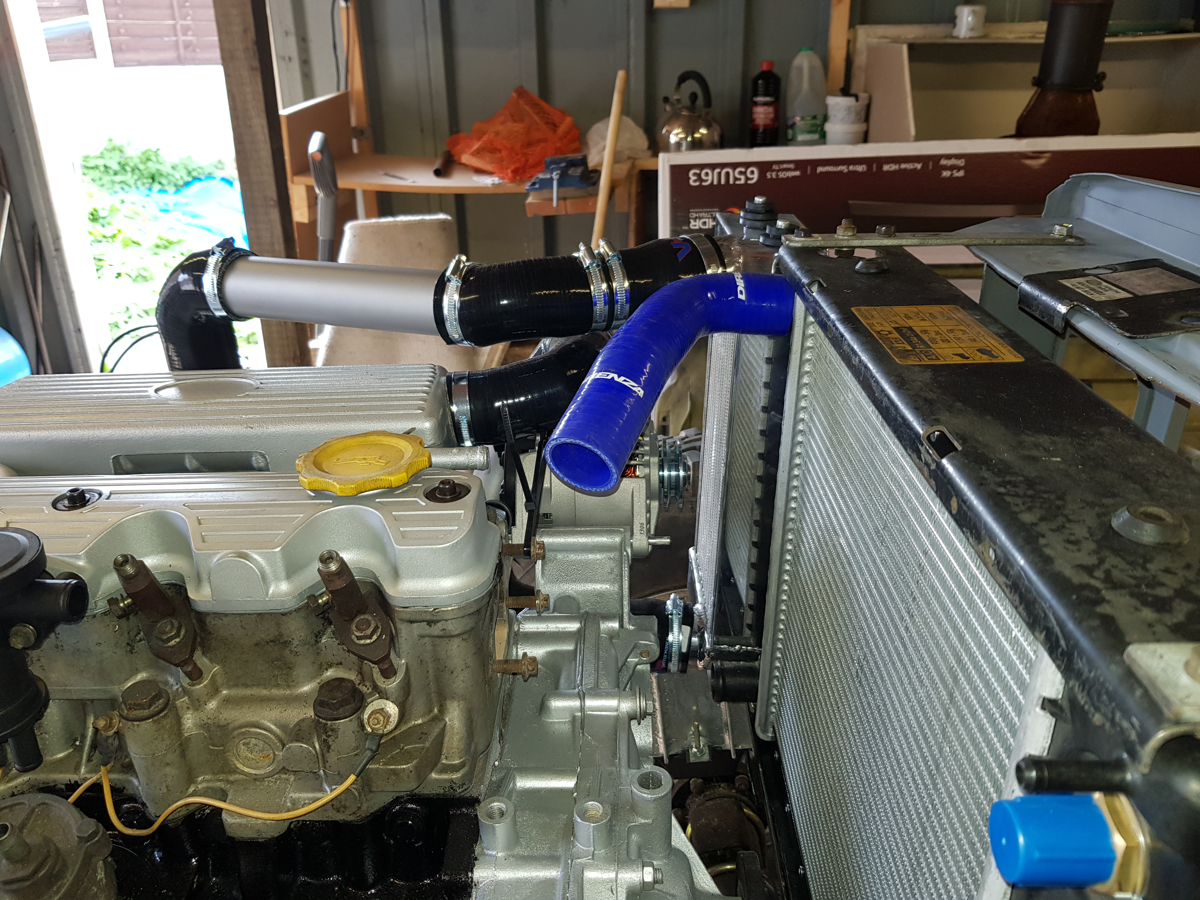

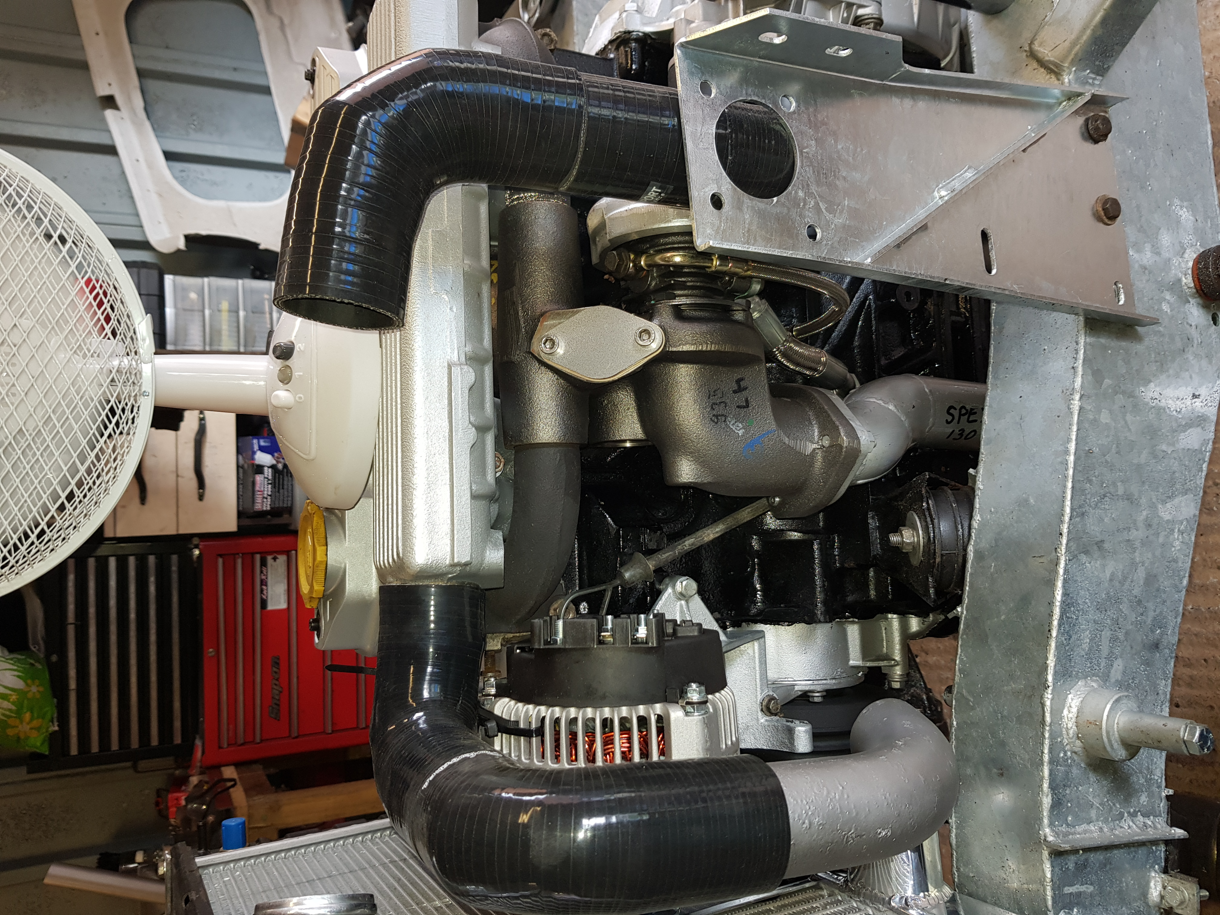

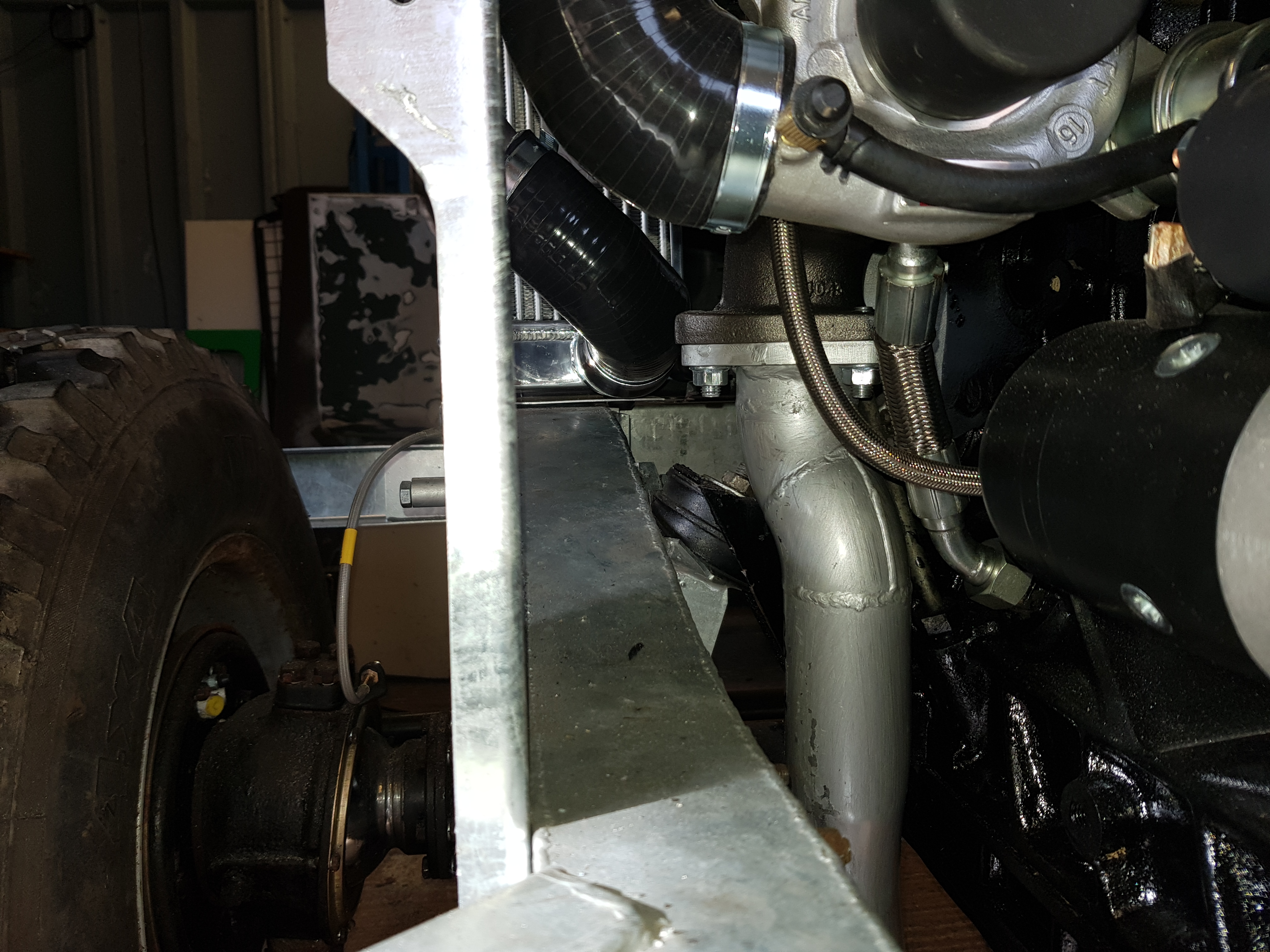

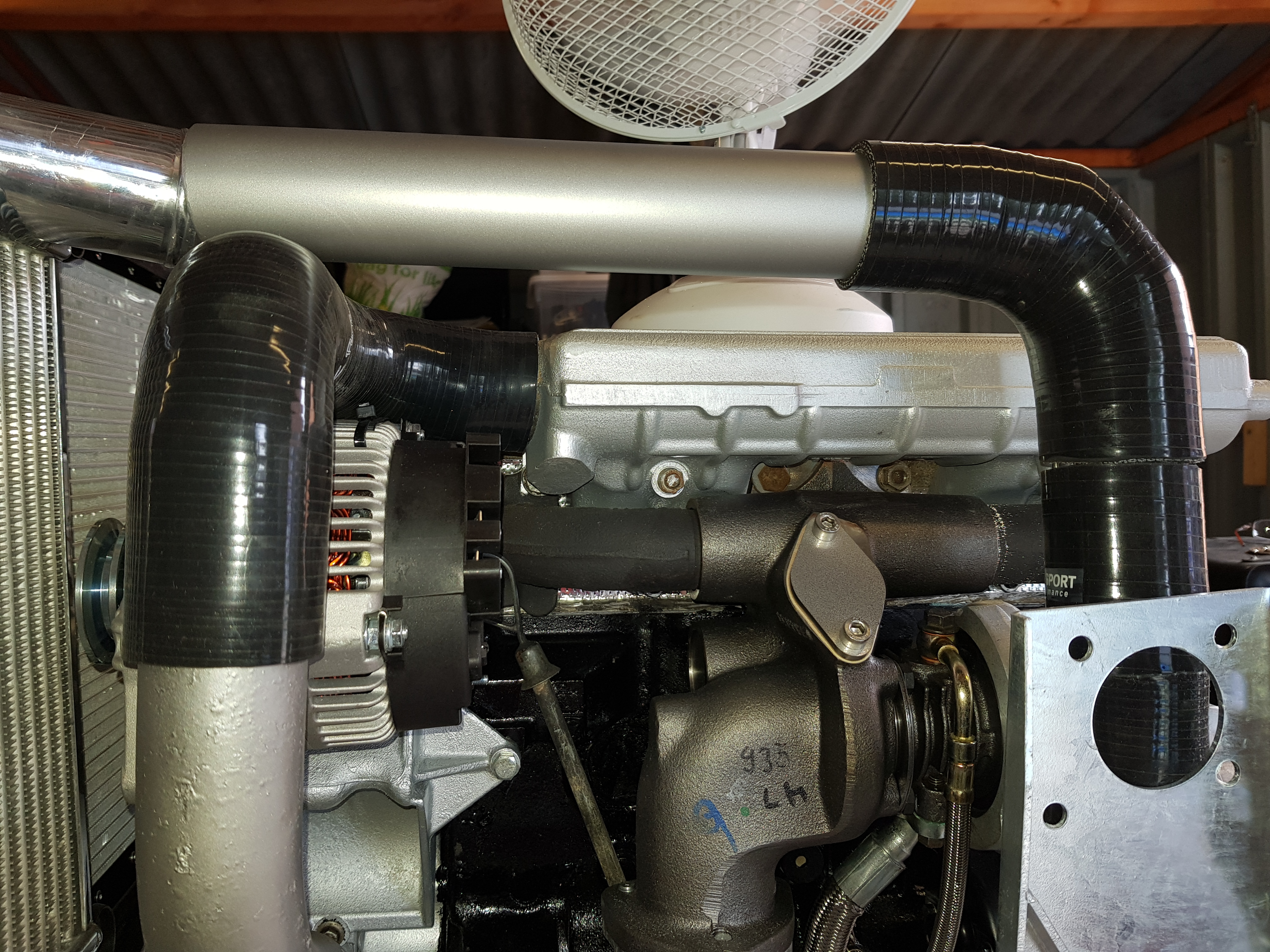

Decided to move the intercooler back a tad on Saturday and today I started to fit the intercooler pipes trying different ways and decided on fitting the intercooler upside down, course the local motorist's shop didn't have any hose clips in so I had to order some in and with the new aftermarket intercooler having 60mm inlet and outlet instead of 50mm I have had to order 2 x 60mm x 50mm reducer's which should be here in 48 hrs :)
Anyway here's the pic's

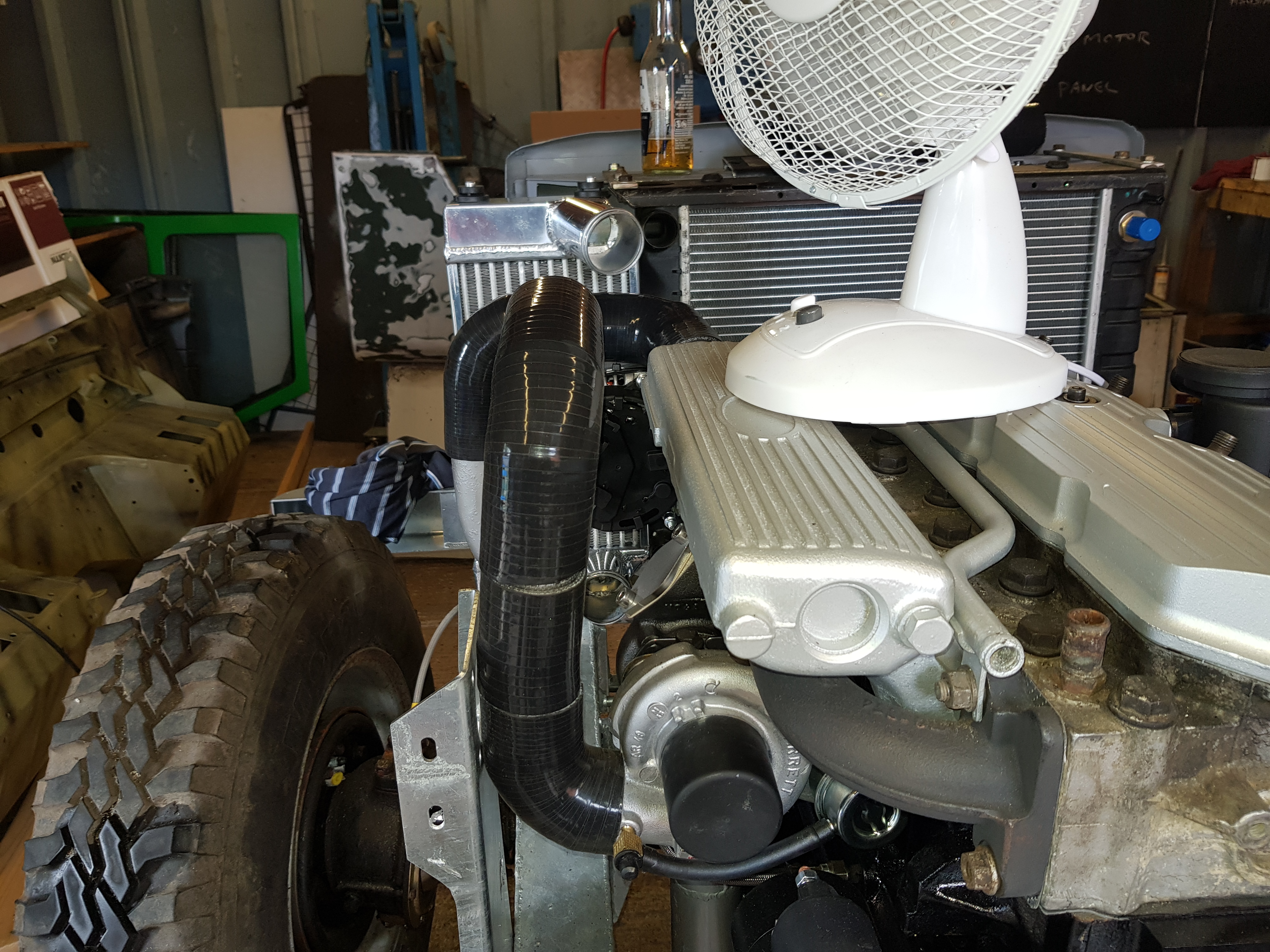

Post by Cornish Rattler » Mon Jul 23, 2018 10:40 pm
Some more

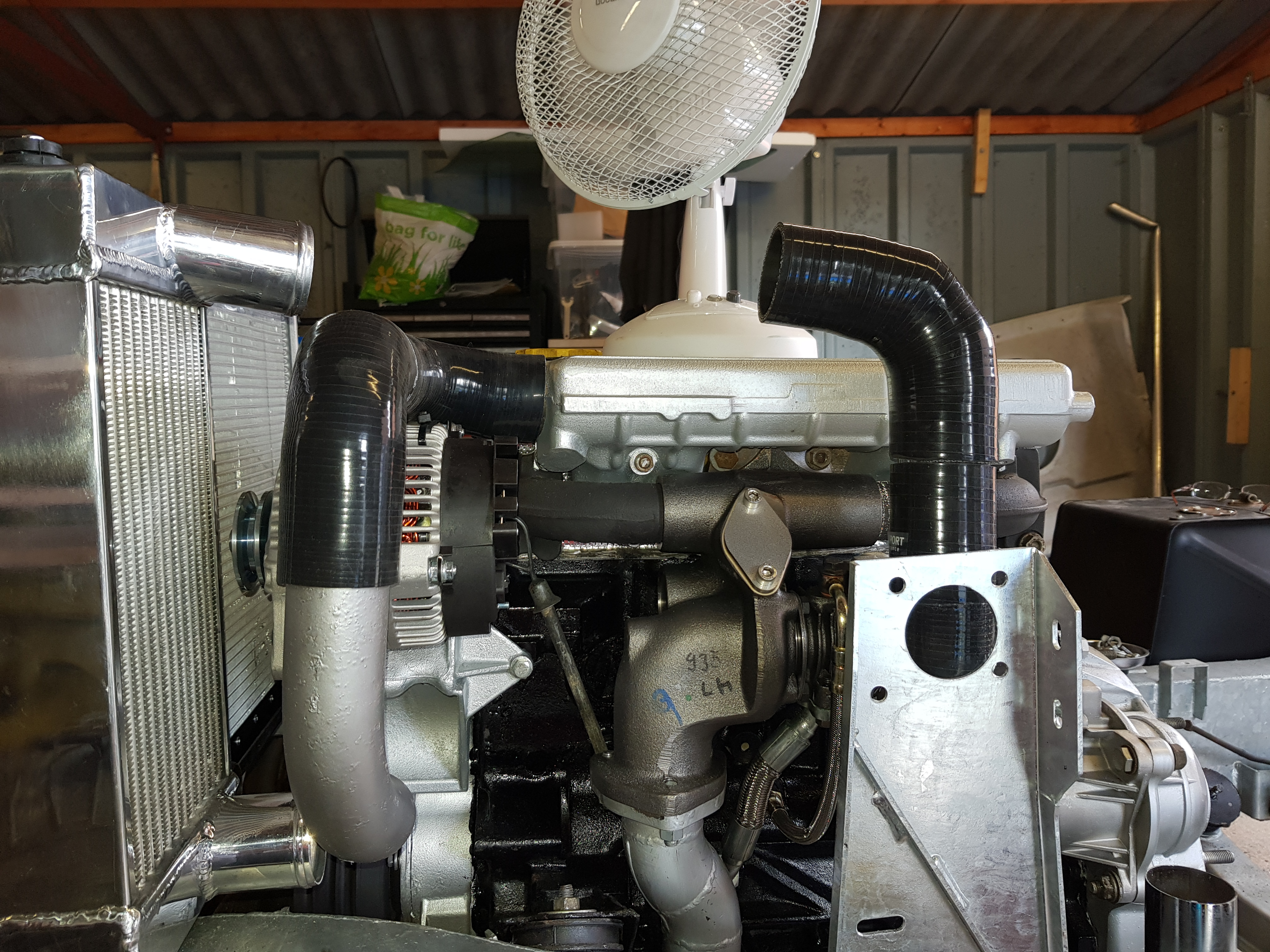

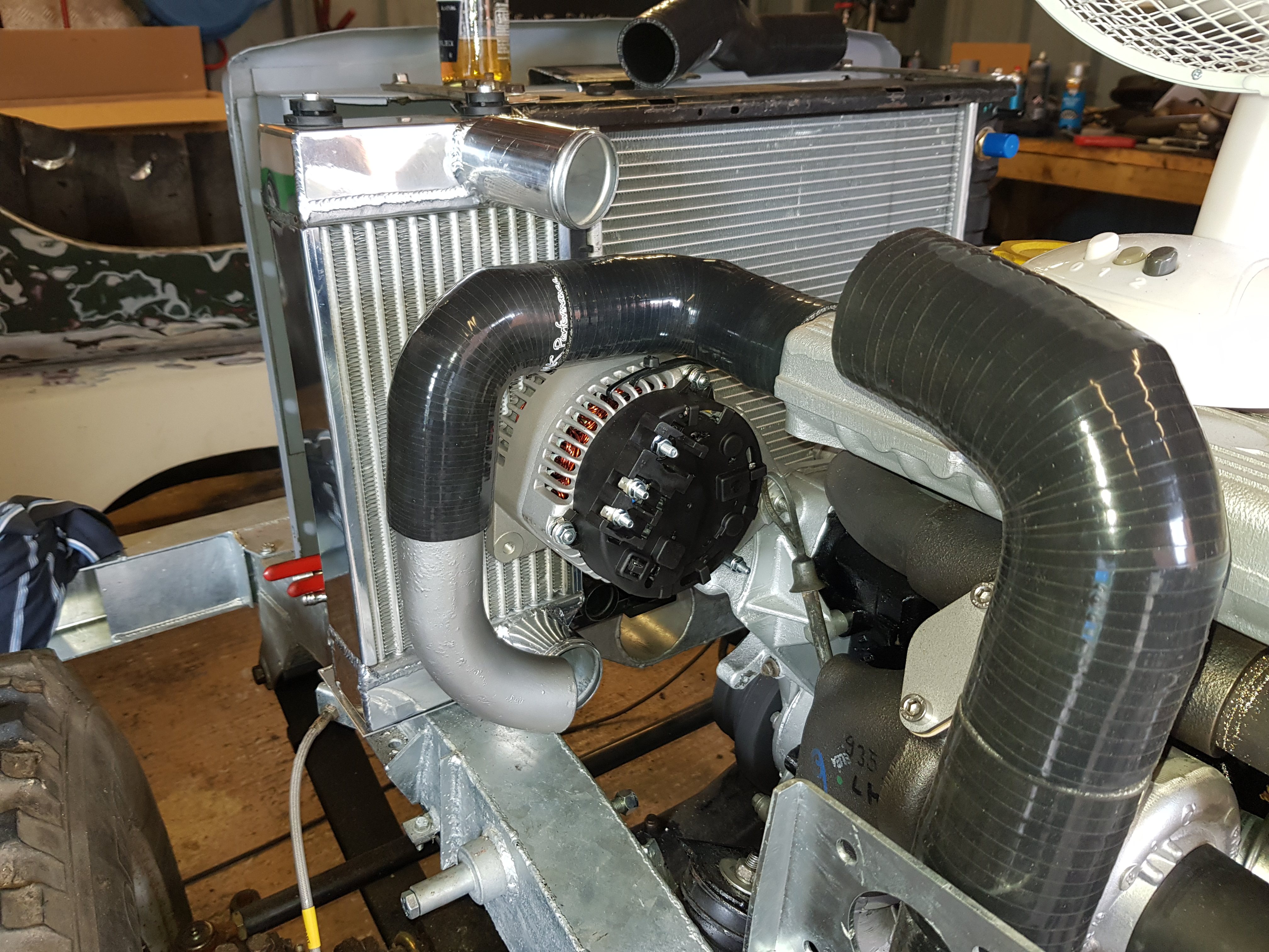

Post by Cornish Rattler » Sat Jul 28, 2018 3:58 pm
Finally finished my intercooler pipes yesterday :D

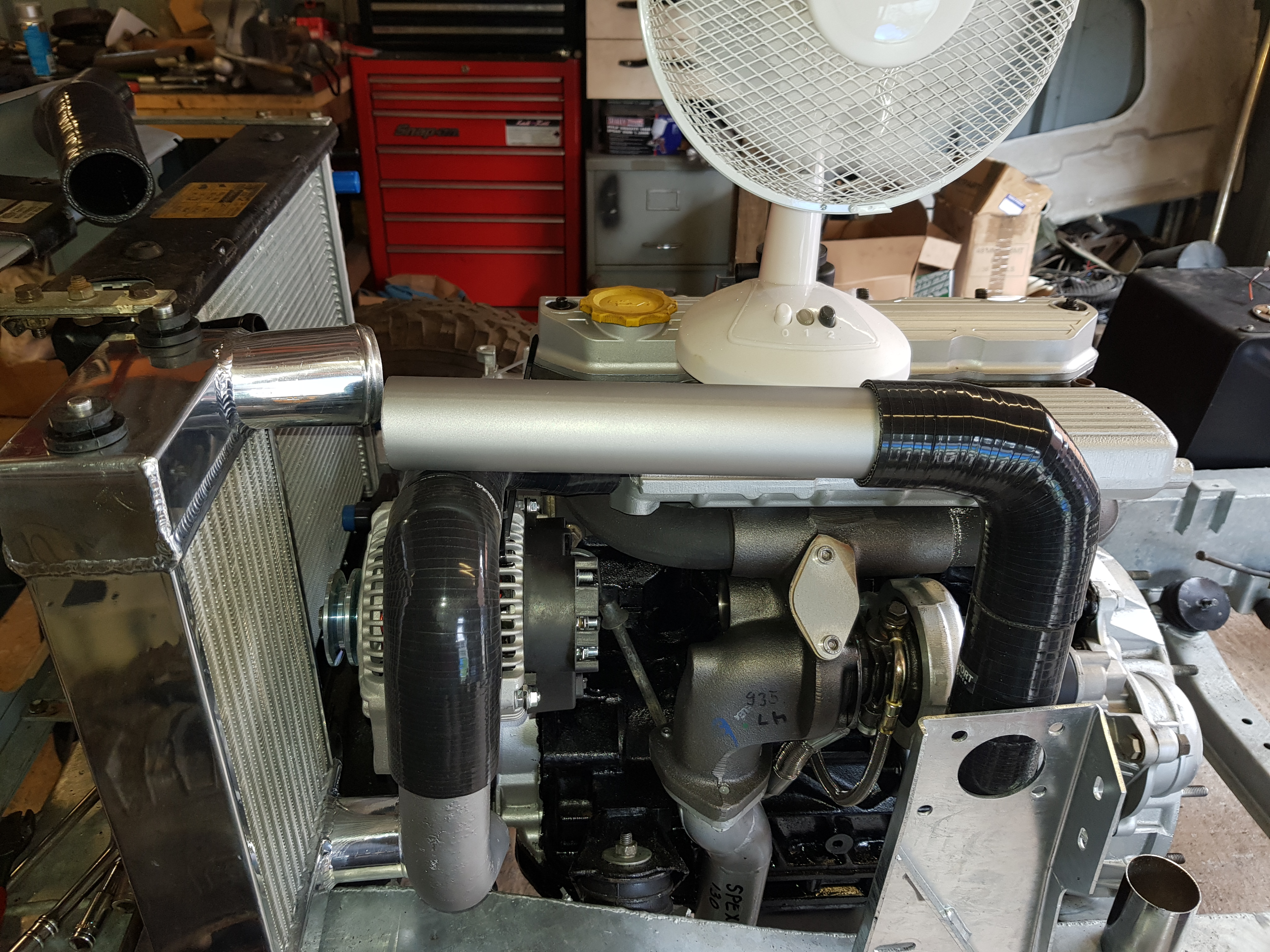

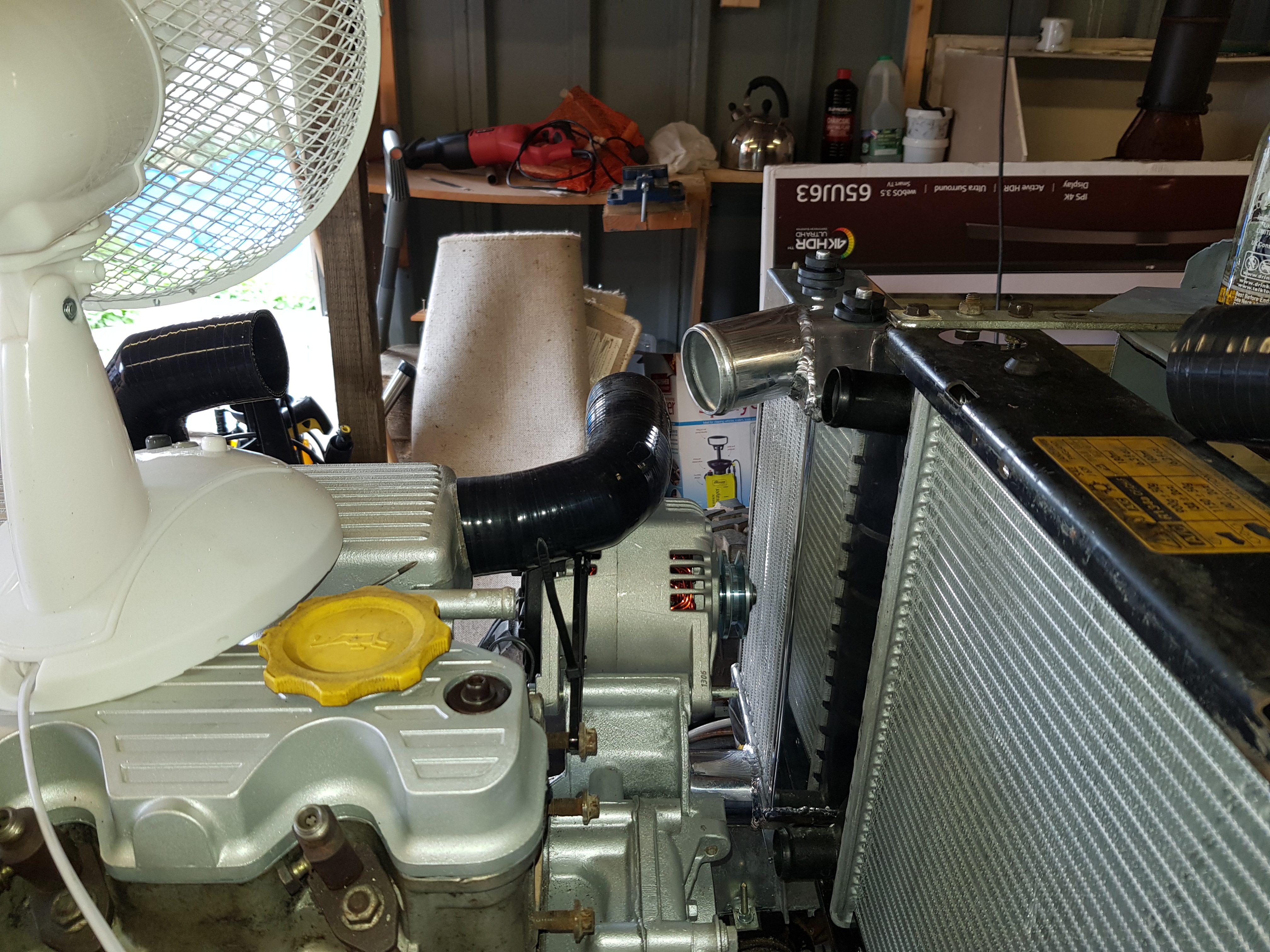

Post by Cornish Rattler » Sat Jul 28, 2018 4:01 pm
one more pic, the blue top rad hose is there to show the two top hoses fit easily as I an going to do the rad hoses in black silicon aswell :D
Post by AR4412 » Sun Jul 29, 2018 8:55 pm
Hi Graham,
That's a nice and tidy plumbing job there. 8-)
Post by Cornish Rattler » Mon Jul 30, 2018 3:03 pm
Hi Graham,
Cheer's mate, hope to have the rad hoses done in the next couple of week in black silicon then i can remove the rad and intercooler and paint all the brackets i've made to make the rad and intercooler fit and at the same time get the front panel painted ( Limestone ) as that's the colour for the landy i'm going with, then refit it all again :)

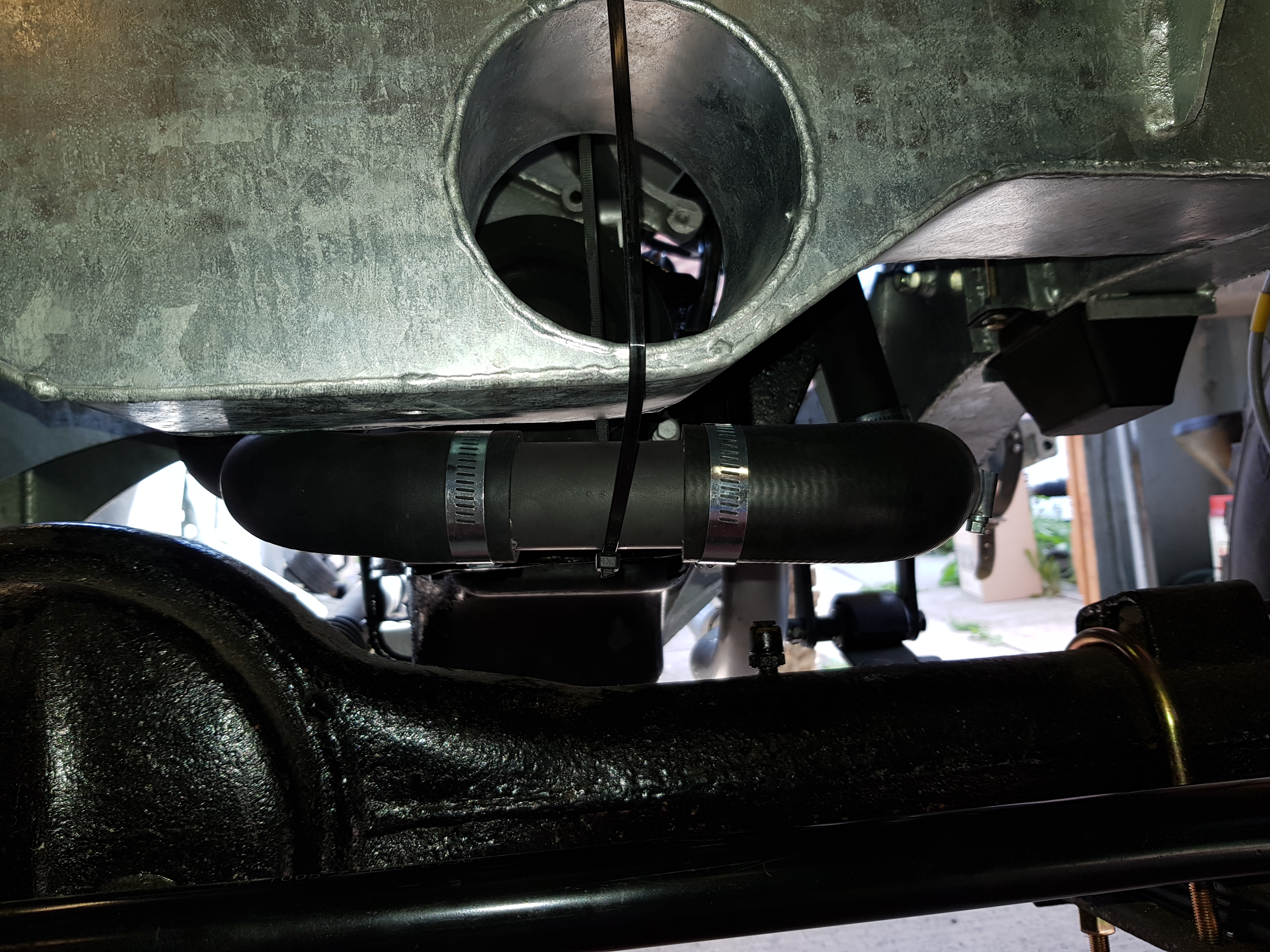

Post by Cornish Rattler » Sat Aug 04, 2018 8:52 pm
Fitted the rad hoses today, just got to fab a bracket to support the bottom hose as its just proud of the front X member :)
