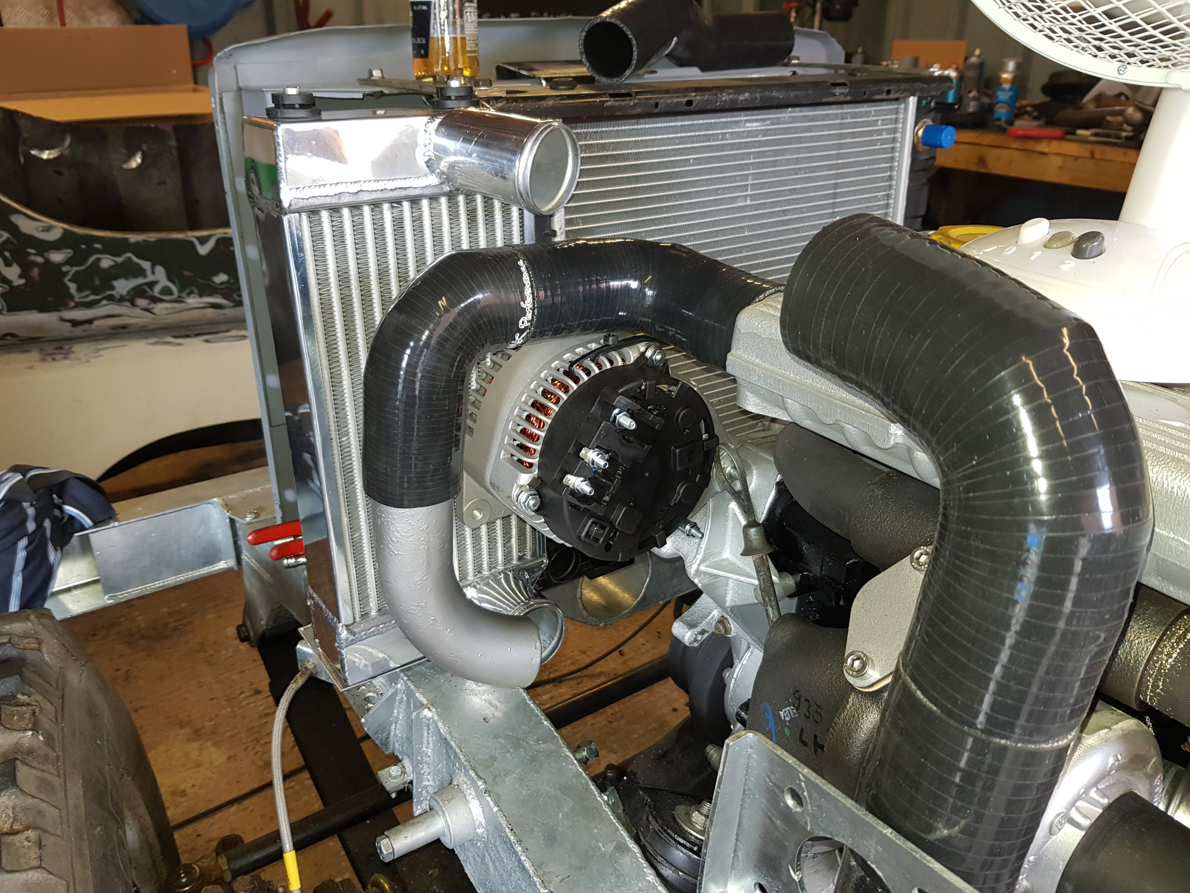

Decided to move the intercooler back a tad on Saturday and today I started to fit the intercooler pipes trying different ways and decided on fitting the intercooler upside down, course the local motorist's shop didn't have any hose clips in so I had to order some in and with the new aftermarket intercooler having 60mm inlet and outlet instead of 50mm I have had to order 2 x 60mm x 50mm reducer's which should be here in 48 hrs :)
Anyway here's the pic's

Finally finished my intercooler pipes yesterday :D
Post by Cornish Rattler » Sat Jul 28, 2018 4:01 pm
one more pic, the blue top rad hose is there to show the two top hoses fit easily as I an going to do the rad hoses in black silicon aswell :D

Cheer's mate, hope to have the rad hoses done in the next couple of week in black silicon then i can remove the rad and intercooler and paint all the brackets i've made to make the rad and intercooler fit and at the same time get the front panel painted ( Limestone ) as that's the colour for the landy i'm going with, then refit it all again :)

I've decided to go with rubber hoses as regards the rad hoses as it would be to expensive going the silicon way, so I've ordered them and should be here by weekend all being well :)
Post by Cornish Rattler » Sat Aug 04, 2018 8:52 pm
Fitted the rad hoses today, just got to fab a bracket to support the bottom hose as its just proud of the front X member :)
