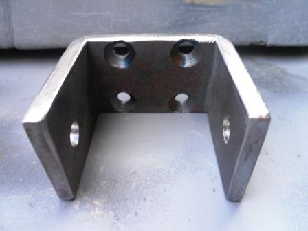

Project time has been a bit short this weekend due to other commitments. :( But I did grab an hour earlier and make this.
Its one of the Recce rear stowage frame securing brackets. Only one was fitted to the vehicle on the right side, the other having been removed to make space for the number plate. Not having any 40mm bar, or the means to heat it up to bend it, this was made from three pieces of 50mm bar welded together and cut down to size.
Here it is next to the original one that was fitted.
Not a big update but it's a little bit more done. :D It will be a while before it gets fitted so I'd best go and put it somewhere safe for now.
