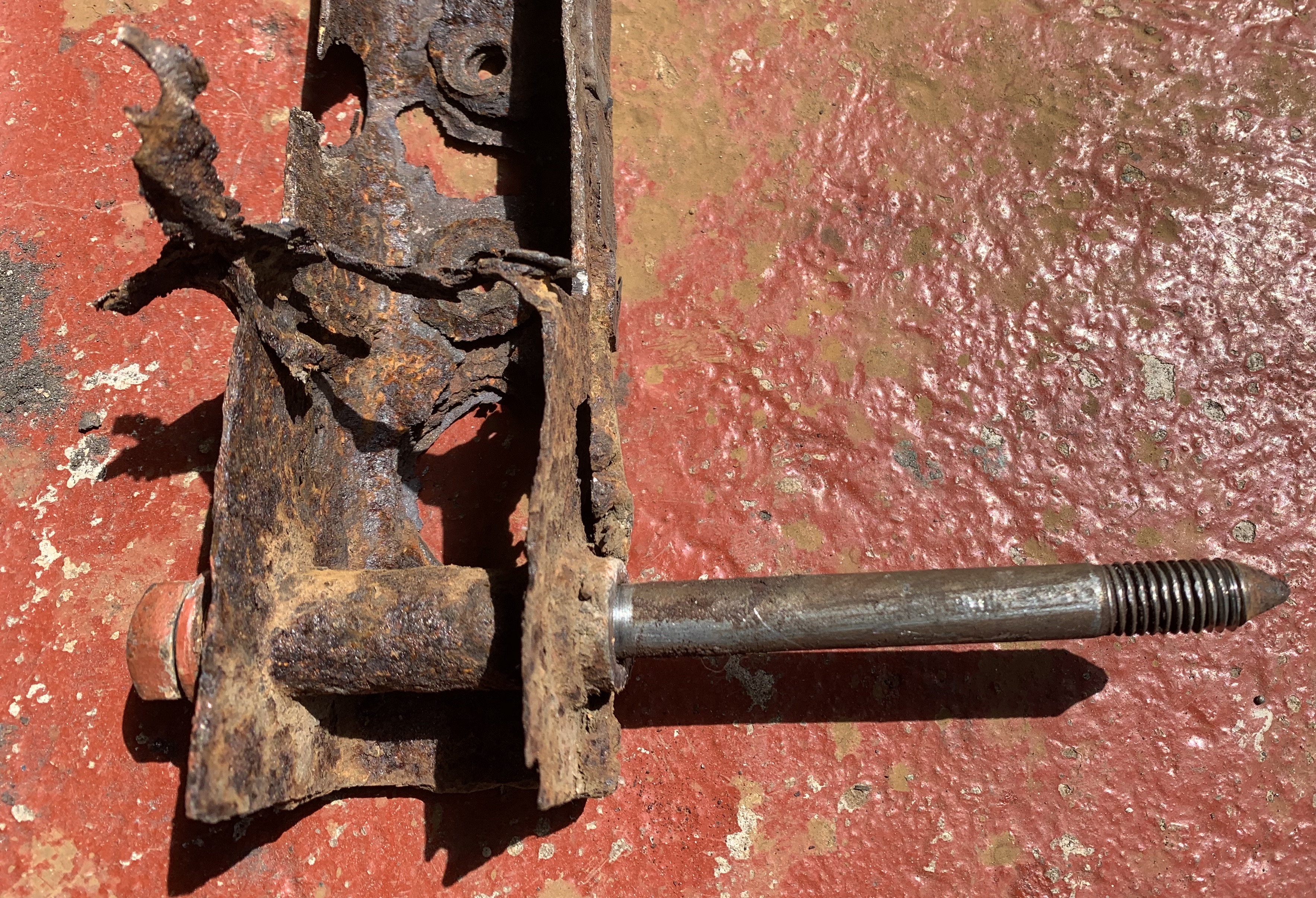

Bit of a lull in 2a towers, few domestic things that needed attention .. so today got stuck into the Driver's side A Pillar. Buoyed up after working on Passenger side - how hard was this going to be? Got stuck in with the saw and the grinder and extracted the old pillar. No problem.
New and old
But as i removed the bolt from the chassis i spied the bolt end.
Pin Sharp

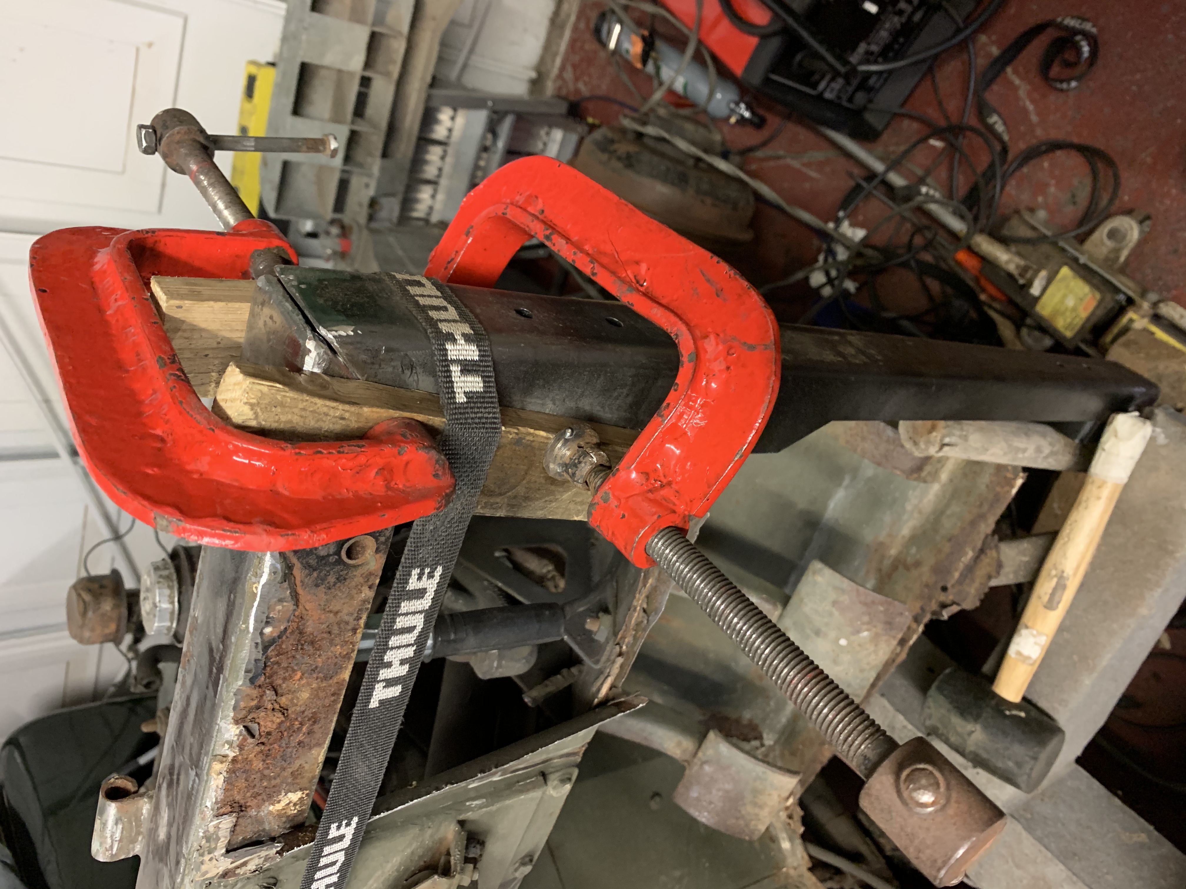

That bolt was fitted when the chassis was renewed at the end of 2008, and for the last 6 years has been sitting in a dry garage. That was a bit of a surprise to me, it had rotted back to the nut. Anyway got it all lined up and clamped ready to weld.
All clamped up and no gas to weld...

Gas situation sorted, time to:
Turn Up the Heat
Turn Up the Wire Feed
Prepare to weld... Weld!
Turned out nice
Time for Beer.

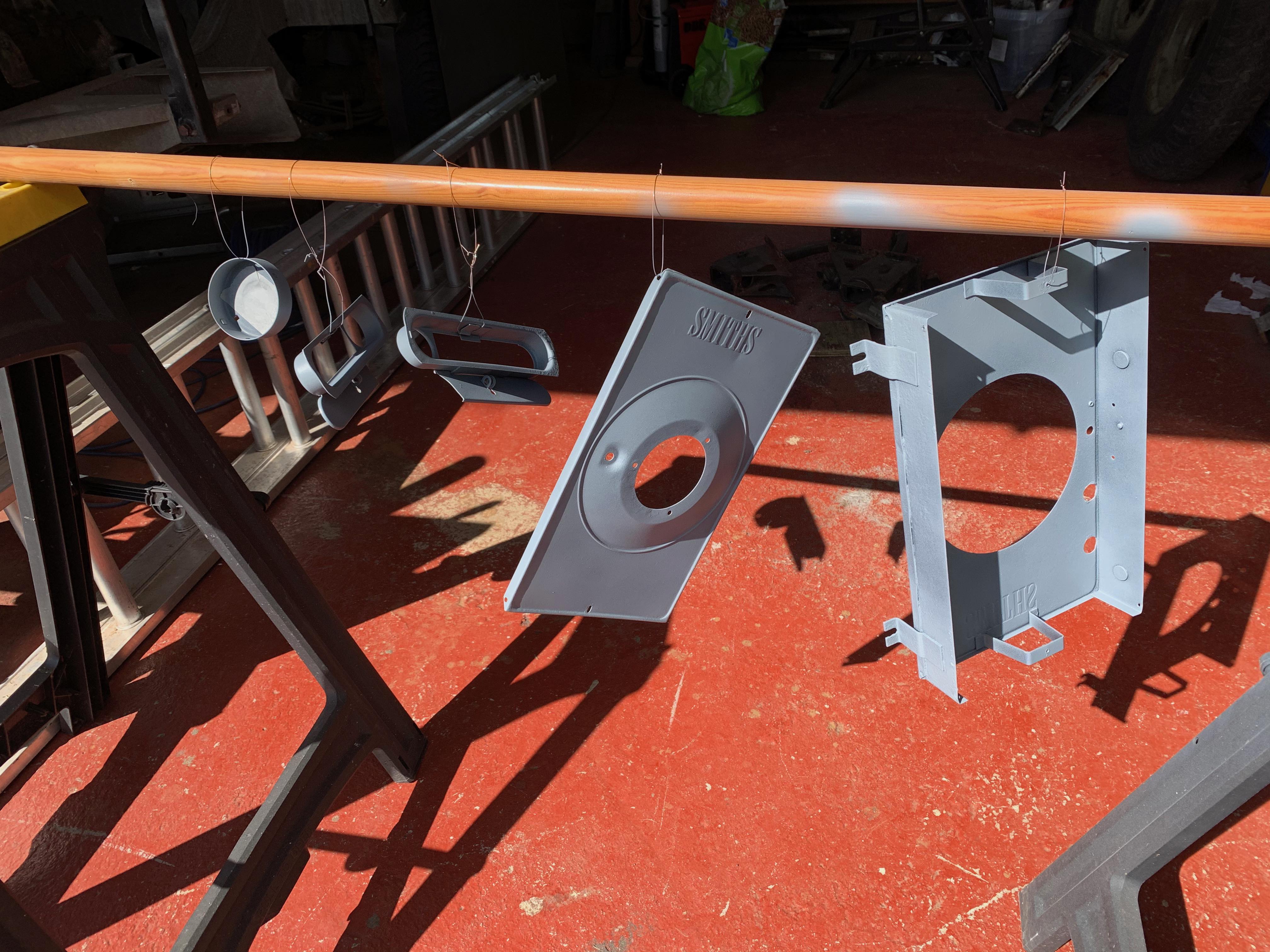

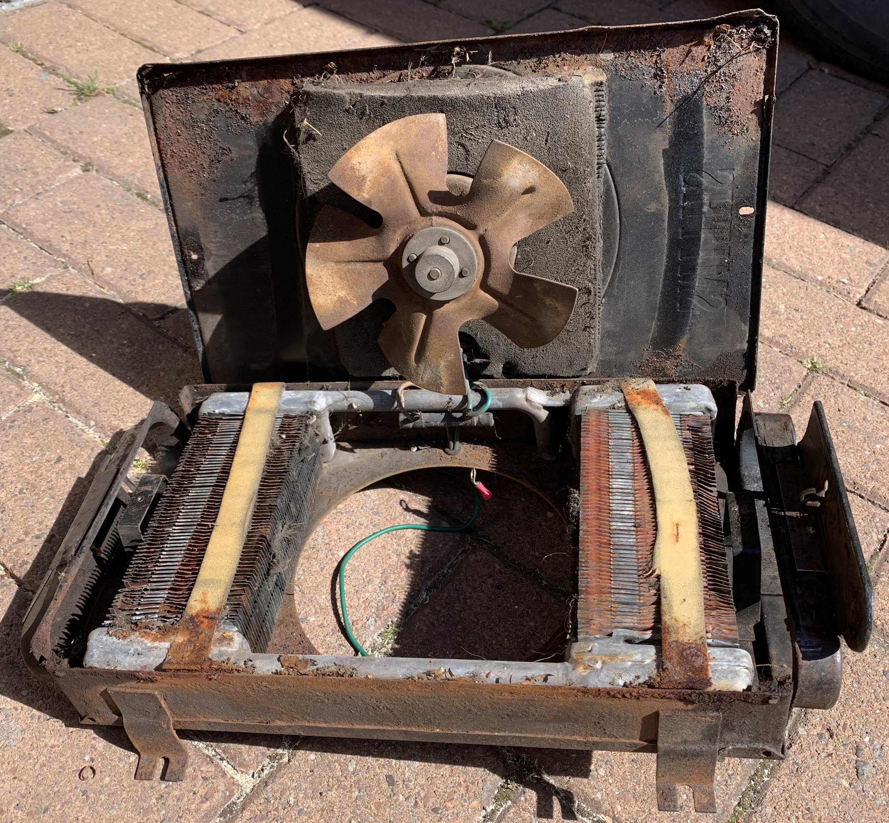

My "Special Projects Manager" has meanwhile got stuck into the Smiths Heater she oft' complained about in the deepest of Scottish winters - especially in the July of the year. Of course the right angle bend on the feed hose wouldn't have helped.
I am convinced i saw a very detailed post on this forum, re the rebuild of a flat heater. I have searched the forum and have not come up with the article i remembered, and now my Clicky-Mouse-Finger is getting sore from searching page after page.
I've seen the Bob Fell post "Re Smiths 24v heater rebuild" of April 11 '18. Does anybody know of an other post? I just want to check a couple of details from photos on washer/spacer positions etc as Special Projects is of the opinion that its not the first time this heater has been opened.
Thanks in anticipation, Dougie

Hi Dougie,
There's a few heater pics on this page and the next in my rebuild thread, don't know if they'll be of any use to you though?
