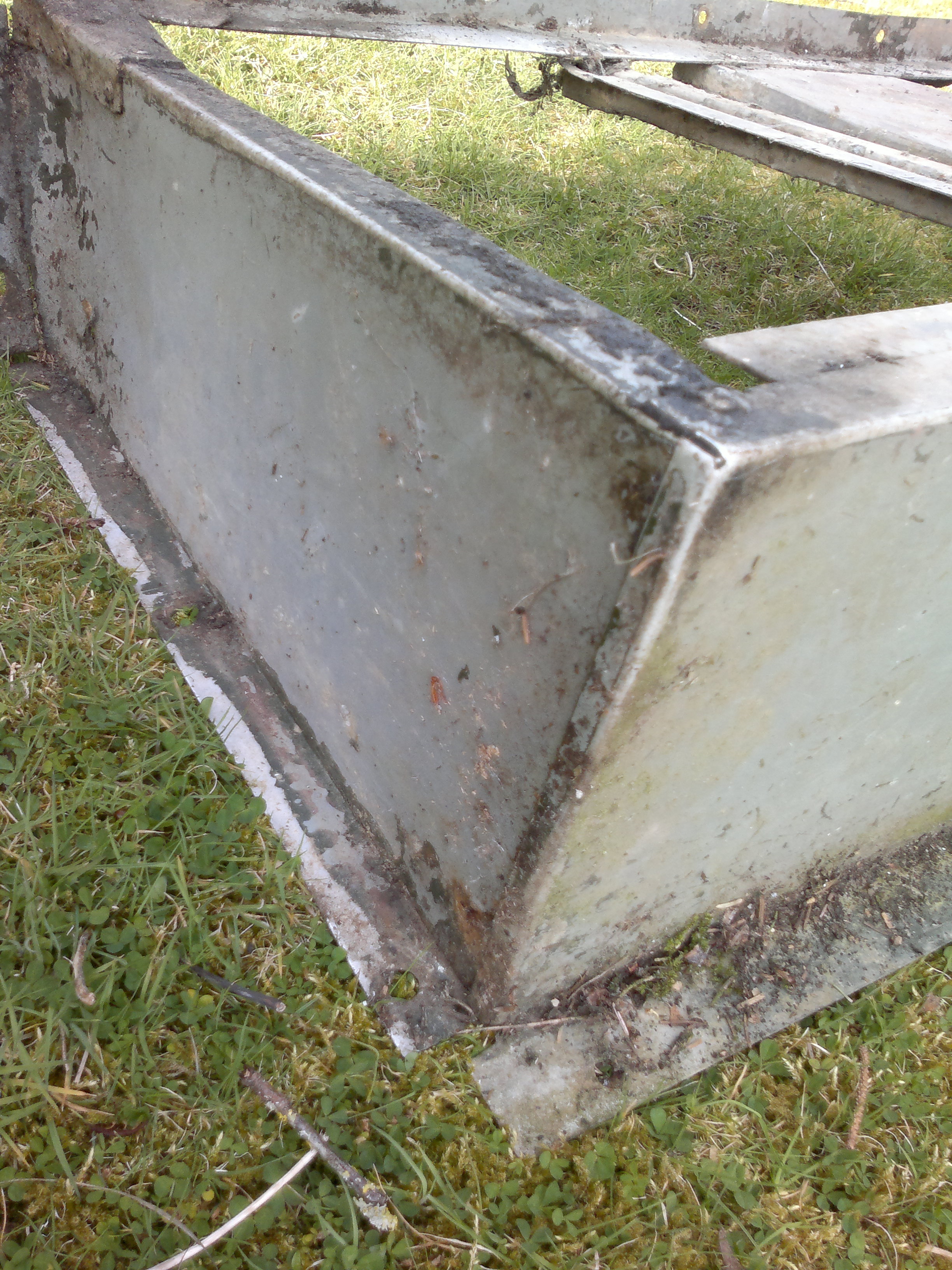

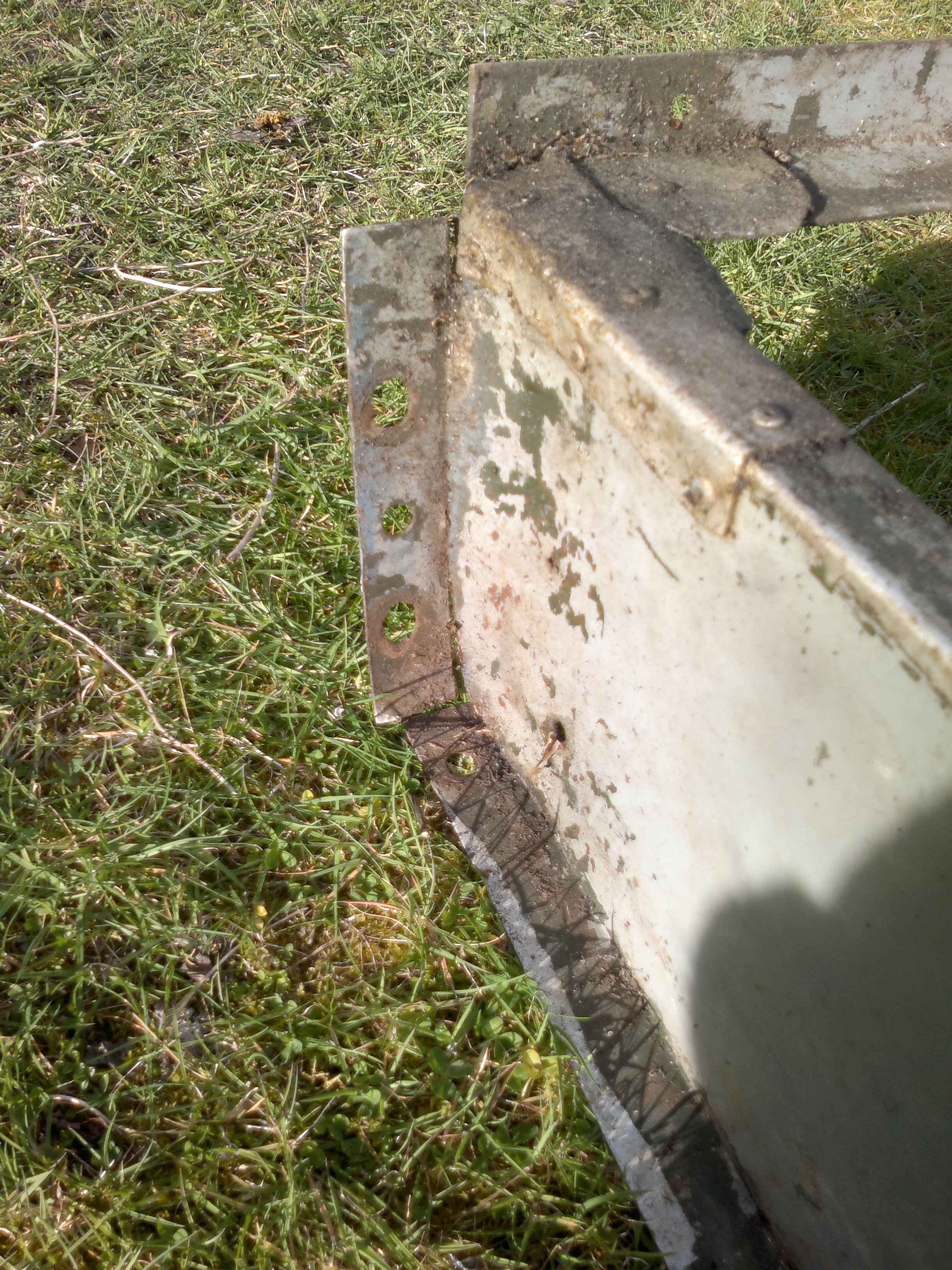

Working on the seat box which has been bodged up in the past, i just never had the time to sort it out. Bought seat box ends a few years ago, haven't even unwrapped them yet. Took off the angle iron reinforcements off and am left with - see photos.
Has anyone got a decent picture of what a 2a seat box should look like?
I'm sure i can fabricate any of the cross members if they prove to be too far gone to use, but I'd like to see what the corners look like -see photo. I'm planning to bond the edges together.
Any ideas? Tips?

Nice machine and pics, Dougie. Took pics when renovating my old Lightweight (39FG42) some time ago. Hope they help?
- 2020-04-14-851.jpg (1.79 MiB) Viewed 5407 times
- 2020-04-14-850.jpg (1.96 MiB) Viewed 5407 times
- 2020-04-14-849.jpg (1.62 MiB) Viewed 5407 times
- 2020-04-14-848.jpg (2.2 MiB) Viewed 5407 times
Re: Series 2a 35 FG 55
That's excellent thanks. Just not sure what's correct or what's been mucked around. I'll update at a later point. Dougie

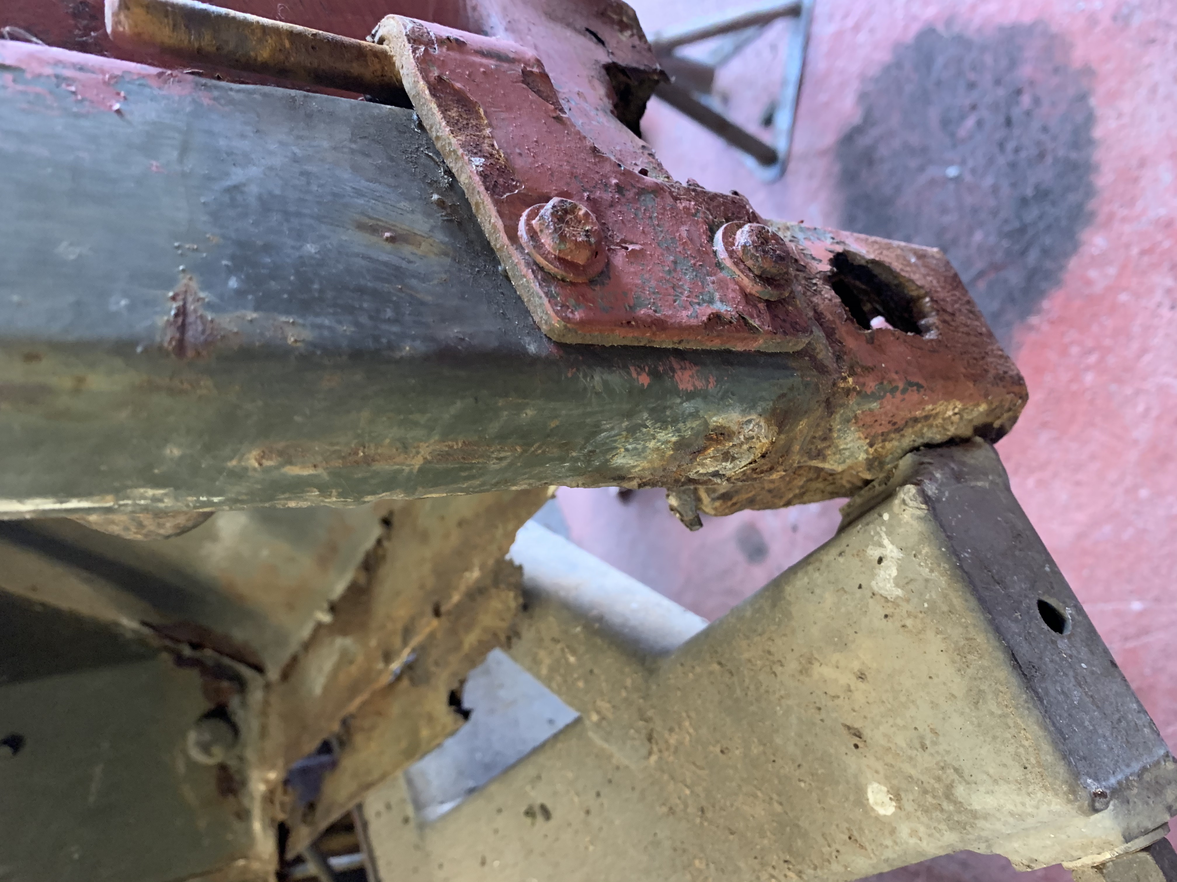

Amongst the jobs i have on the go i've been strengthening, tidying and cleaning up the bonnet ready for a nice new coat of paint. One of the jobs i needed to sort out was to replace 2 pop rivets which were holding down a couple of rotting repair washers in the middle of the bonnet. I had assumed they were there to hold the outer skin against the reinforced frame below.
But when i drilled the rivets out 2 big holes appeared. the location is right next to where the spare wheel staple is located, the picture shows the 2 small holes, and in indent where it was fitted.
Anybody got an idea what they might have been for, they are really neat - meaning they aren't rough in any way, however i can now see that they are not centre.
