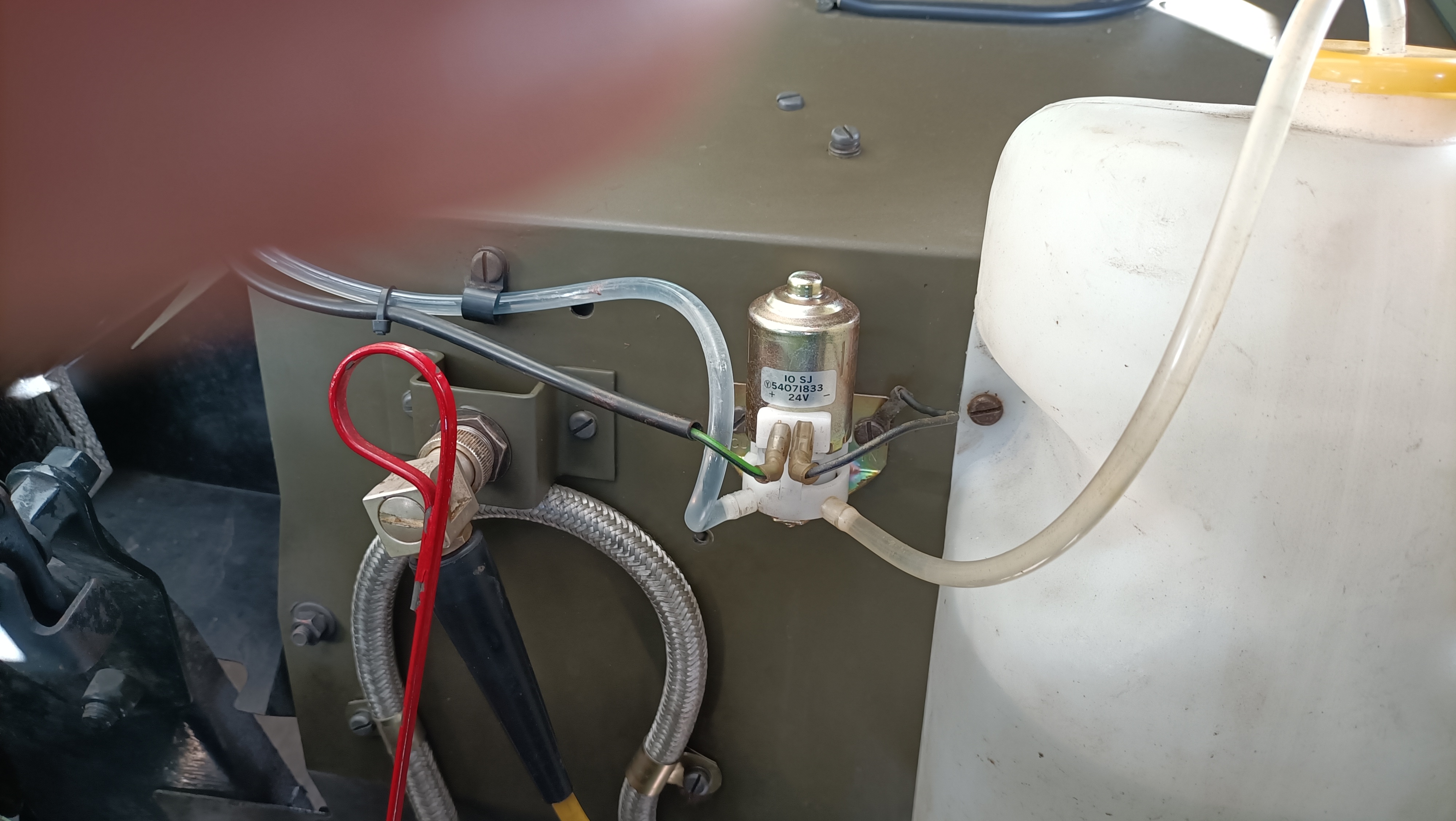

Also fitted new washer pump as the Trico was starting to leak at the bottom;

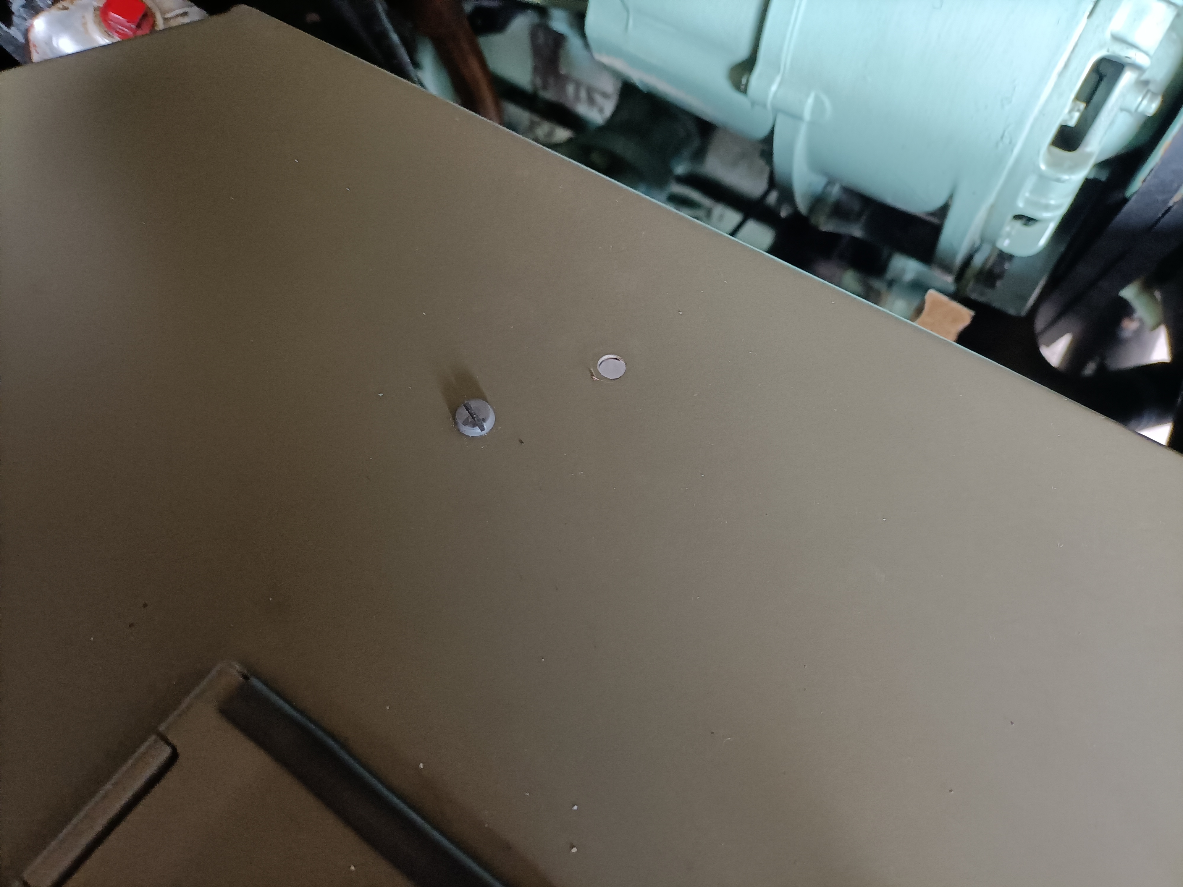

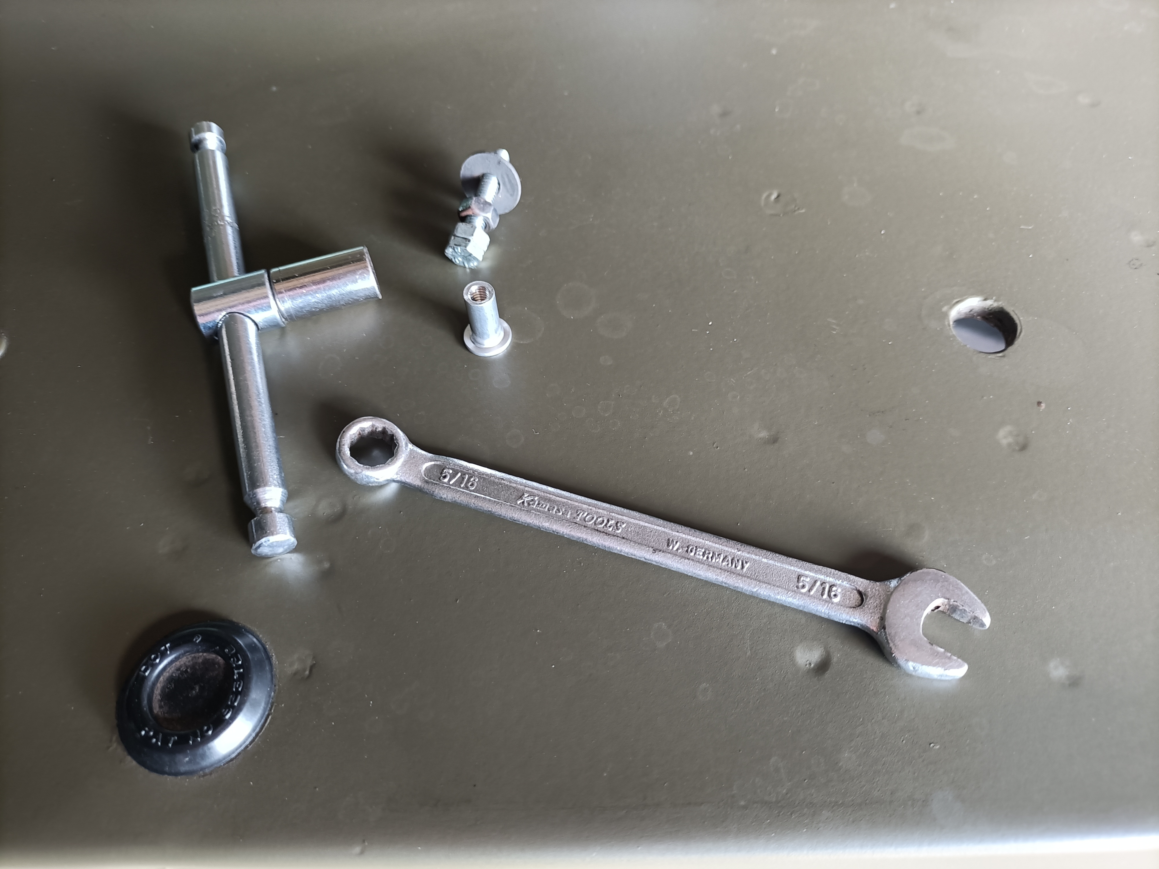

And to finish this little project I needed to replace 1 missing rivnut for the cable clip retaining screw in each of the wings;
No special tools required;
Job done.

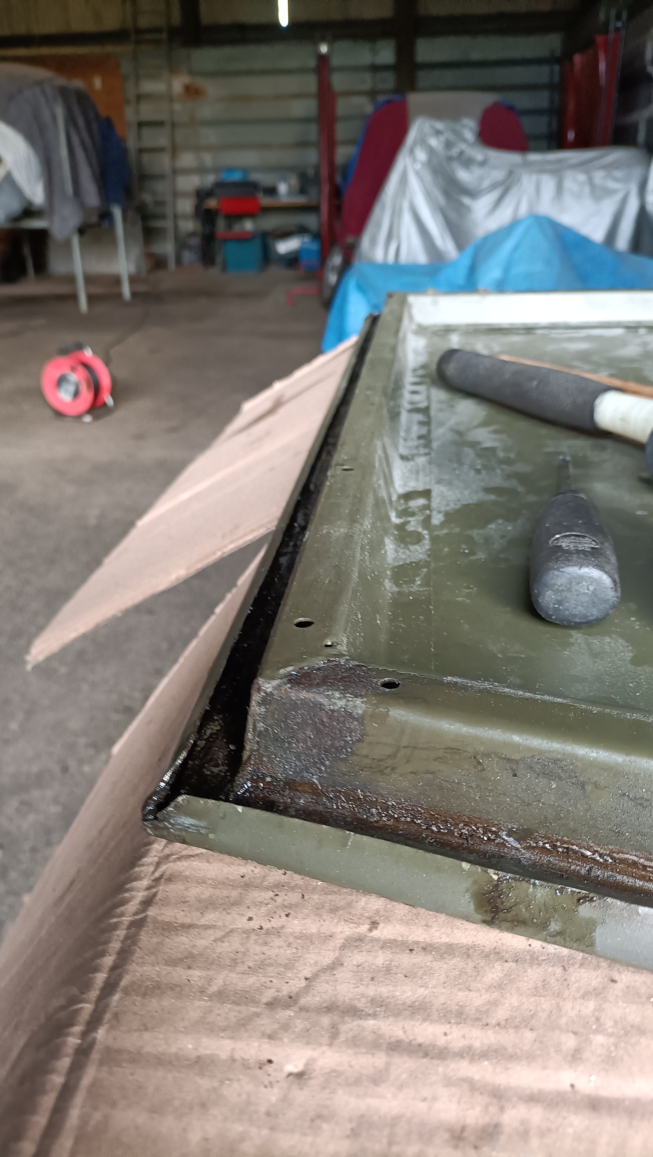

Couple of weeks back I went to change the bottom seal on the RH door and found this when I took it off...
A common problem hidden by the seal carrier on a Lightweight so at the weekend the door was stripped down and de-skinned pending repair with a new bottom frame section.

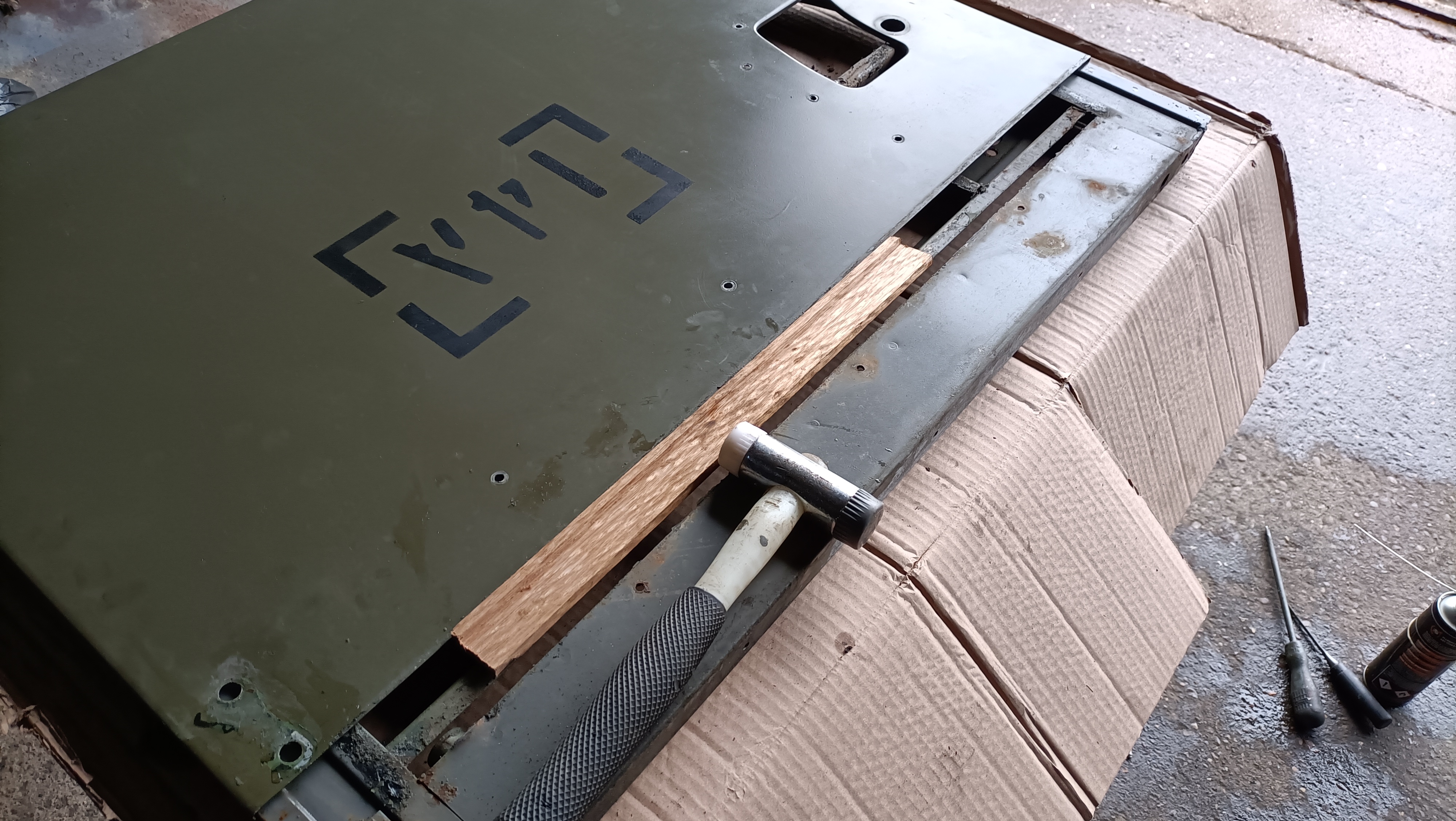

First bit was to ease the skin tabs to free it from the frame....
No special tools required, just take time and bend up carefully,
With that done I sprayed Plus Gas all around the frame where it meets the door skin to soften and release any sealant then after a few minutes soaking I tapped off the door skin, it came off clean and easy..

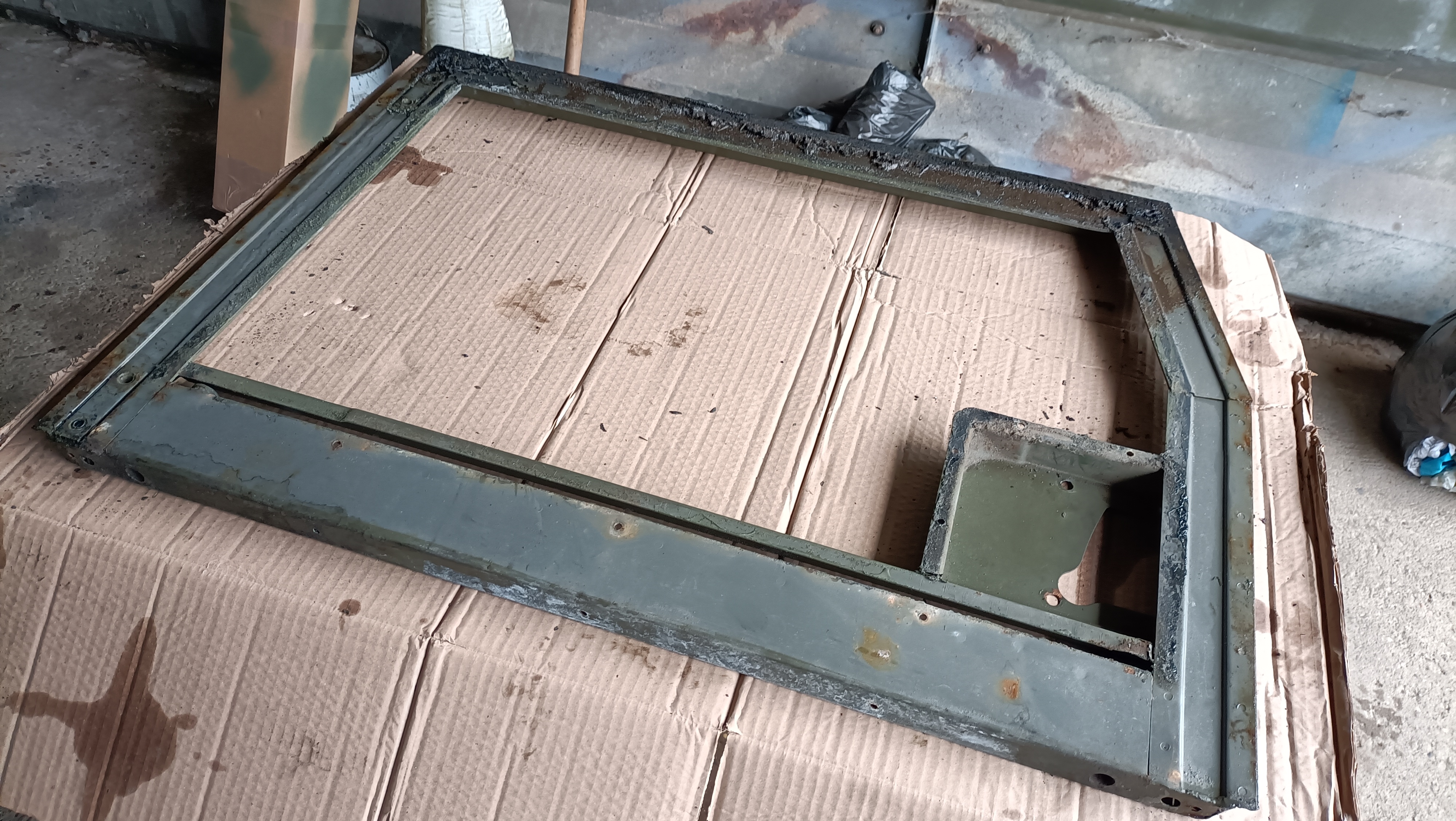

Post by Bob Fell » Mon Nov 10, 2025 12:38 pm
The frame overall excepting the bottom rail is in good condition;
With a lot of crud to the bottom....
Where I found this......

It looks like the termites have been busy in your door frame. Good to see that you managed to peel back the door skin without it cracking. At least it's a fairly straight forward repair once the skin is off of the frame.
