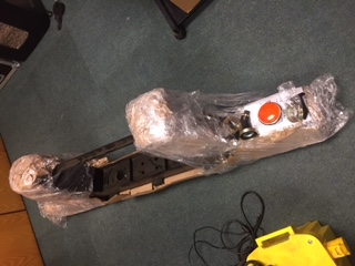

avgenisis
Posts: 97
Joined: Thu Jan 05, 2017 5:28 pm
Location: Norfolk, UK
Re: Project 56-KB-23
Post by avgenisis » Wed Jan 18, 2017 1:57 pm
and in today's post room trawl.....
still hoping for MOT next Friday.....
