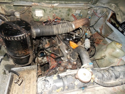

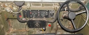

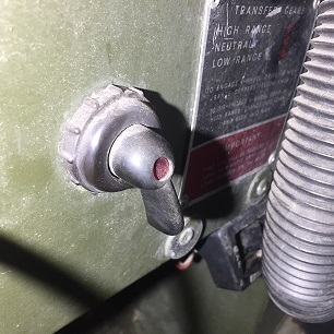

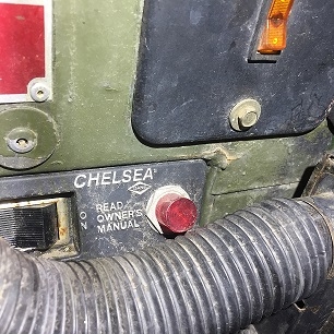

Here are a few shots from the electrical carnage..
- 20170114_143902326_iOS.jpg (202.58 KiB) Viewed 3515 times
- 20170114_143858558_iOS.jpg (99.93 KiB) Viewed 3515 times
- 20170114_143851082_iOS.jpg (80.16 KiB) Viewed 3515 times
- 20170114_215845000_iOS.png (108.35 KiB) Viewed 3515 times
Re: Project 56-KB-23
and a couple more. engine bay has loads off "new wires" ...

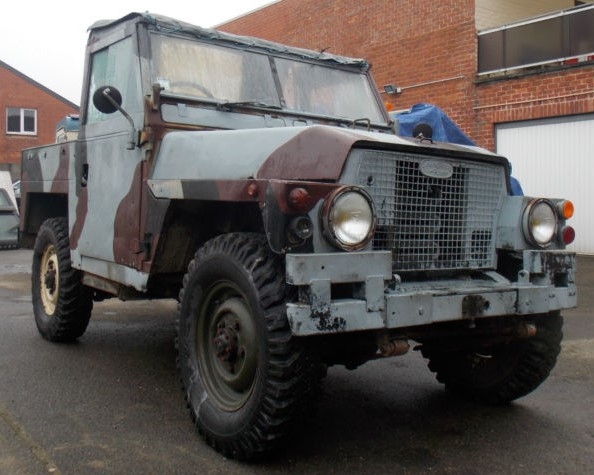

A quick question, is the camoflage design fact or fictional?
It looks to be an interesting vehicle. How will you finish it? Are you going for originality or something more individual? The contract number is in line with its registration number suggesting a build date of 1983, but there are some earlier parts on it. I think, by 1983 it would originally have had standard Series 3 axles (the ones with the little caps on the end) whereas yours has the older Lightweight pattern with flat ends. You also have the older dashboard without the brake test light and rear fog lamp warning light. Do you have an IR switch? I see there is a switch where it would be, but I can't tell whether it is an IR switch or an aftermarket one.
Have fun with the wiring loom - when I bought it mine looked perfectly ordinary, but there was a fuse missing, though everything was working. I popped fuse in the empty gap and all sorts of things started hissing and crackling and going click. I never got to the bottom of it, I must admit. When the loom goes back in it will be standard.
As for the colour, no, I don't recognise it as a standard British military pattern. It looks as though a PO has been busy with a paintbrush at some time.
Anyway, enjoy the road you are about to travel!
Thans for the comments, as far as the actual vehicle goes, fairly origonal i think, ie not adding hundreds of antenea etc.
I quite like the grey but not so much the mixture of colours, so if i can find a grey based camo design i may go that route.

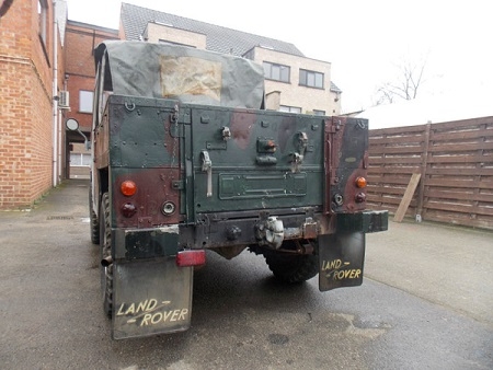

wow, interesting stuff.... funny you should say brown and green, here is the rear view.....
