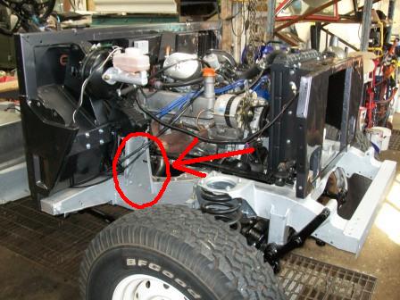

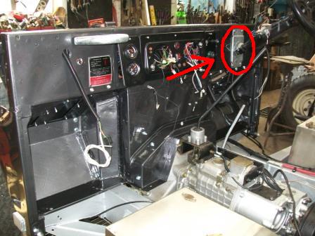

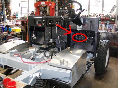

Moving the top of the bulkhead forwards to square it off can be tricky and have varying results. I have had success fitting a new bulkhead that been dropped on a corner bending it, to a Defender, and squaring up a rolled Defender to get everything to line up using the same type of method below.
Loosen the steering column to bracket bolts, and the bracket to bulkhead bolts where circled below.
It may not be neccessary to udo the plate itself, but it wont hurt to loosen the two column clamp bolts.
Loosen the steering box/bulkhead plate at the chassis and the wing if still fitted. It may be benificial to remove the wing anyway.
With the bolts loosened, persuade the top of the bulkhead forwards, if possible, with a ratchet strap pulling against something solid. The bumper should do if the wing is off. With the bulkhead pulled as far forwards as possible tighten all the bolts, and hope it stays there. Re-check the vertical alignment, and adjust as neccessary using the same method until you get it near to square as possible.
