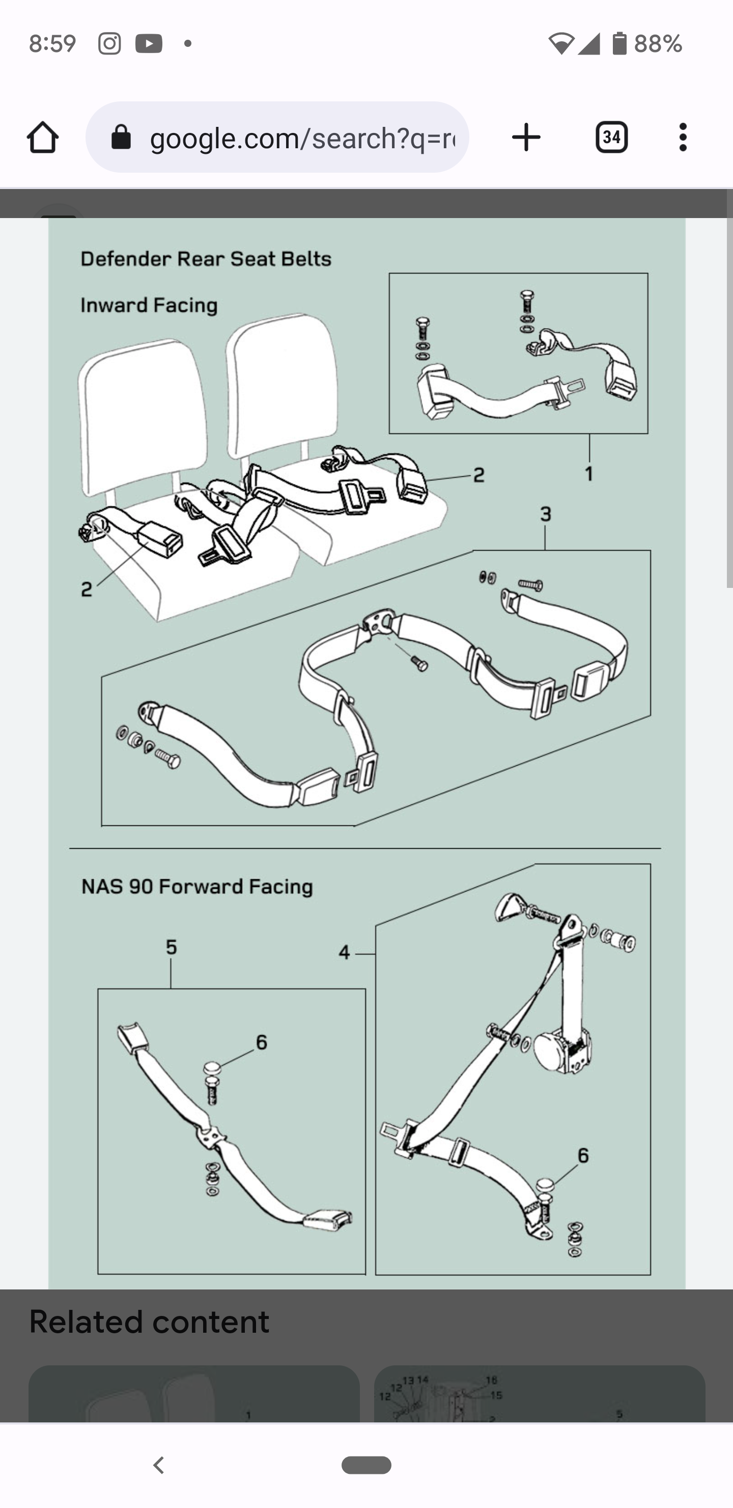

Wondering if anyone has fitted rear bench seat belts (side facing not forward facing) and if so, please share a pic of the brackets / fittings you used.
I have one central large bolt with a rear backing plate. The plate is slotted under the rear wheel arch just like the captive nut plates for the tub time down brackets. But there is only one. This would work for one half of the belt, but then there is nothing for the other half of the lap belt.
The below pic seems to be a good way to achieve what I want, but some pics from you could be great guidance.

I haven't fitted seatbelts to a Series with bench seats, but at work I have fitted a few inward facing seats and lap belts to Defender vans for customers who can't afford real Station Wagons.
The seatbelt plates that come with the kits we use look like this.
https://www.ebay.co.uk/itm/282747113478
When fitting a pair of seats to each side there isn't enough room to centrally fit a pair of these plates to the underside of the wheelbox as there is a strengthening rib in the way, so I tend to fit both stalks to the inside of the seats using one central mounting plate, with the belts fitted to the outside of the seats. It looks like the belts marked 2 in your pic, but reversed, and mounted like those marked 3, using just three bolts and plates. You could, I guess, do this with the belts on a bench seat instalment if using lap belts.
