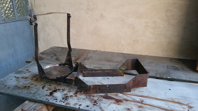

Hello, apologize if the title do not makes sense, I do not know exactly how you call the bracket in picture, maybe Admin can helps me modifying the name...
As you can see in the picture the previous owner modified the bracket in order to put a longer battery and now I want to come back to the original shape but I do not have any reference.
Could someone be so kind of send me a picture of the original one?
thank you

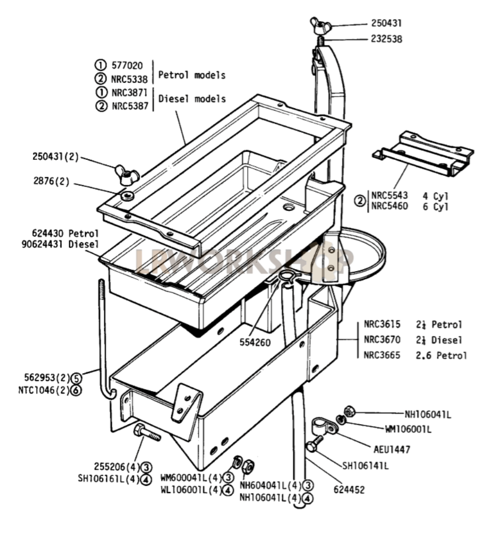

Maybe this will help?
https://www.lrworkshop.com/diagrams/lan ... 9in-v8_397
Screen Shot 2021-03-29 at 10.47.52 am.png (418.61 KiB) Viewed 963 times

Post by Ade » Mon Mar 29, 2021 5:06 pm
Thank you so much
It is what I need

Post by 88lr » Tue Mar 30, 2021 6:11 pm
If you vehicle is a 2A 12 volt then you have the correct type (562928) it just needs cutting back and rewelding. The battery cover (clamp) is 236986
