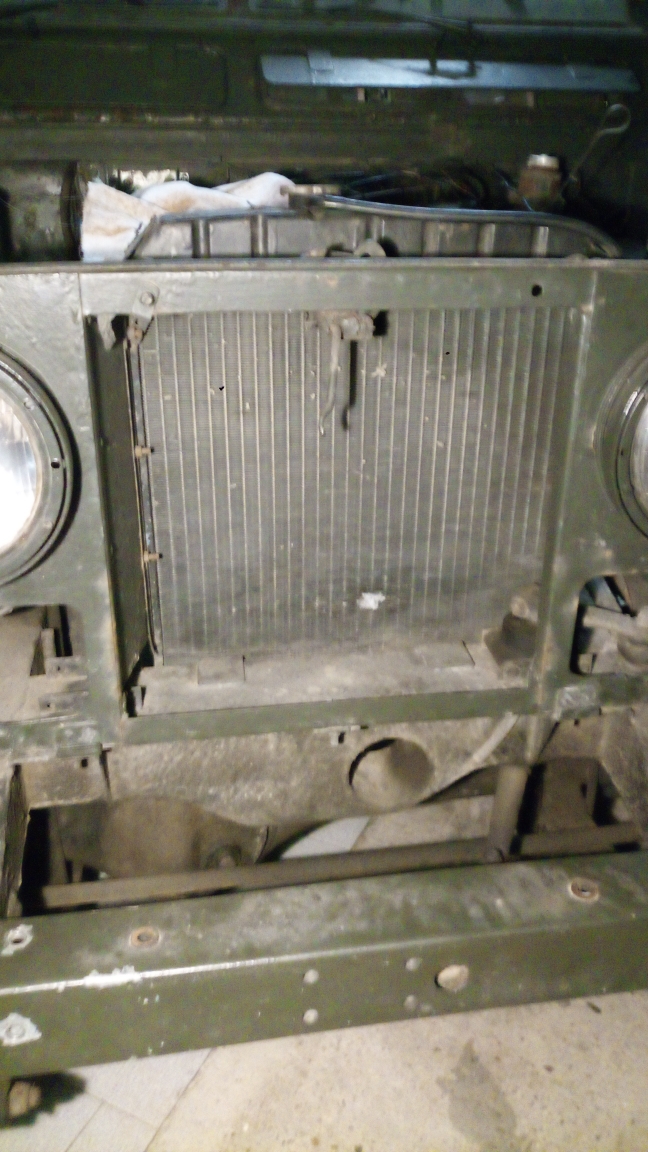

One strange thing your vehicle has been fitted with early wings and headlight panel (and rad) It should have the headlights in the wings and the later thinner rad.

I agree with you Mark, I think it should as a '71 vehicle have the headlights in the wings and the slimmer Series 3 rad, but I'm not sure when the last of the original vehicles with the old style front grill mounted headlights ceased in production, it's configuration maybe gen; I used to own 61FK22 which was one of the last 2A's off the production line and they were outboard on the wings and it had the later S3 slim rad.

as you can see in the photo it has a thicker radiator and the wings are modified by hand with rivets, it does not have an oil cooler.
If I found all the spare parts I could think of bringing it back to its origins, but it will probably be a waste of time and money:
From the point of view of historicity it will never be of great value, it has a diesel engine because in almost all the series imported into Italy in the 70s the taxes on petrol above 2000cc were very high and now, unfortunately, it is not possible for Italian laws to replace the engine.
it can become just a nice toy for a few outings

The early wings are not modified, they have just been repaired with rivets where the spotwelds have failed (quite a common problem on early wings)
Many years ago the early type wings were very common second hand, most people wanted to update their early 2As to s3 wings. I had four or five early pairs in varying states that I had collected, stupidly I binned them all after I bought a NOS set from Craddocks
