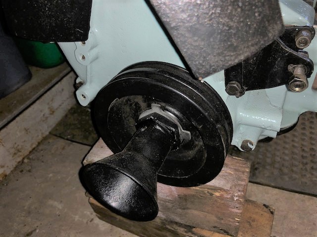

Having rebuilt my 2.25 engine (236 and original to the vehicle), I'm now at the point of sorting out crank pulley bolts. When I got the vehicle, it had no crank bolt on at all. Clearly somebody had robbed it which makes me think that it probably had one of those trumpet guides for the crank handle.
I have both versions - with and without the trumpet, but assuming that originally it would have had a trumpet dog fitted (I stand to be corrected...), how on earth are you supposed to torque up the crank pulley bolt if a trumpet is fitted? I think the nut size is 1 5/8", but clearly a ring spanner or deep socket won't fit over the trumpet. Putting my truck engineer hat on, I assume the answer is an open slogging spanner, but without going back to my O level physics and working out how to measure the torque, is there a simple method of doing this. How did the Army do it?
Clearly a slogging spanner being given a good thump and then bending over the lock washer and all should be fine. I just want to understand what tools Her Majesty's Finest would have used if doing it by the book...

Torqued mine up with a bolt shank that just fit in the starter dog hole. The bolt was drilled to take a pin mimicking the starter handle. Torque wrench clicked at the right value but don’t think the bolt was up to it as it had started to twist where it was drilled but job done.

Re: Crank Pulley Bolt - Trumpet Fitted...
I did finally mange to do it up!
No idea how I'll undo it again if I have to, but I made this from a hardened steel pin and an anti roll bar bolt / pin from a Defender. Worked a treat!
Not sure how many times it would work without sheering, but once was enough! I made it a sleeve fit into the crank dog and the hardened pin is an exact fit to the profile of the dog at 9mm.
