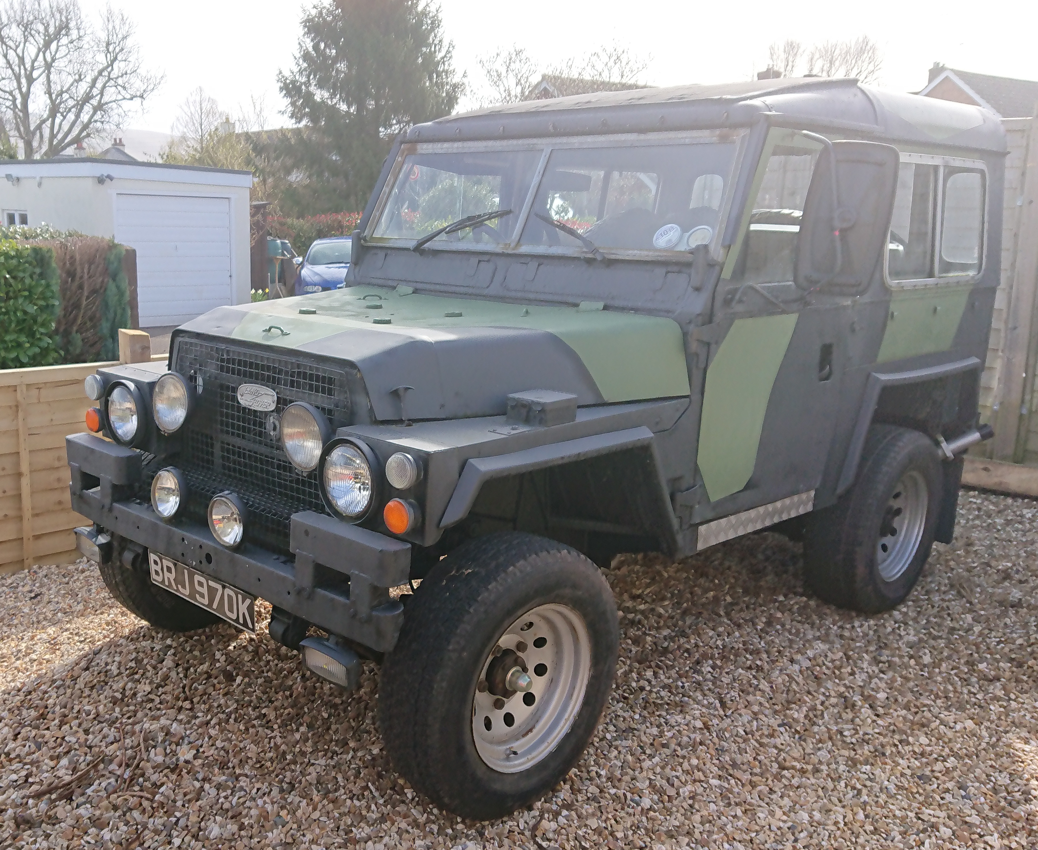

As well as the FFR which I sold I purchased a Lightweight V8 auto (my youngest son has an arm injury and can only drive an auto)) but due to then moving house and undergoing a complete referb on the property it's been sitting in a field since then.
Now in a position to start refurbing. Loads to do but one item is a hole in what appears to be a heater control but I cannot find anything on RR or LR diagrams that look similar. Anyone got any ideas as to where it came from?
