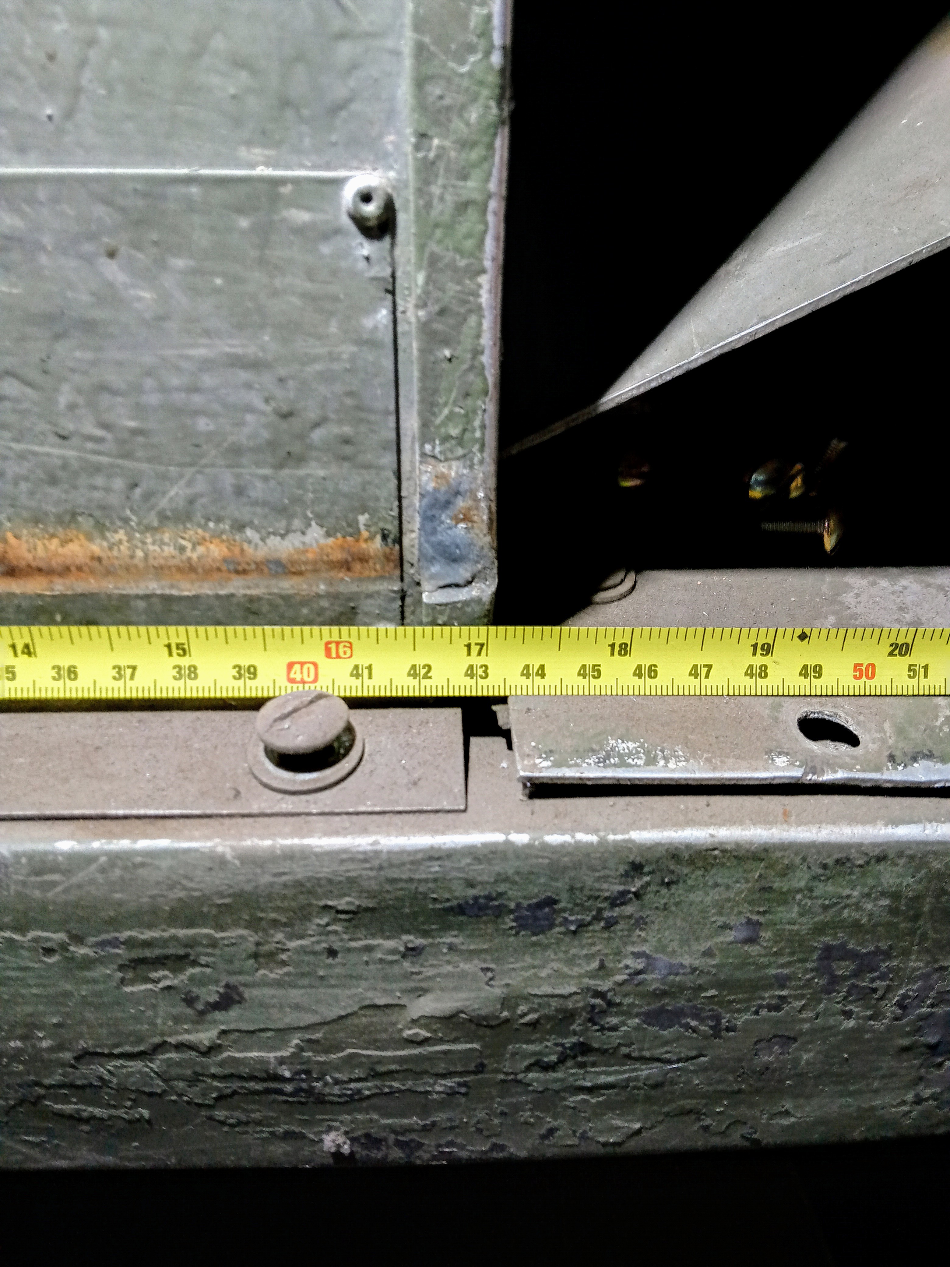

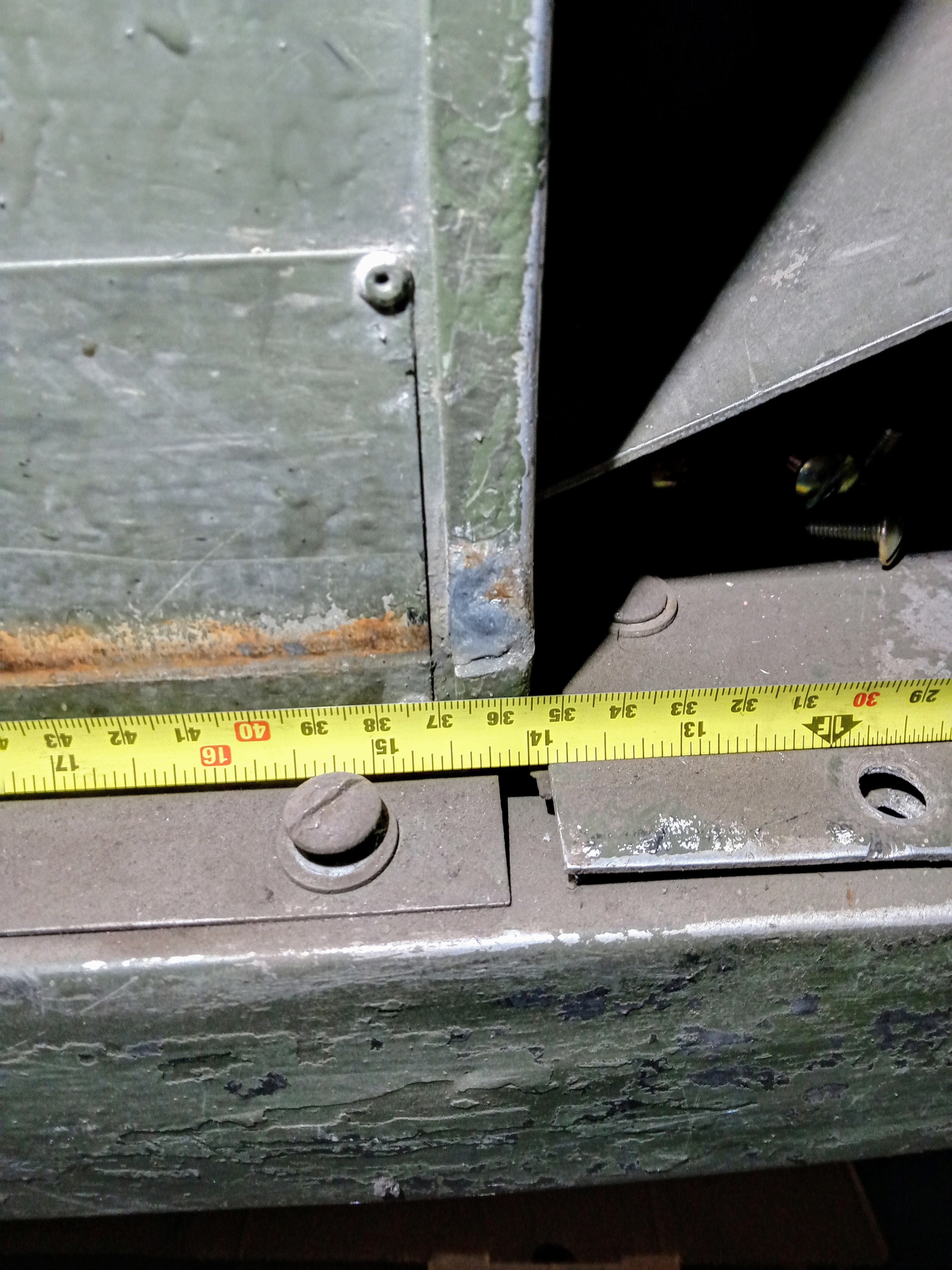

Measurement from the tub end.
Measurement from the bulkhead A post.

A few more measurements for you from the lightweight here. All approximate as done with a tape measure.
From the front face of the seatbox above the gearbox, to the bulkhead firewall panel, is 360mm. From the seatbox as above, to the face of the gearbox cover panel, is 310mm. The gearbox tunnel measured at the top, is 300mm.
Your seatbox looks to be bolted down to the chassis bracket alongside the gearbox correctly,
