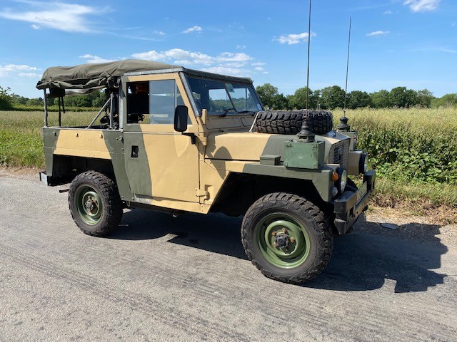

Thanks very much for the welcome and the helpful advice above folks! I will keep you updated on my progress. It is going to be a nice winter running project to get it a bit more up to scratch. It is still 24v - it has the 2 battery set up where the middle seat would be. I'm located in the Isle of Man. I believe that there are a few other LtWts here too, but have yet to meet the owners. It does drive fine, but with quirks, some of which I think I can improve fairly readily based on your kind advice!
Here is the beast in question:

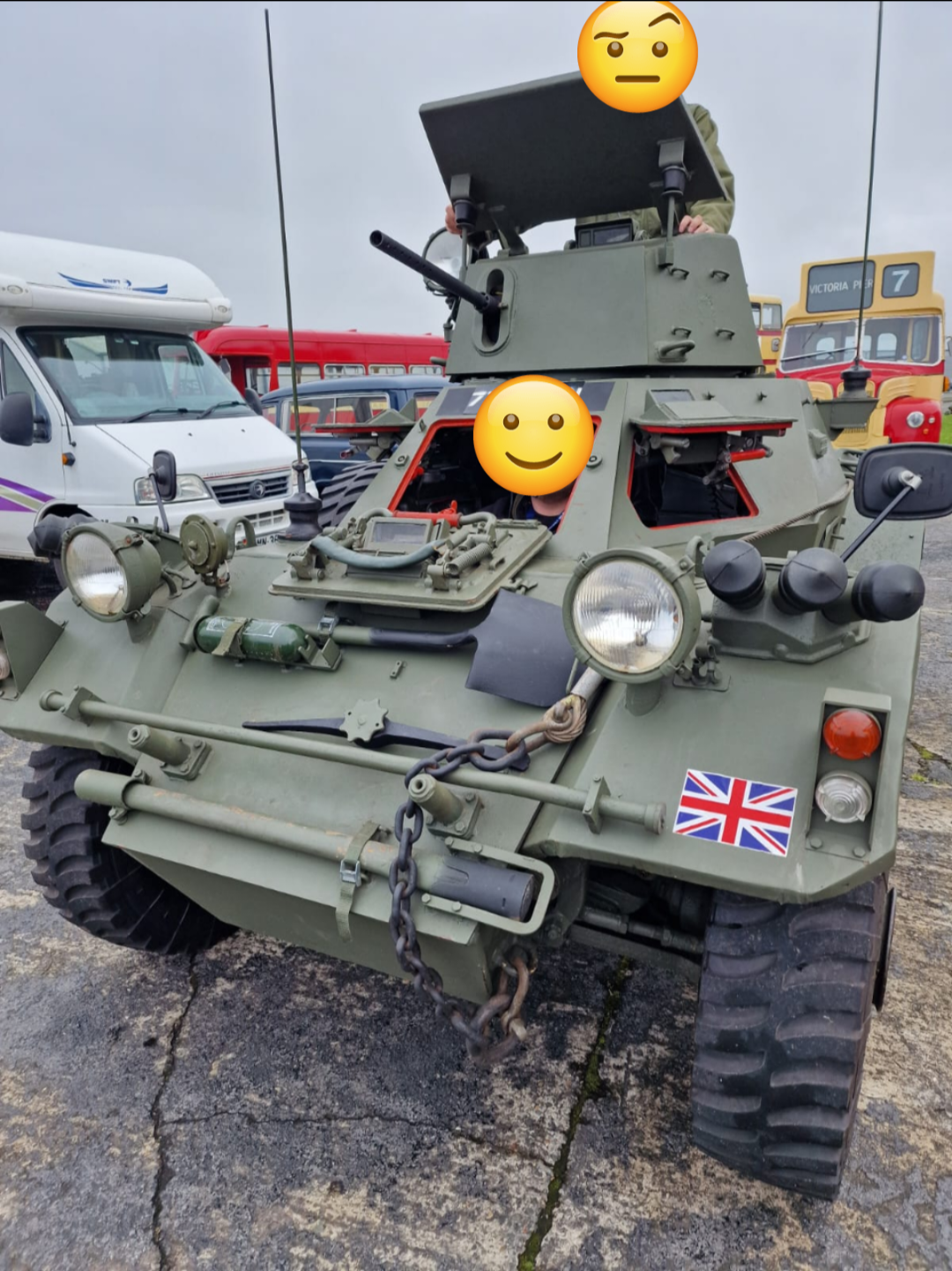

And the Ferret 2/3:
Our current Ferret issue is to get all of the storage bins mounted properly as well as to adjust the brakes. We had them working really well previously but then had to rebuild the front right corner completely so have to start again, bleeding, adjusting the shoes etc etc, which is a bit of an art on these things. I suspect that it is quicker than the LtWt, but have suggested a race to the owner of the ferret to test the point!

That's a nice looking lightweight you have, thanks for sharing the pics. I've always liked that colour scheme.
(I still can't believe people want to drive the FSC for fun.
Just getting in and out of the driver's seat is a mission.)

Thanks for the pics. Let me guess that the most asked question about the FSC is "What are those black pointy things?" I hope there are plastic tie strips around them as they tend to disappear.
Re: Series 3 FFR Lightweight Owner
It is a mission, especially when the current driver is almost certainly more portly than the original crew it was designed for! That said, you do get used to it and there is a lot of adjustment in the seat back and forward. You can also take the seat back support off really easily, which makes getting in and out from the turret much easier. If you get in/out the front hatch, you really have to have good mobility in your knees though!
I must admit that I love driving it. It is very unlike anything else that I had previously driven with the pre-selector and fluid flywheel. You get used to it really quickly though and it becomes really intuitive. That said, we haven't taken it on any longer road trips yet!
Yes! Tying the black covers on is a good idea! We also get asked whether the gun is real (it isn't).

As you are probably aware are there flat rubber covers for the FSC smokies as well as the more common pointy ones.
I once did an experiment with flat ones on one set & pointy on the other. The flat covers received little attention but the pointy ones invited more curiosity being fondled incessantly & pushed inwards. I'm sure a psychiatrist could explain that!

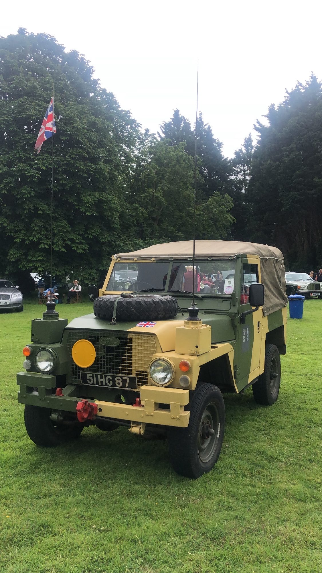

Nice, I like the colour scheme, see that somewhere before.....
