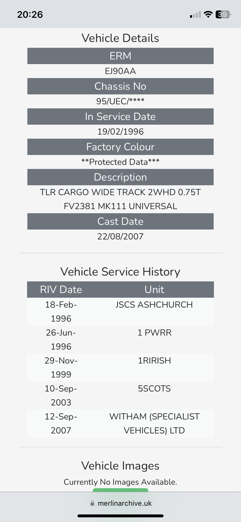

Unfortunately can’t upload any photos as they are all too big, have cropped them but still too large! Can include the report on what it did while serving.
