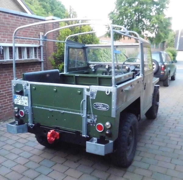

Hi Andy,
my Lightweight is from 6 / 1976. There were some differences to a normal Series III in the front so that it looks like a IIA. But I am quite sure, that the tailgate is original. The holder of the numberplate was missing (I made it on my own) but the square hole was in the lower part where the bracket finds place.
So I assume: yours should be with drop down fittings
