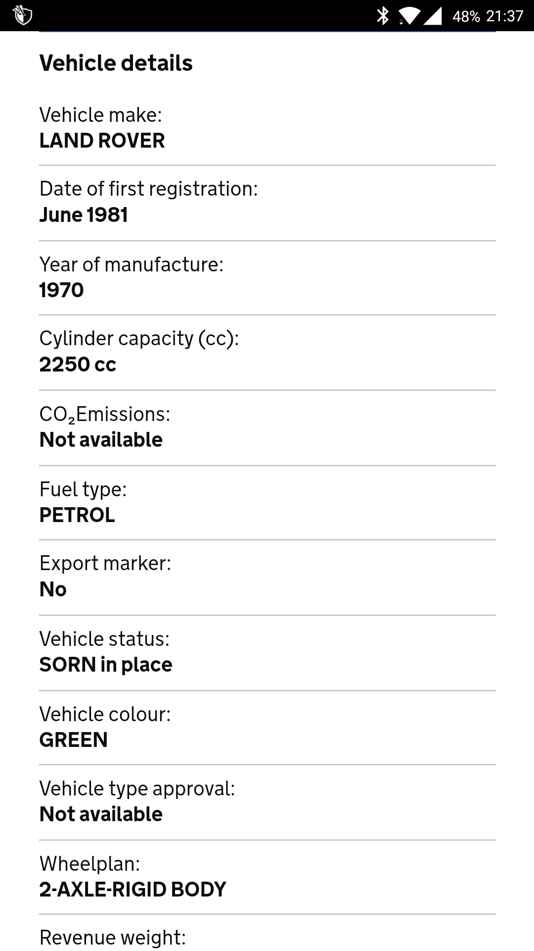

Re: MOT rule changes
Posted: Mon May 21, 2018 9:38 pm
by GAZ_XB9R
It says 40 years from when it was registered or manufactured.
Mine has a 1970 build date and 1981 first registration date.
Anyone know if I will be ok for no MOT or whether I'll have to get something changed with the DVLA?
That's off the .gov site.
Posted: Mon May 21, 2018 10:24 pm
by removeduser185
You are correct, it does say registration or date of manufacture and, regarding your question, this is also from the same source:
"What you have to do
You must apply for a vehicle tax exemption to stop paying vehicle tax. This is sometimes called putting a vehicle into the ‘historic tax class’.
You do not have to apply to stop getting an MOT for your vehicle each year. However, you must still keep it in a roadworthy condition."
