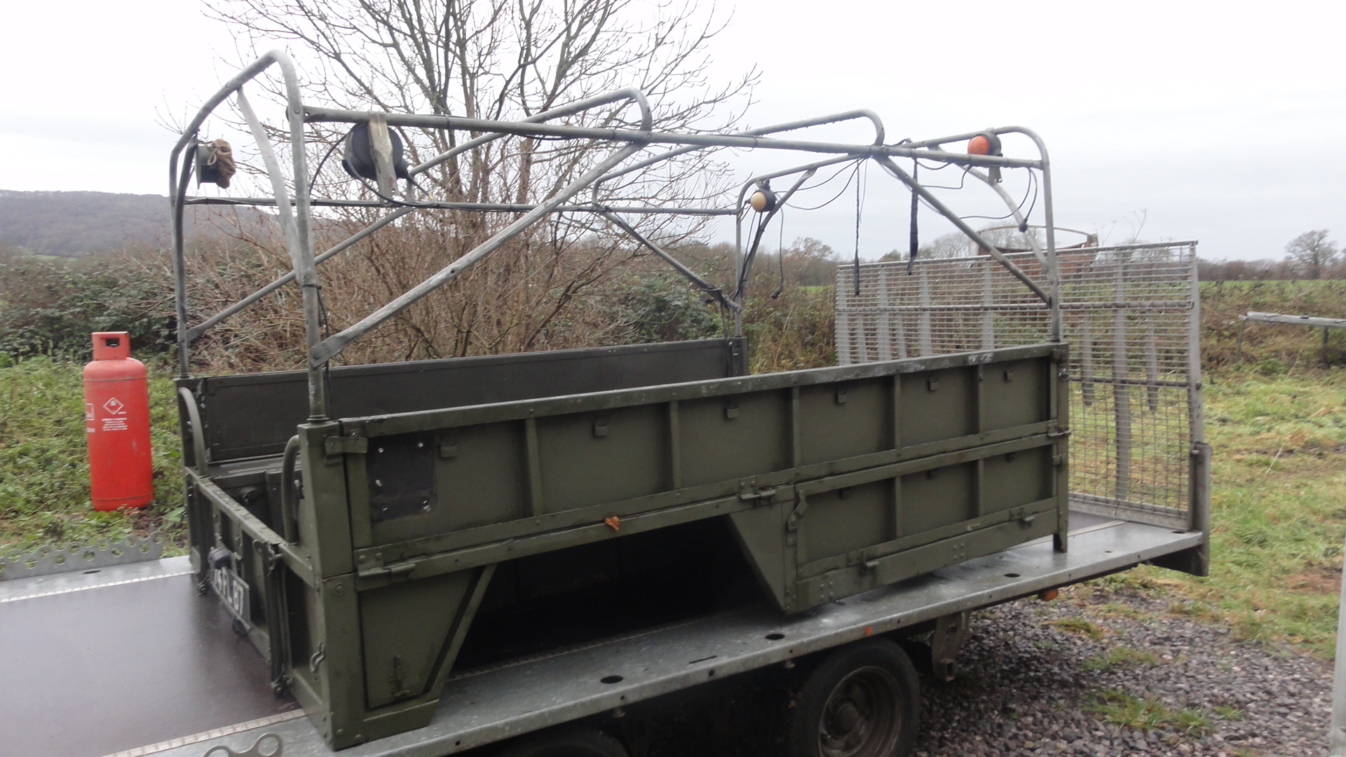

Well i thought i would post a quick up date on the 101 . Picked it up from the transporter at Westbury auctions and towed it home behind the wolf that pulled like a train . To avoid the big hills around Shaftesbury i turned off at the Deverils and went through Maiden Bradley and Gillingham. The 101 had been fitted out as a command vehicle before it was sold in 2008 and was a mixture of clansman and larkspur with a 320 that had been converted to a CB radio . There were 12 sets of intercoms and headsets installed along with a larkspur R210 and other civillian CB and radios .Underneath the rear wheel arches and between the chassis was mounted four 7000rpm fans piped into the rear body that i think the PO would plug gas marks into . The nokken winch underneath had been removed to install the 120 litre LPG tank .To run all the extras that had been installed i found five 12volt batteries wired in plus a 240volt inlet with a 415volt fuse holder containing a 120 amp fuse.I soon made the descision to ditch all this extra equipment and bodge wiring and return it to its original 24volt Rapier launcher spec with winch as per B card.Removed and sold the LPG have located two complete winches for sale one in Holland and one over here so just sorting out a price . Normally they go between £1000 to £2000 a piece .All the extra wiring and radios have been removed plus the 27 foot larkspur mast . Managed to swap five headset and intercoms for a original 101 steering wheel, a set of 101 rain gutters above doors. Spare wheel bracket ,clamp and strap. Also the extra hoop supports if i wanted to fit it out as a FFR vehicle.

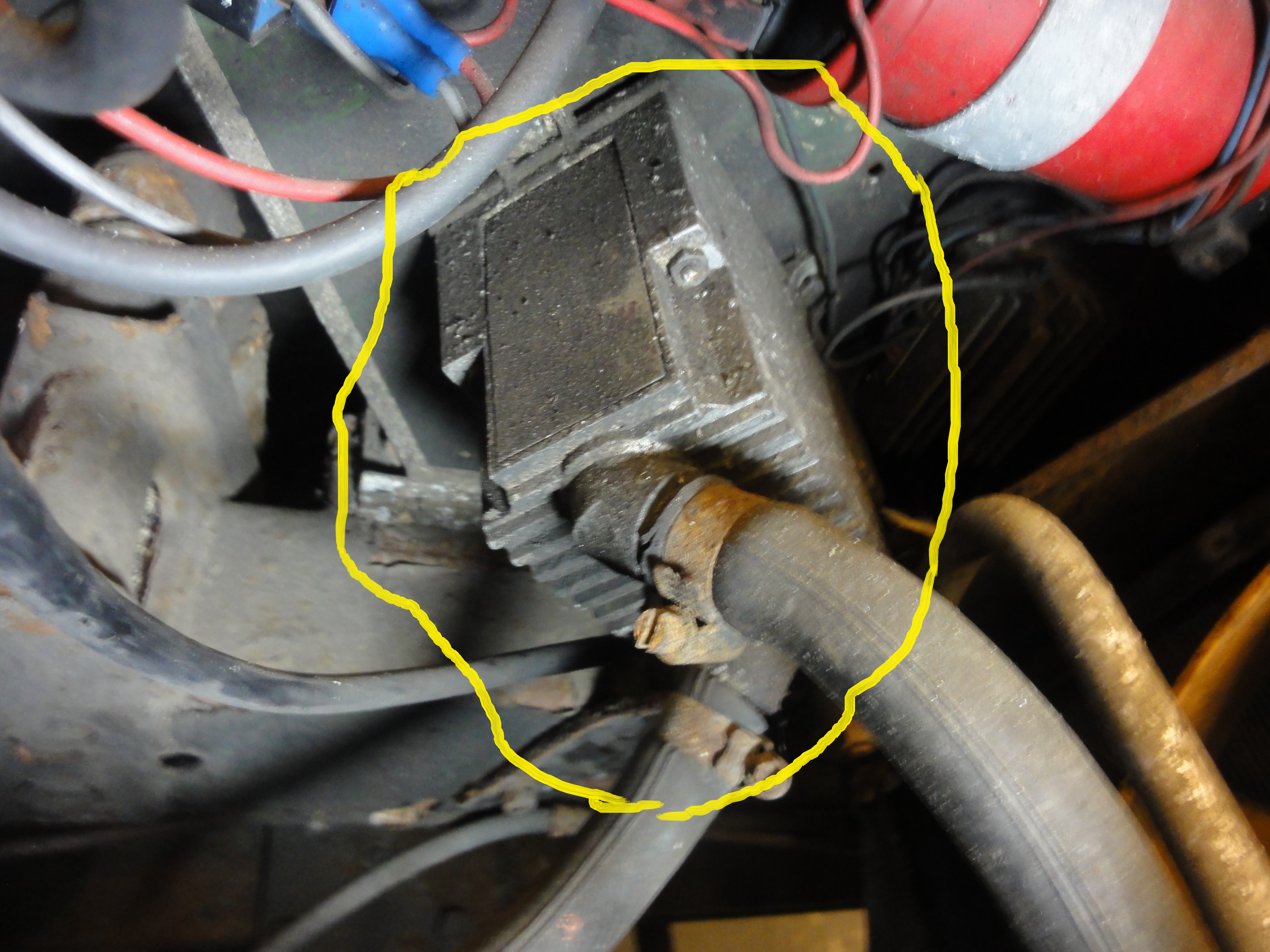

The number 2 outrigger after removing the waxoil and rust has a small hole in it so rather than messing about cutting and welding in patches a replacement has been purchased at £47 so will be replaced . The rest of the outriggers look okay as does the rear cross member . In the last picture highlighted is two oil pipes that come out the engine low down either side near the engine mounting brackets and into this alloy housing mounted inside the chassis , Does anyone know what this is for as i cannot find it in the manual ?
