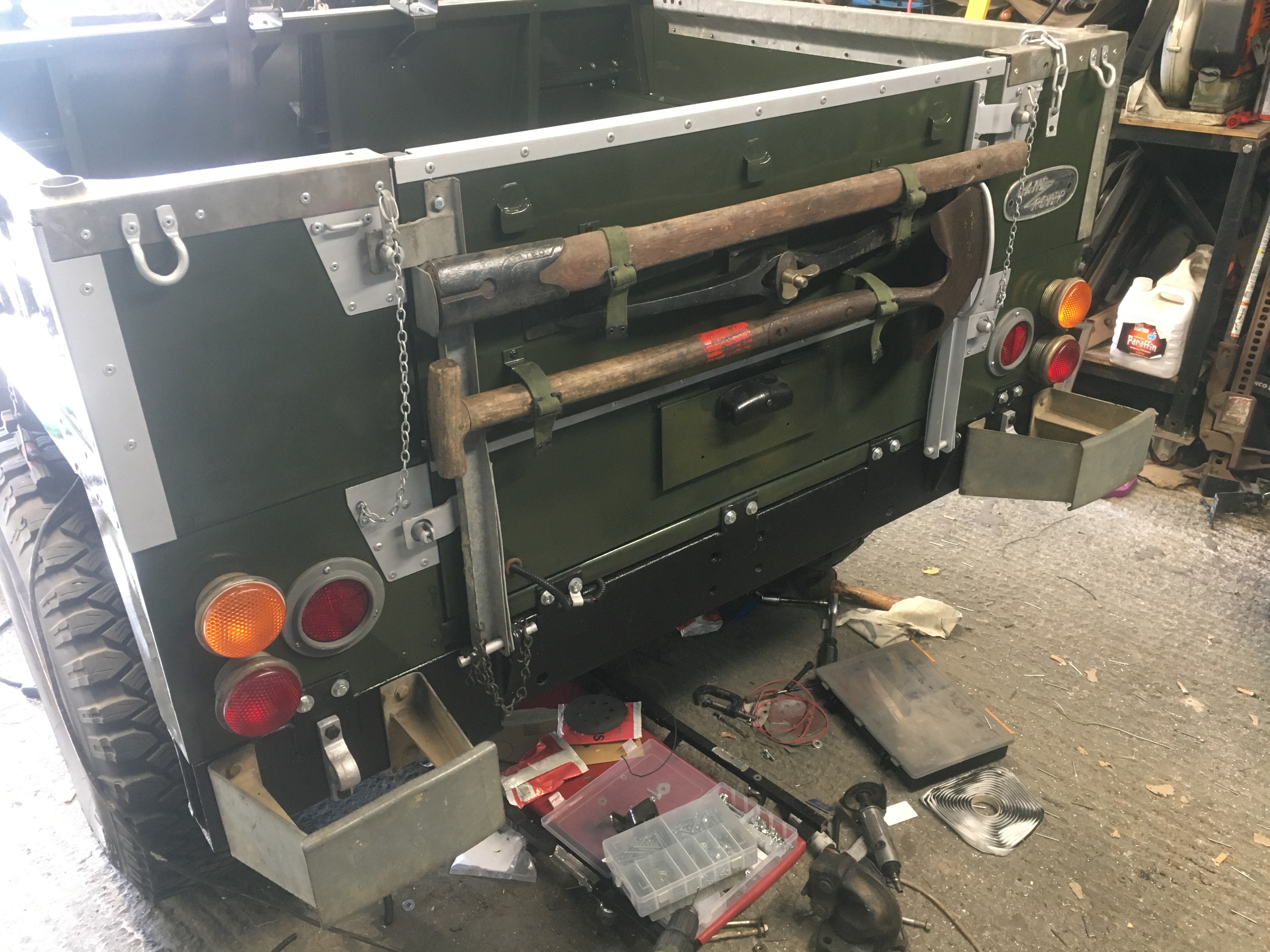

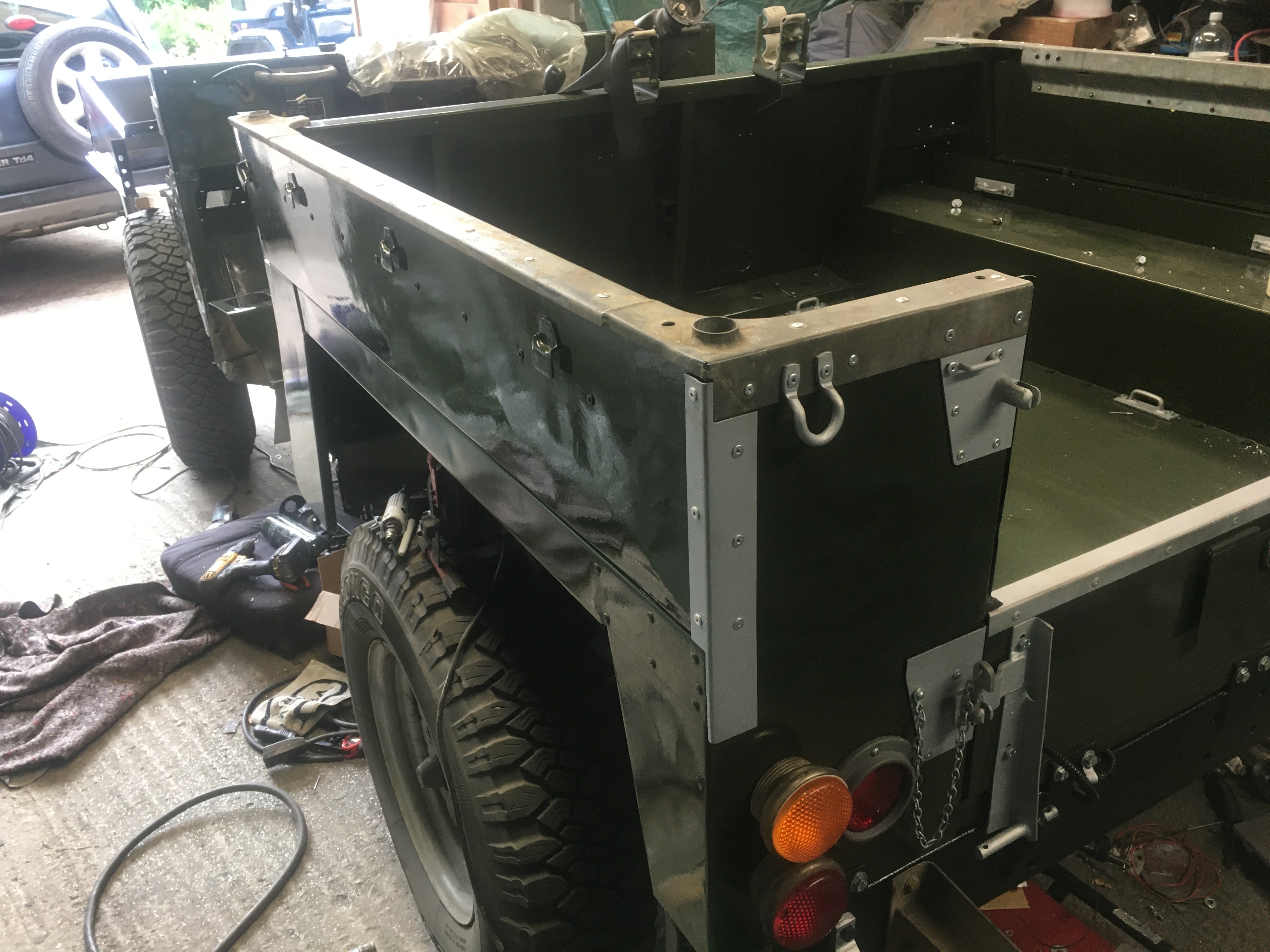

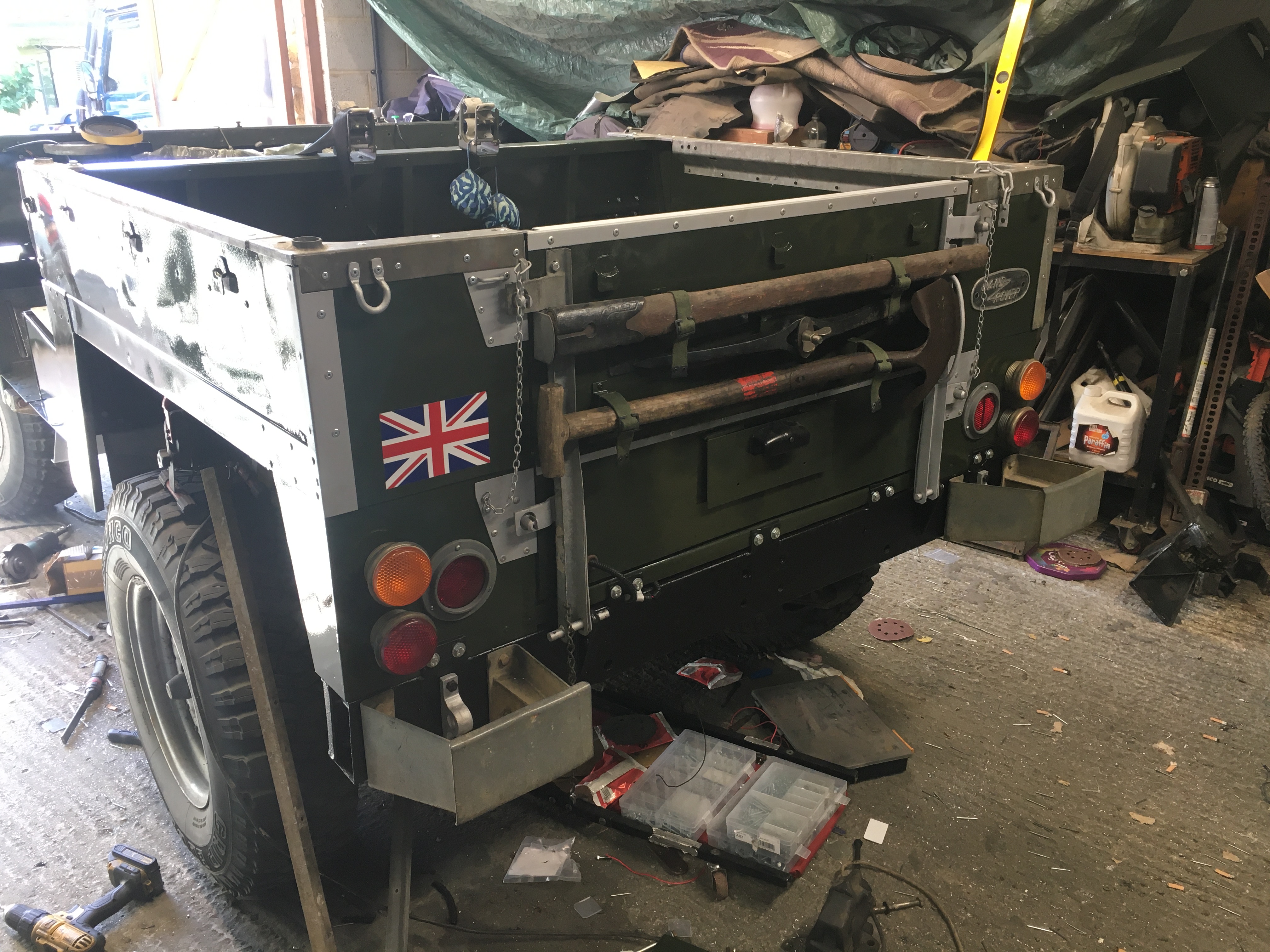

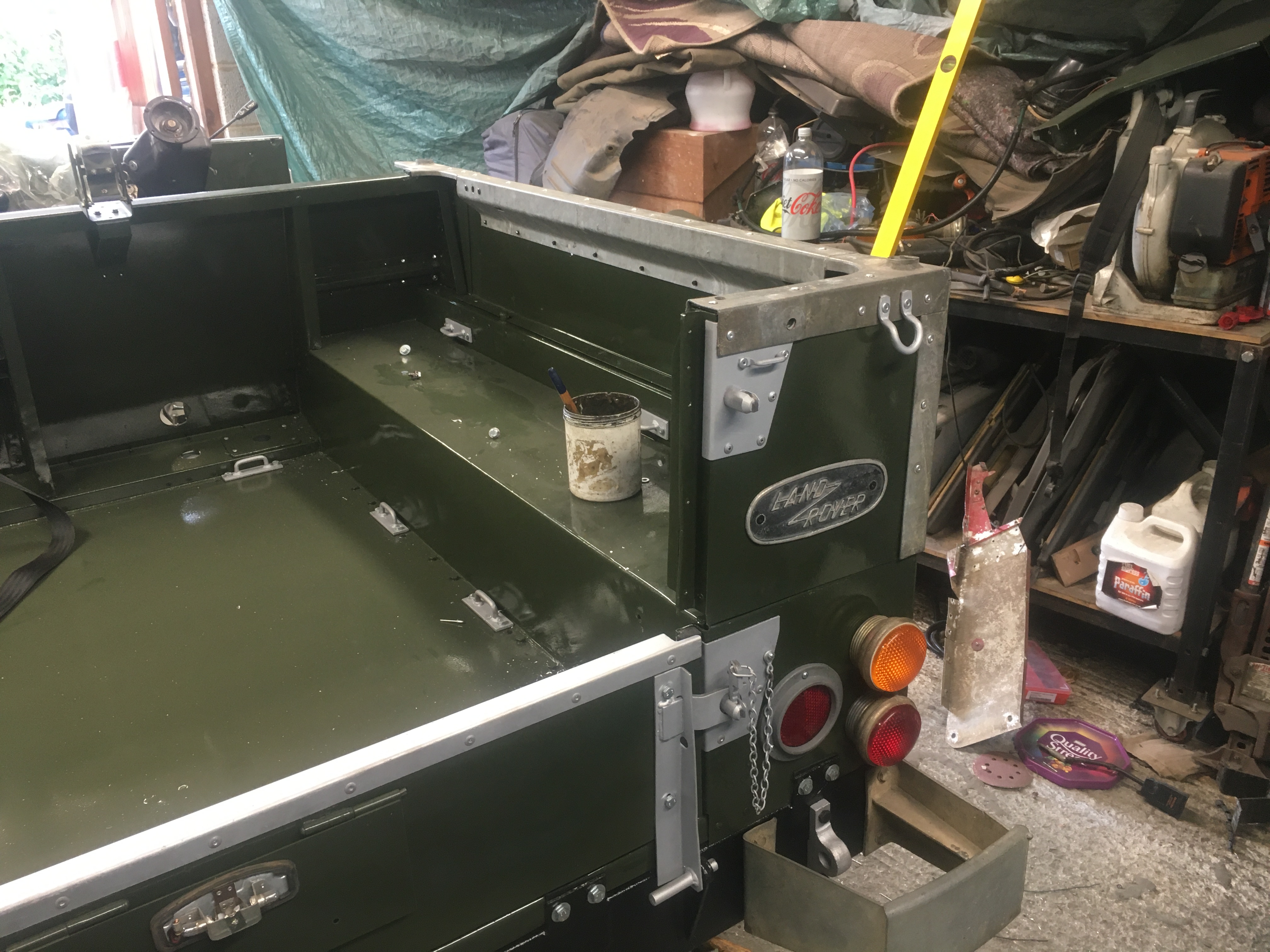

Busy afternoon today and yesterday, air rivet gun is saving a lot of time!
Both rear upper sides fitted, drivers side bolted up for good ( unless I do the strip down in the summer) passenger side is nearly done, just waiting for the door latch bracket paint to dry, then bolt it on for good.
Trial hung the drivers door, bulkhead needs to go back a bit, but the passenger side I Hope is now as far forward as it can go thanks to the exhaust manifold so hopefully will be near enough going by the tape measure!
Passenger side is 5mm closer to the tub than the drivers so should be about right.
Need to order some bolts for the hinge to the door then I can make a start getting it lined up.
Top tailgate fits, got to make a bracket for one chain and order the rings for the hinge chain.
Steel fuel pipe has arrived, just waiting on the pump elbows so I can sort the fuel line, not sure the best route yet tho.
Will try and get power to the electrics hopefully tomorrow so I can then fit the arch tool box and the wiring cover, fingers crossed some lights!
Coming along lol
Coming along lol

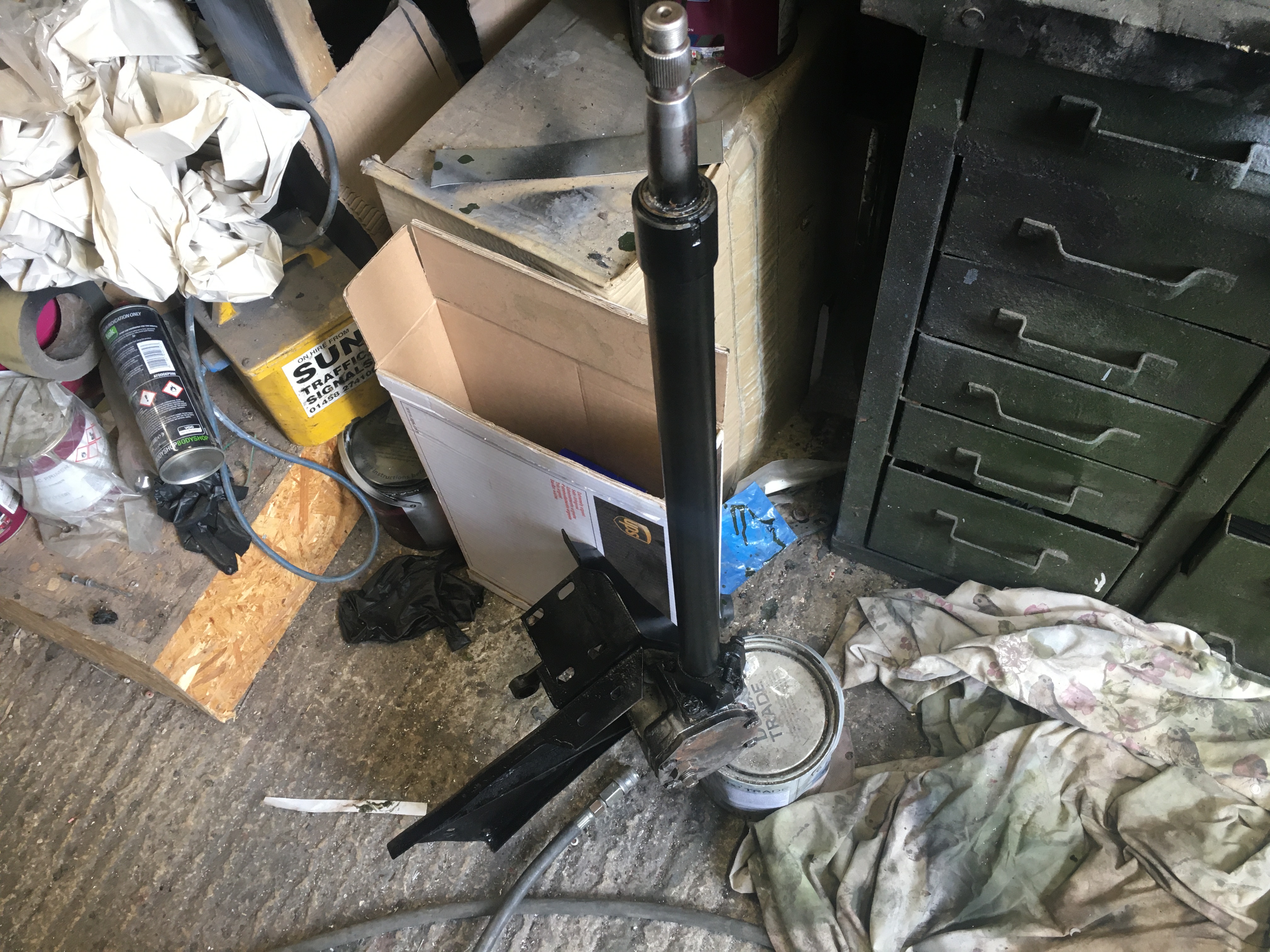

Busy day today, finished the near side upper tub and started getting ready to move the bulkhead about.
I noticed the steering box was very notchy when I was taking the ltw apart so stripped it all off today which will make moving the bulkhead about easier, not keen on loads of money for a new one I thought I’d look at the donors column and box, nice and smooth, as I was cleaning it it was pouring water out of the steering lock hole
so not just a change of oil but a flush needed.
Cleaned up, flushed (loads of lumps of black stuff and water) a coat or 2 of paint and ready to refit, will flush it again after doing some miles.

Think the water got in the column through the steering lock hole, donor was probably 20 years plus in a hedge partially stripped. Fingers crossed with some fresh oil it will be ok, will rebuild the other one as it’s a genuine replacement but abused before my ownership.
I’ve got a random leak on my 90, water gets in but only facing up hill, not when driven or parked facing down
110 leaks like a sieve
Freelander is as dry as a bone
Amazing where / what it gets into tho.

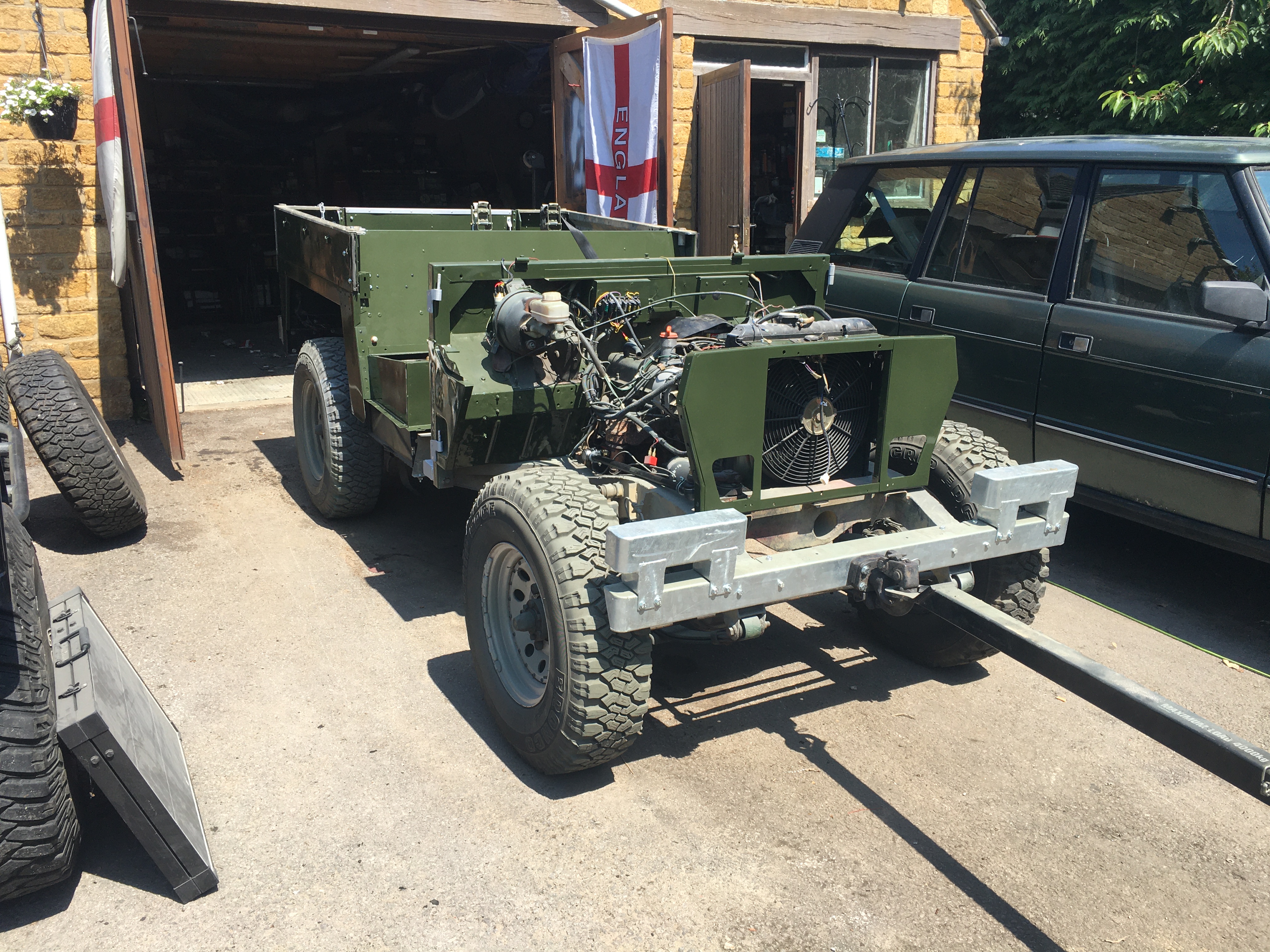

Hi all
Hoping to get the (more) welding done in the next few days, then try and get it back together
Dragged it out into the sun so I could sweep the floor and have a tidy up, really looking forward to getting mire panels on!

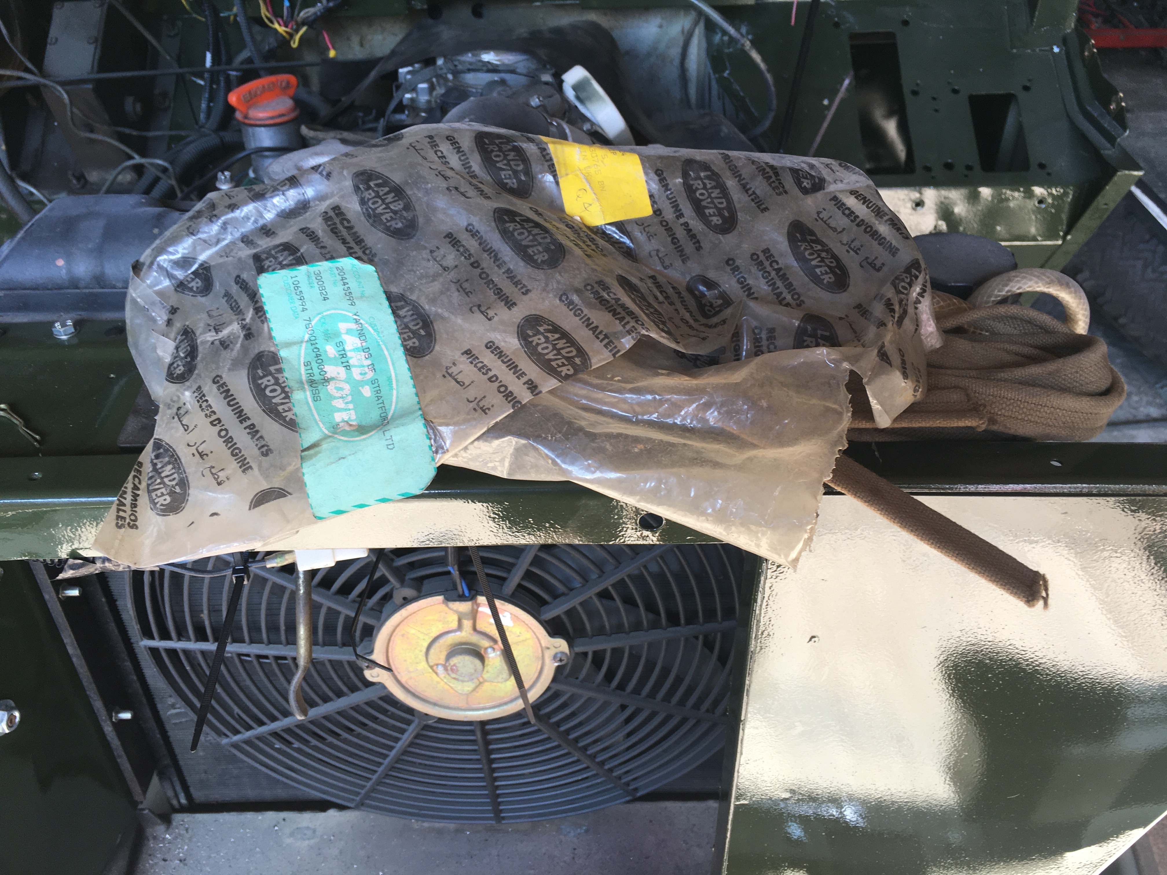

Not much progress in the last few days, got a lot going on plus waiting for the outrigger to be tweaked, tinkering.
Found some genuine bonnet rear strip in a bag on the shelf that I forgot I had which is a bonus, got to wait on the bulkhead before fitting the wings so I can fit it right.
Have cleaned up the tank change over switch, changed the gasket so waiting on one new switch ( only 1 tank for the moment) that will let me wire and plumb it all in.
Does anyone know ( or have ) the length and union size for the second tank? Want to run the plumbing then wait till funds are good to get a second tank in.
New galv vent panel has arrived, looks very good so far, have swapped the modulars onto the 300 110 ( looks so much better) so I can paint the standard wheels once it cools a little.
