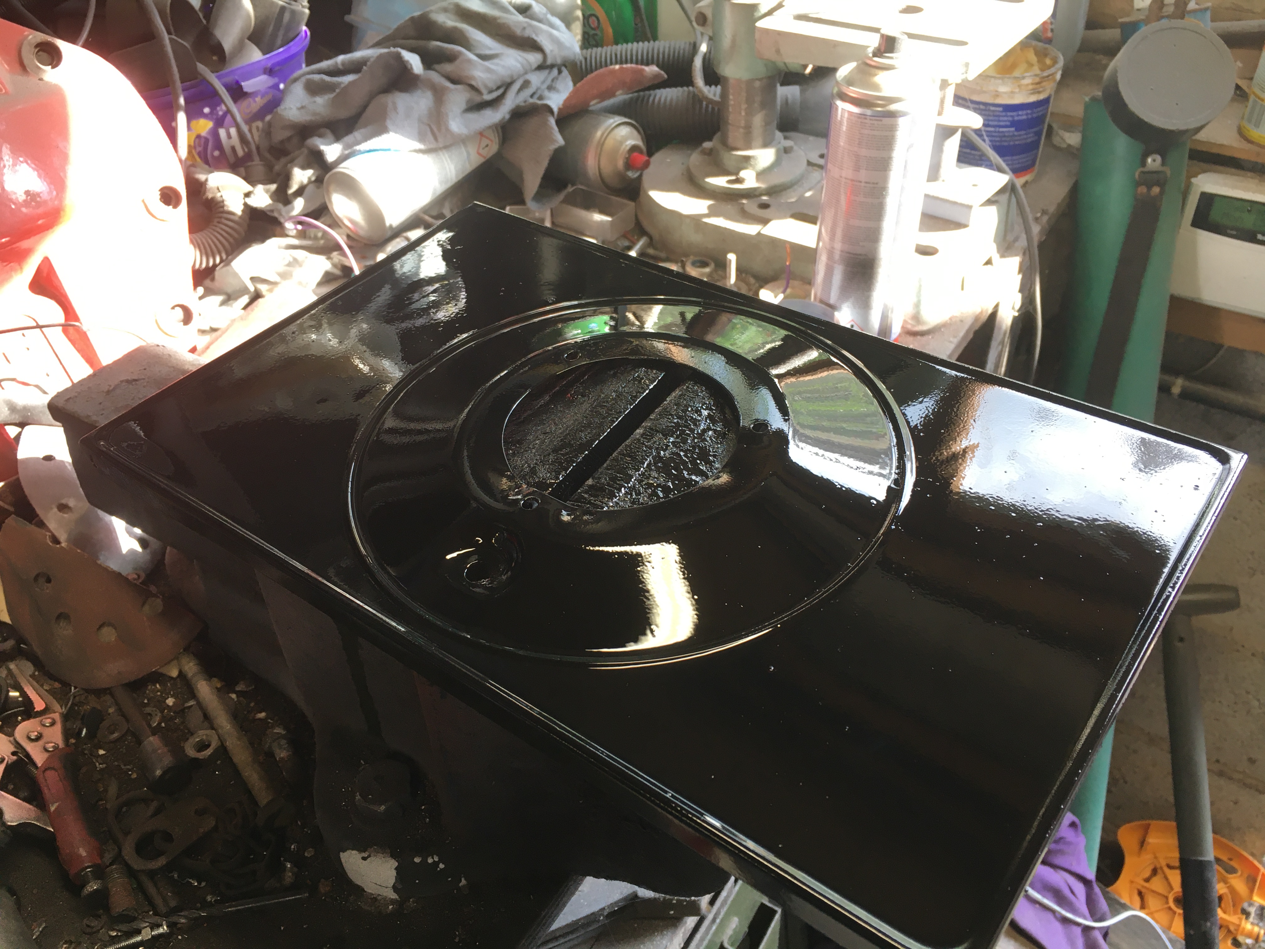

Tinkering waiting for paint on the last tub bits to go off today, got to do the inside faces but nearly ready to start putting it all back together.
Wired up the rear lights, not tested but they worked before ( famous last words I know) Now done with correct bullets not multi plugs.
Fitted the new reflectors, eyes peeled for white ones still.
Drilled the holes and fitted the lifting eyes, chassis was missing the holes along with towing electrics
Fitted the bumperettes, they are bent and buckled but with the price of new ones they will do!
Few coats of black gloss on the heater, I may even plumb it in for the first time in 20 years
it will have 2 speeds again for the first time in years.
Does anyone know the correct bolt size for the NATO hitch? Local place is getting bad for bolts and had to make do for the lifting eyes

Have worked out that I’ve got to move the bulkhead 5mm forward on the near side (needs to go around that sideways too
) but can’t move it due to the exhaust manifold, think I’m going to have fun with the doors, they didn’t fit well before
