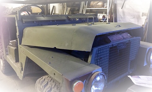

Well it does seem an eternity since my last post...
I dont think there is a single inch of this lightweight that hasnt been burnt, bent, bodged, riveted, or covered over with a vale of mystery.
But on the positive,things have been moving along nicely, aprox £**K of parts and a year and a bit later its now 99%
Nearly completed the IRR green with 2 coats done, just needs overall top coat and sealing, most of the "interesting" camo effect has been removed
its just visable on the front of the bent lightboxes
.. it starts, stops and drives great.
loom rebuild and electrical issues 99% done, dashboard is re-installed and working, although I need to source a new Left hand Aux panel that hasnt had a rectangular hole and Cig lighter cut in.. - I know I shouldnt have an IR switch, but it makes a cool looking cut off switch for the coil!! Fuel tap rebuilt and re-enstated, although one tank has a weep, but all the extra pipework (made from copper brake pipe) and the electric fuel pump etc is removed. Now to my next issue!

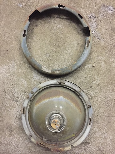

Having removed the headlamps from the front and finding some more damage, a sheet of ally glued to front of the lightbox, and dubious reivetting within the rims I am looking for advice..
one side is missing the spring that holds the bulb in the reflector and has separated rings that hold the lenses. Where can i source parts from to rebuild, or is it a replacemet job. I cant find separate parts info anywhere...
Body wise, just the doors, locks and seatbelts, then fit sticks and canvas to be nearly complete for the spring. - outside photos to follow, when the weather gets better!
any help or info on the headlamps greatly recieved..
Apart from the spring, which bits might you be missing?

Hi mate,
its the 3 clippy bits that join the rings together, look like this i think, (picture found on the t'internet.) do you have a lead on any, they seem to be NLA at landrover dealers.
A

I may have 3 of the clips you are looking for. Jim

I can bring various headlamp parts to Gaydon or Overlord if you can wait that long.
Re: Project 56-KB-23
Not got anything like those, but have a selection of the rings for holding headlights. When I get a chance I'll photograph what I have, but it won't be until after the weekend now as called away on grand parenting duty.

Those clips are often on eBay - but for a ridiculous price. I'll have a look at Malvern next month - that's where I got mine last year.
