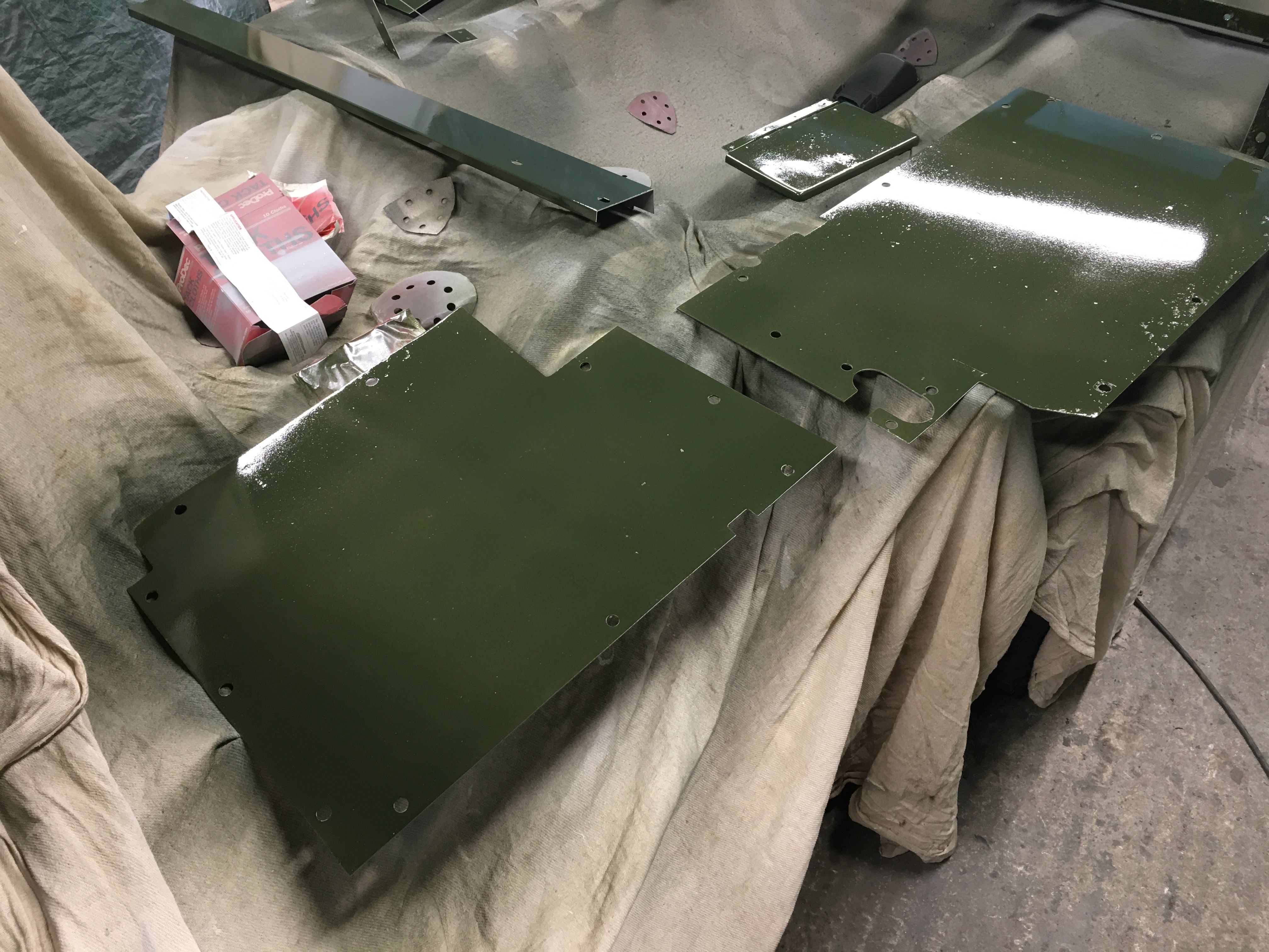

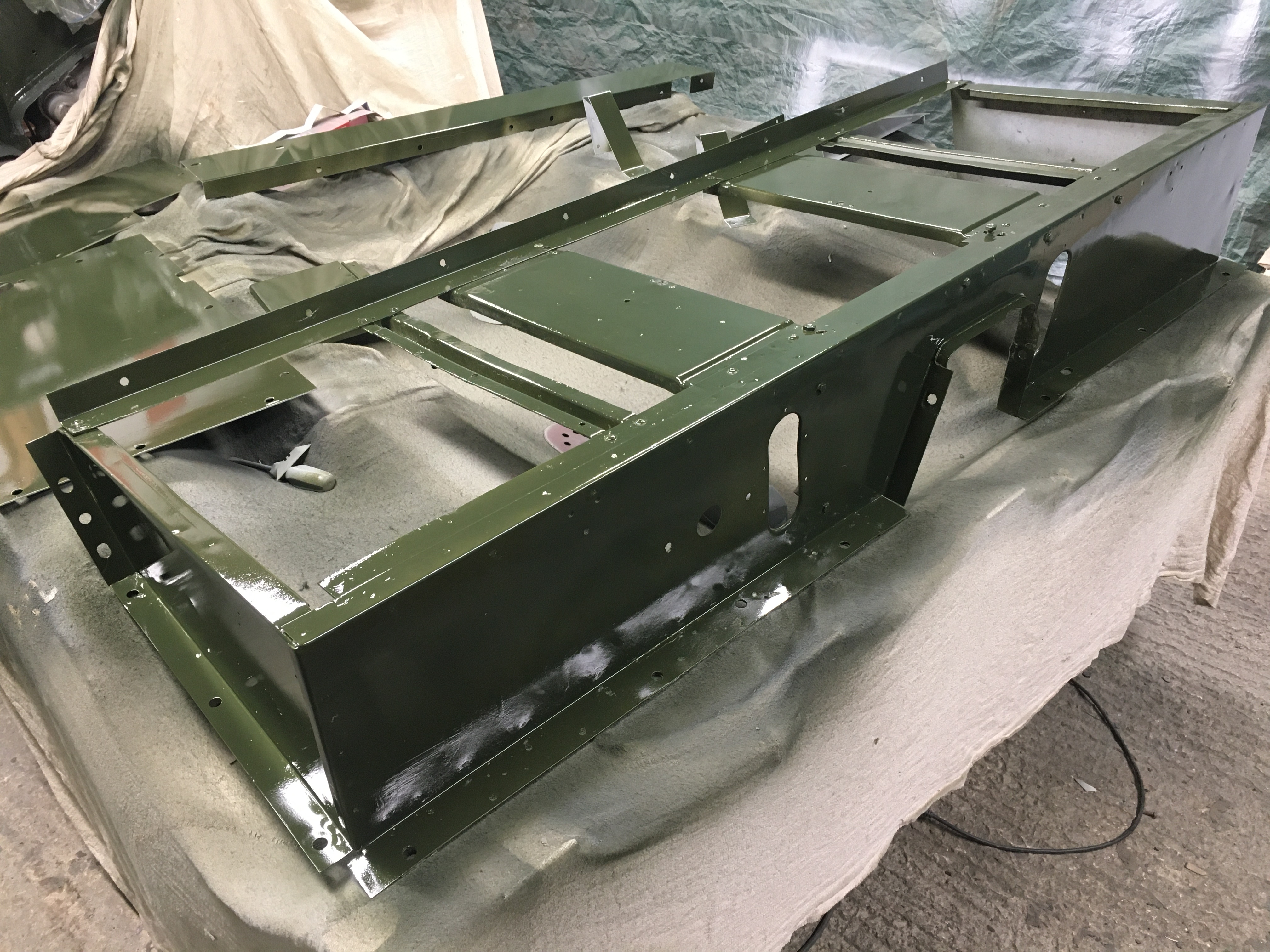

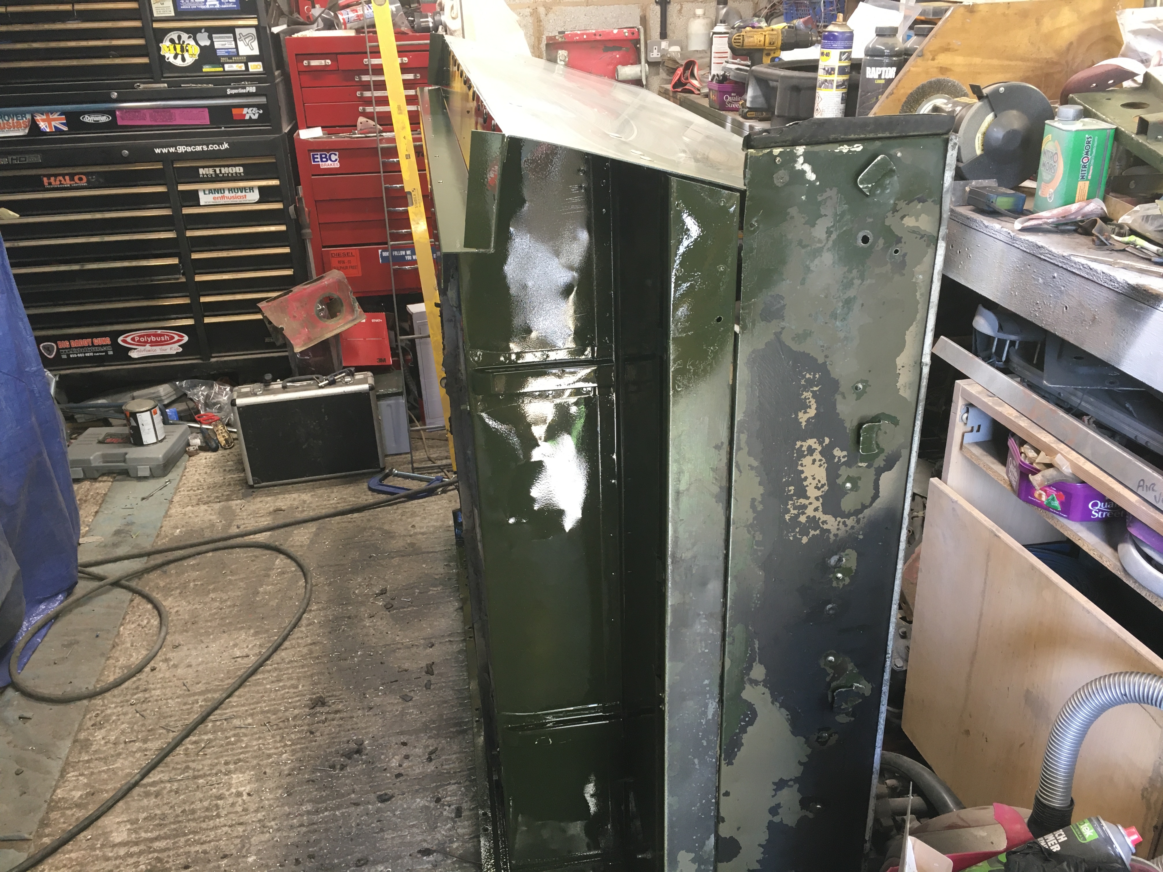

Nearly there with the painting, going to undercoat the underside of the tub tomorrow ( might first coat it later) then I can put the first coat of green on on Monday.
Few more bits to come in the house on Tuesday, then I can start putting it all back together
Donors front wings looking much better, surprised I got the off side one as straight as I did, they gave less holes in than the original ones.
A few issues to sort, including fuel pipe, battery cables etc. Thinking of using copper for the fuel pipe as it holds its shape, but I seem to remember that if it’s copper nikel it can cause issues?

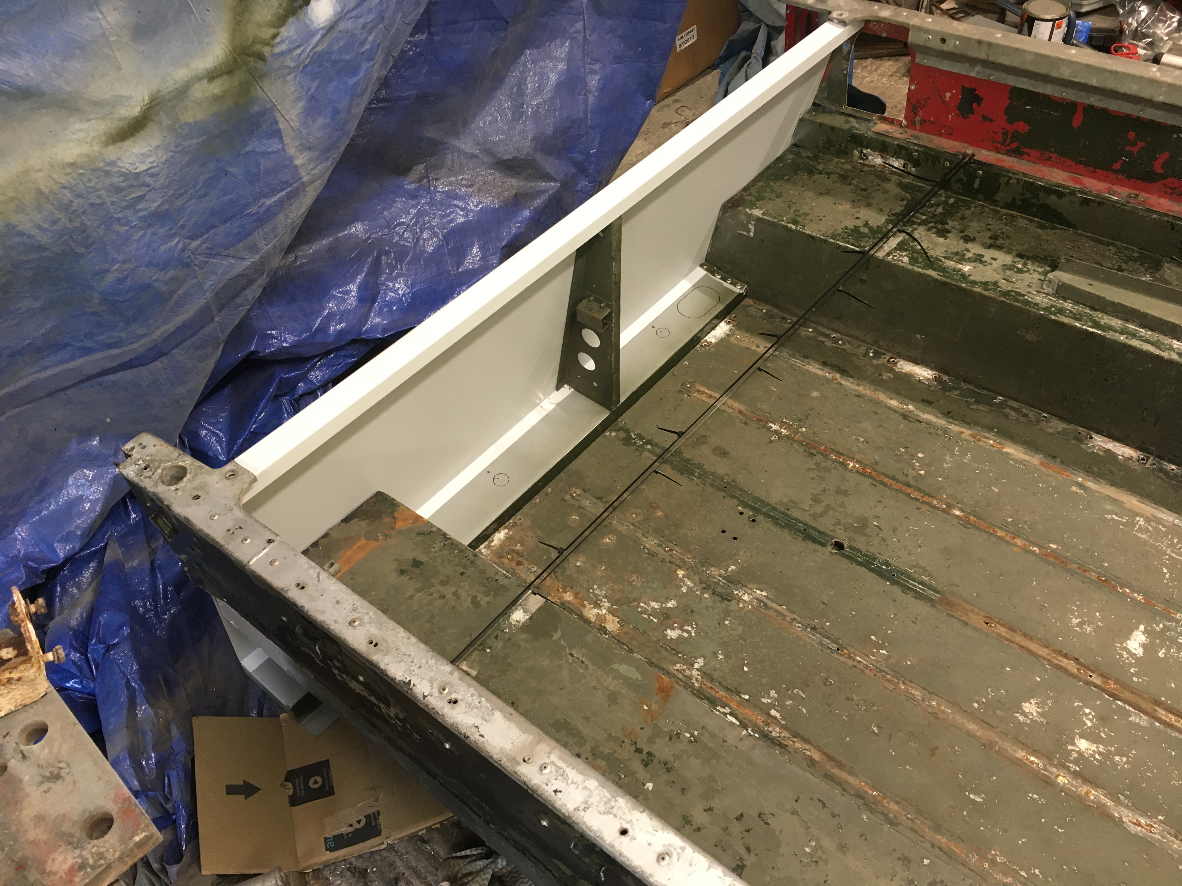

Productive day so far,
Crossmember marked up and fitted to tub, tub bulkhead trial fitted, tub squared up to it, drilled, glued and riveted.
Great fun trying to get it all squared up with not the best upper sides!
I bought some rivets last week but they were too short
so had to use some large head rivets, not that bothered as seats will cover the heads
First coat of green on the wheel wells, will second tomorrow and get organised for the new floor supports then fit the new floor.

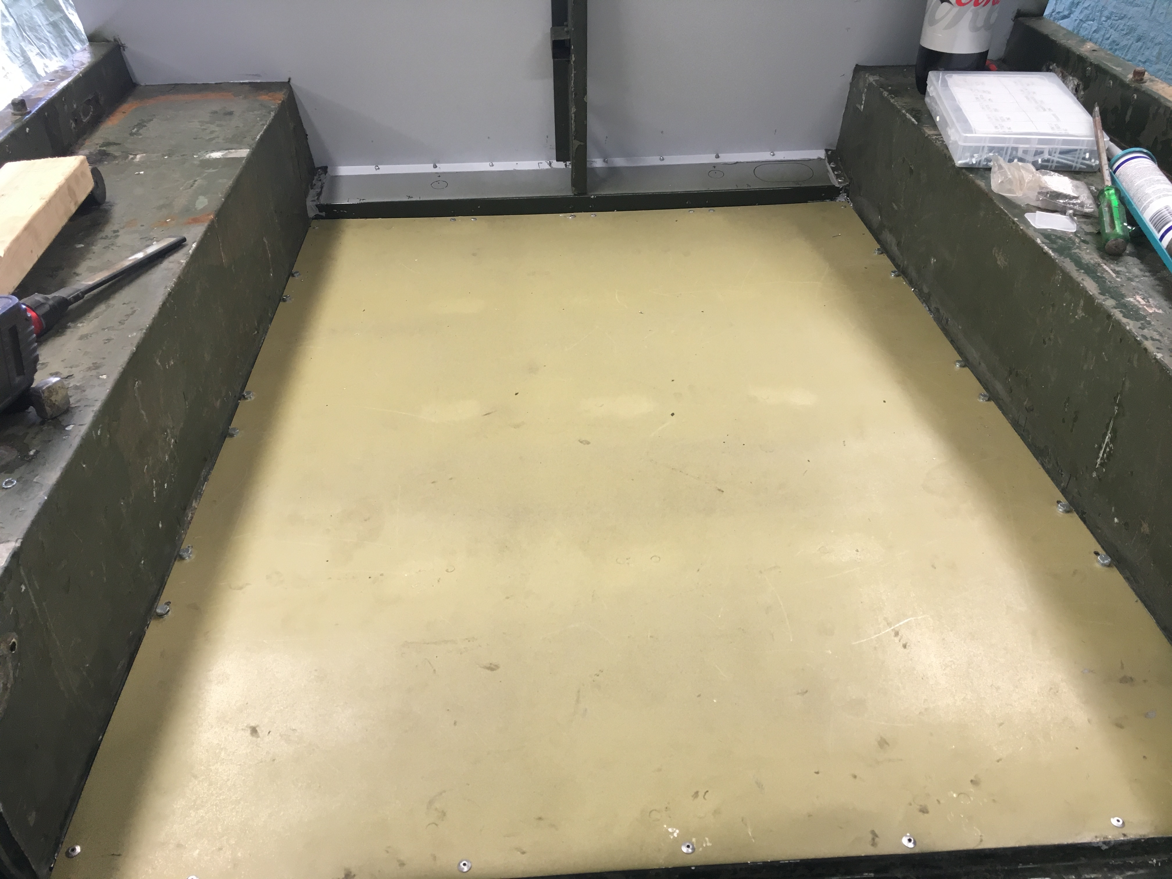

Busy day today, tub on, floor in, great time to find that the chassis isn’t the squarest
Still it’s on, front of the tub needs to go over a bit to line up with the bulkhead but due to the rear crossmember being out it’s not a problem with a spacer or 2.
Chassis is an old galv one from the early 90s so nothing on it is quite right
Yes I’ve put a line of rivets along the tailgate end of the floor, try to keep it a little more weather tight and the new floor supports came from britpart...... and galvanised........

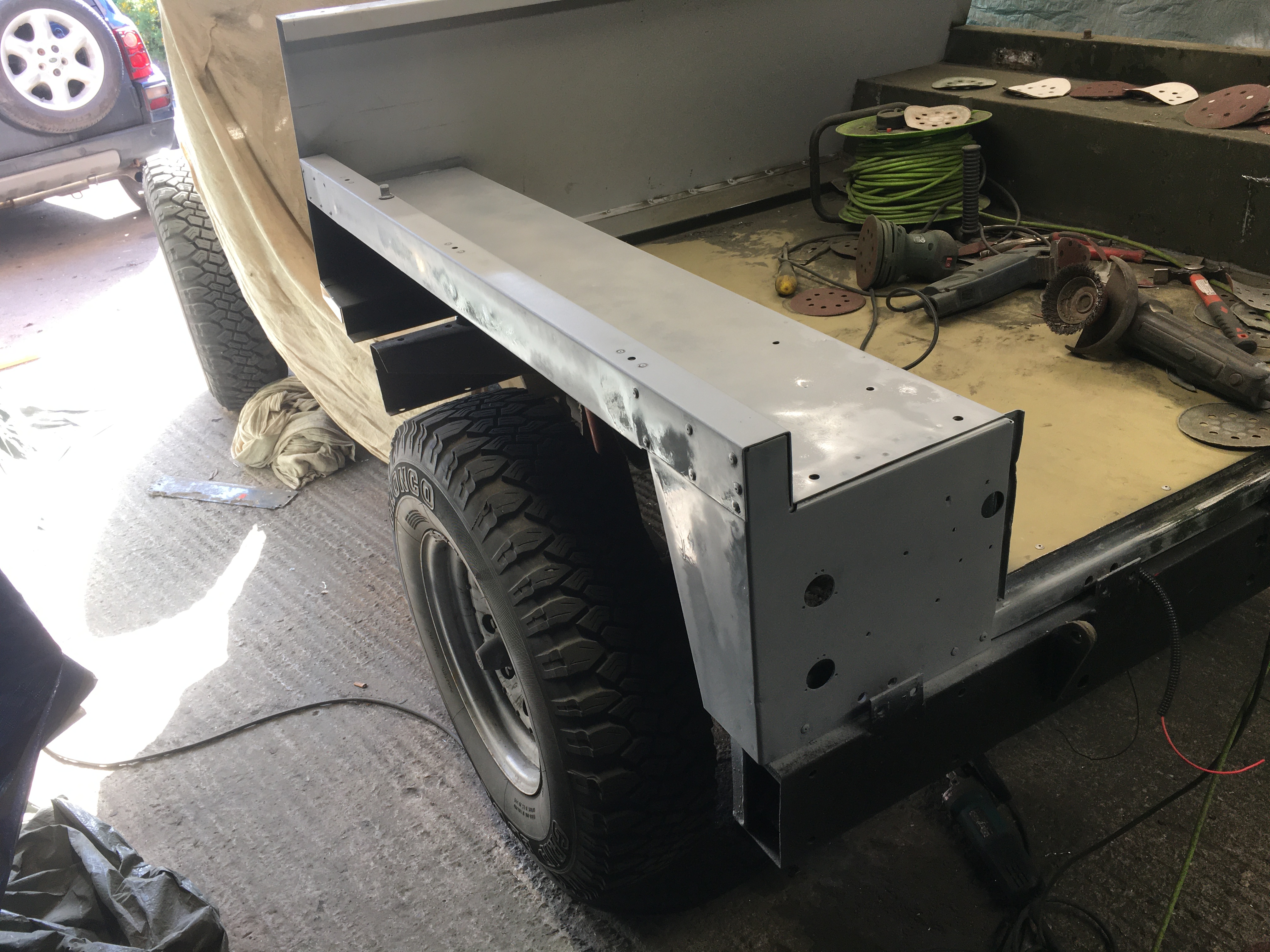

Getting there with prepping for paint, had a fun morning with a tape measure on the chassis, fairly sure it’s bent due to previous owners airborne antics at off-road events etc
re chassis next year unless I can shim it. Doesn’t help that all the outriggers are different sizes, bulkhead does need moving but not front to back, it needs to go over to the near side by 3-4mm.
Wondering what the paint the donor was done with, one side of the tub took 2 hours
paint sparks with a wire wheel and it goes almost the colour of a pink panther 2a at the first hint of sand paper
Will get the other side prepped tomorrow then hopefully primer and under coat over the weekend.

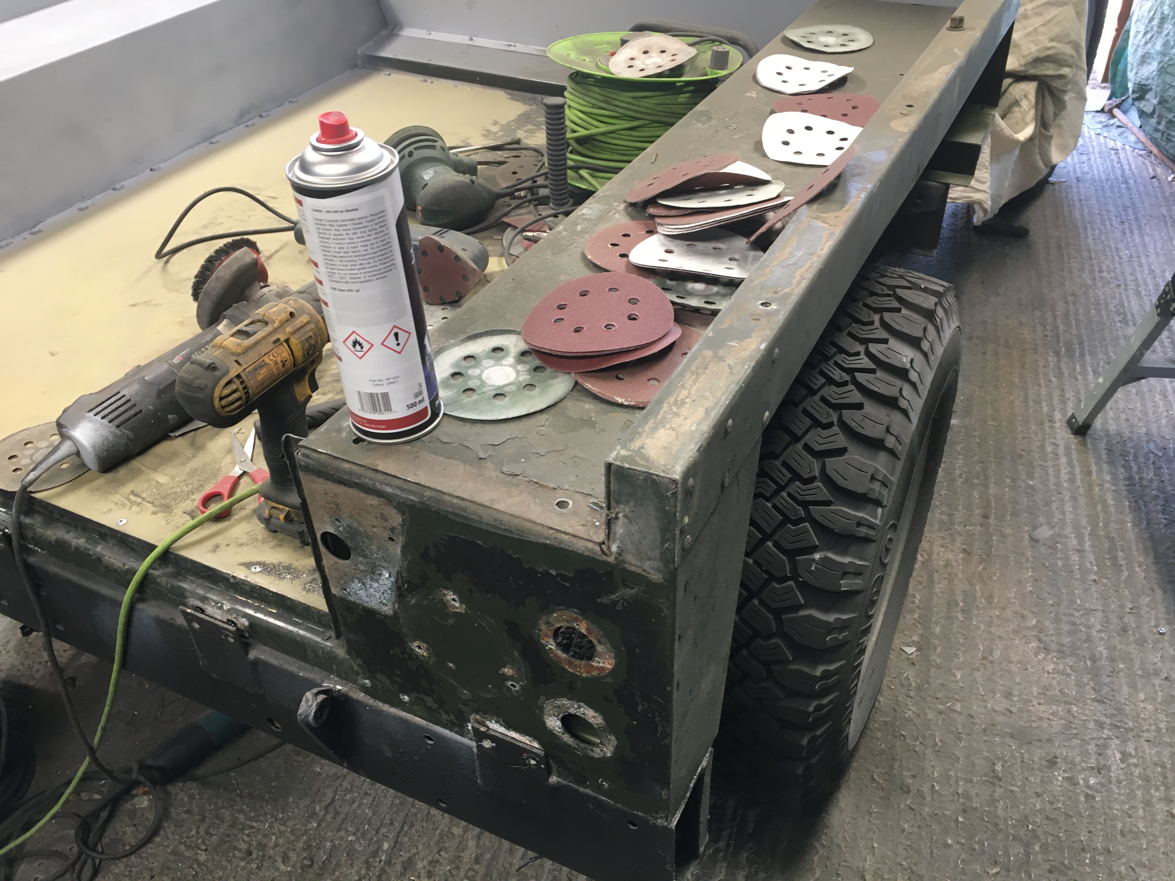

Finished the last of the big bits today ready for filler later, make some big holes and then the first undercoat tomorrow, then fit the reinforcements to the front of the tub for second undercoat. Hope I’ve not missed too much on the prep side of things
Fingers crossed will be able to start bolting it back together soon
Found some numbers on the offside didn’t see any on the near side tho, tyre pressure?

Re: 19FM37
Yes, normally there tyre pressure is written there in the middle over the rear wheel / axle
