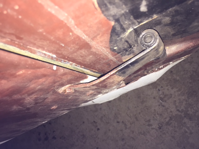

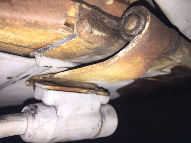

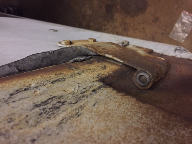

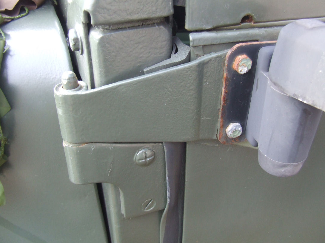

Some piccies of the hinges for you.
Nearside Lower.
Nearside Top.
Offside Lower.
Offside Top.
Hope this is of help to you.
Regards, Norman.

thanks for all the photos, most helpful! My hinges look like barrels compared to them, (pix to follow).. does explain why the doors dont fit properly though!

well having looked at the hinges on my truck, I now know why the doors don't even come close!
top ones got more barrel than a howitzer! bottoms look more like the ones you kindly photographed...

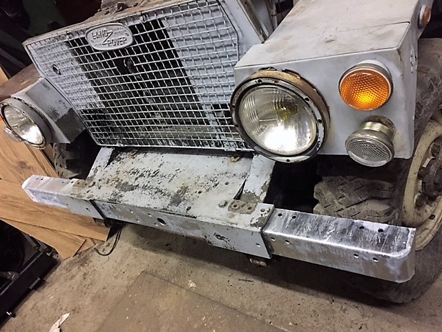

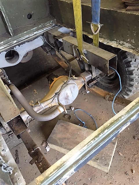

A busy weekend, Friday night, nose job - new bumper for the front,
just need to put bumperettes back

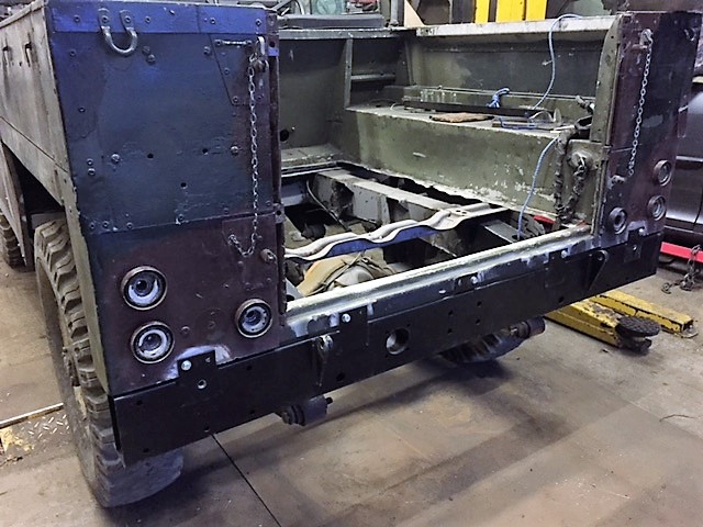

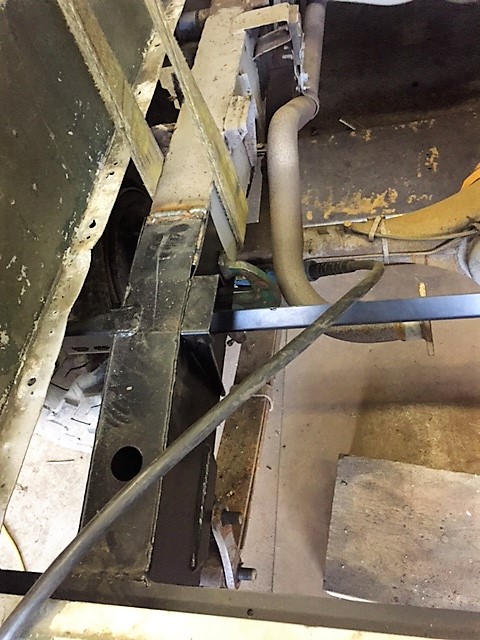

Saturday, tail job, replace rear chassis legs and x-member.
the chop.... partly welded and located and...
3 1/2 hours later...
Re: Project 56-KB-23

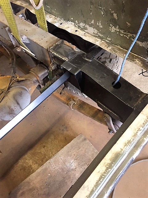

Complete.
now to add the missing re-enforcement spars from chassis to the new x member and fit rebuilt wiring loom, paint it up, and a final bolt down of rear tub lip with some plastic spacers to try and stop corrosion. That is job for Wednesday eve. though (as well as refit the front bumperesttes.)
I must say I am well impressed with the fit and build of both parts, all the bolt holes lined up perfectly.
