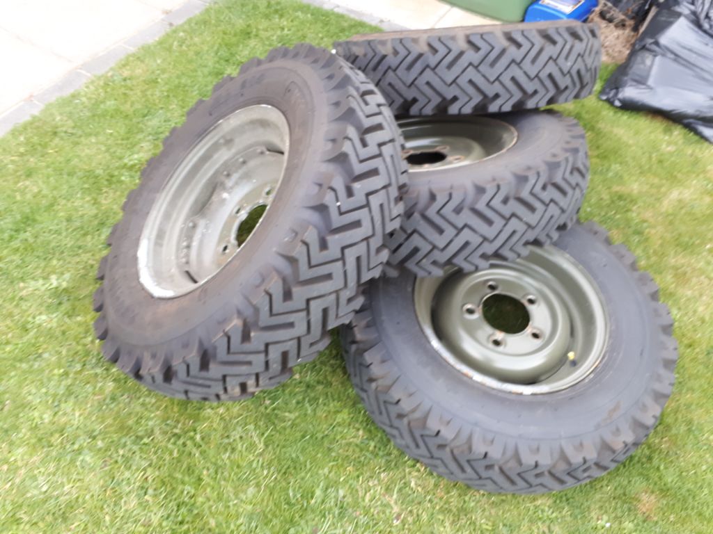

I swapped my extra grips over for my winter 205-18's.Dont want to wear my extra grips out over the winter,the bikes won't be used much now so the lightweight is my only transport to work.
It's amazing how quiet the tyres are but my gearing has gone down due to the tyre size difference.
