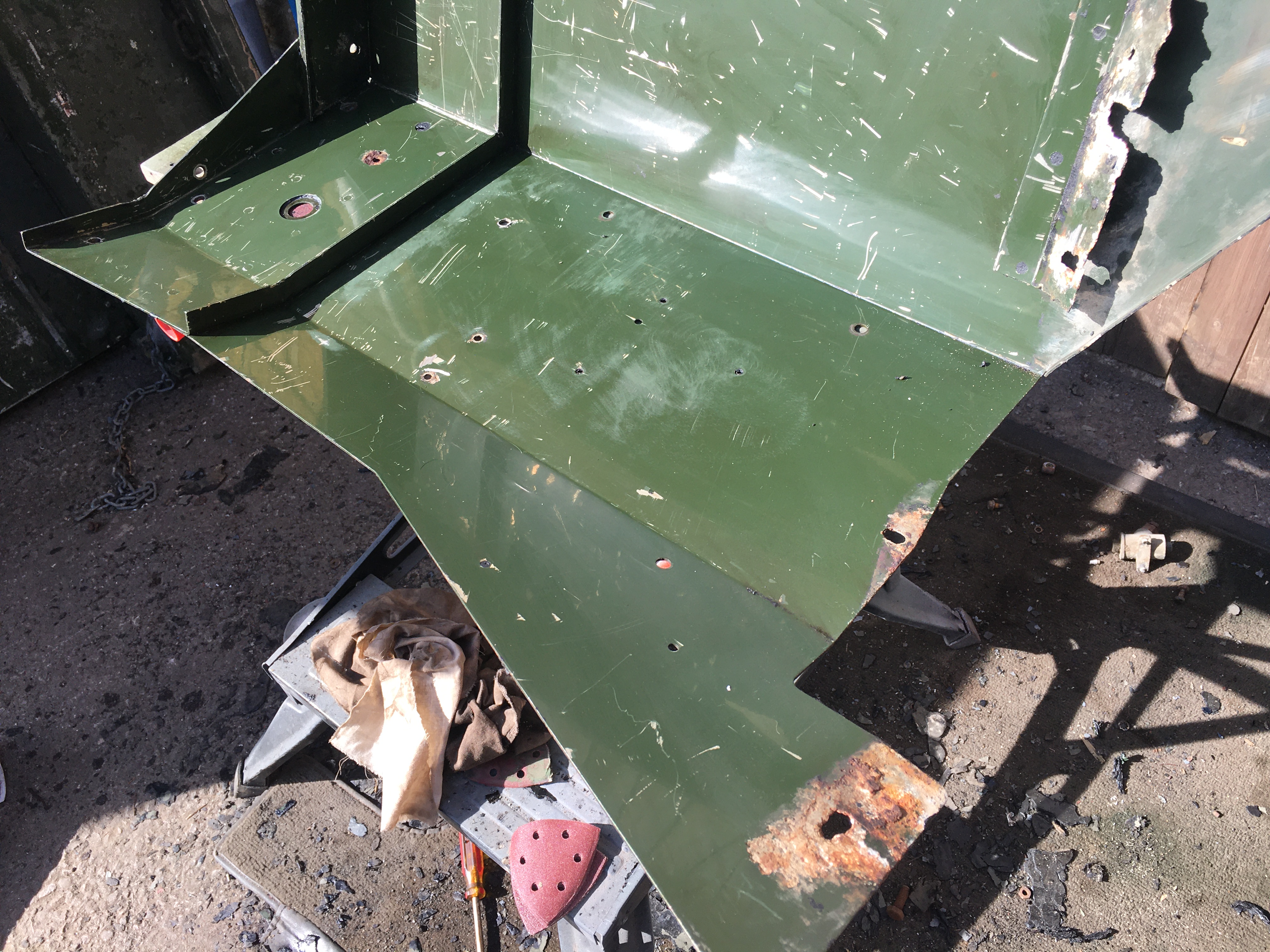

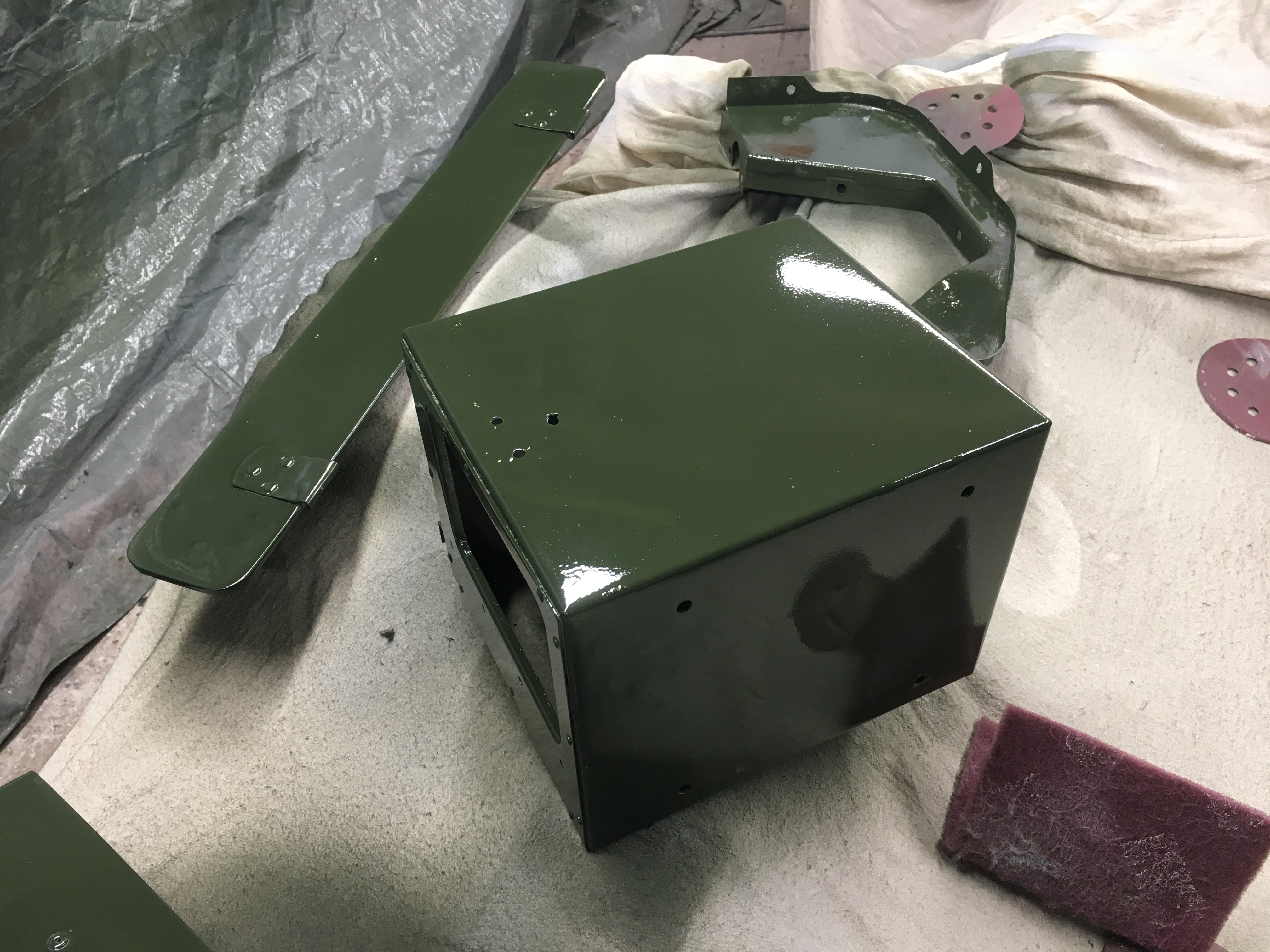

More prep and painting today, first bits are in the house too
Donors front wings are in very good condition, not that straight along the edge along the side but with a bit more hammering and twisting they should be half about.
A hammer, a decent scraper that you can hit with the hammer, a hot air gun and a gallon of petrol got the under seal off the inner wings, I stink now

Re: 19FM37
Looking great! Looks like you’ve got a lot of work on there.. the only positive I can take from this lockdown is all the time you can spend on your landy
Re: 19FM37
It's brilliant when the original paint starts to appear, though isn't it? That's how I cleaned mine and it works really well. One thing which did make me wonder, though, was why there are so many holes in the inner wings! What are they all for? Incidentally, as on mine, your mudshield brackets are shot. I followed Neil's advice and used Tigerseal to fix new, homemade aluminium ones on and that worked a treat.
