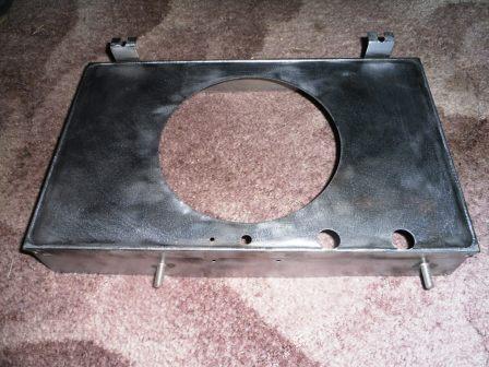

I did a little more to the heater this aternoon. I finished getting most of the paint off the housing, welded in a pair of UNF bolts to replace the snapped studs, and then ground the heads down to ensure clearance between them and the heater matrix.
The only bolts I had new that I could find are a little long, but it won't be a problem to shorten them if I feel the need.
With the bolts welded in, the housing paid a trip to the blast cabinet to get rid of the rust and paint from the recesses before being given a coat of Dinitrol and once that had dried a coat of primer was applied. It's now hanging up to fully dry before it gets it's top coat.

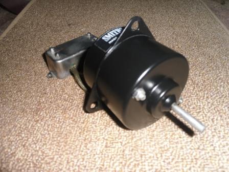

The heater motor also recieved a bit of loving. It has been stripped, cleaned, de-rusted, primed and painted.
I did in the end paint the fan impellor, I sprayed it with a can of cold gavanising paint to give it a bit of protection. I didn't take another pic of it as the colour didn't change, it's just a bit shinier.
Hopefully I can get the heater's outlet flap panels done over the weekend and then the heater can go back together again.

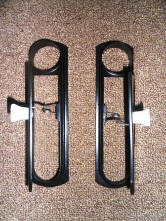

I ordered a pair yesterday as cleaning up the originals revealed them to be cracked, but they'll do for now and the new ones an go into the spares box.
Yesterday also saw the heater casing finished off.

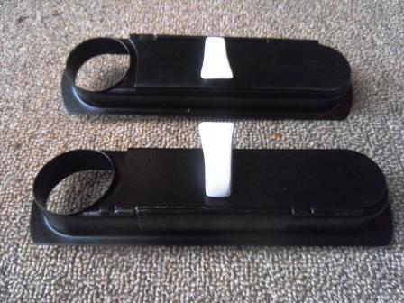

This morning saw the vent panels finished off. They have been stripped bare, de-rusted primed and painted. The original knobs were cleaned of paint and due to being age yellowed were given a lick of gloss white Humbrol model paint before being re-fitted with new springs and catches.
Off now to clean all the hair out of the heater matrix and give that a clean up, then find some small pop rivets for the resistor and cable clip, and the heater can go back together again.
