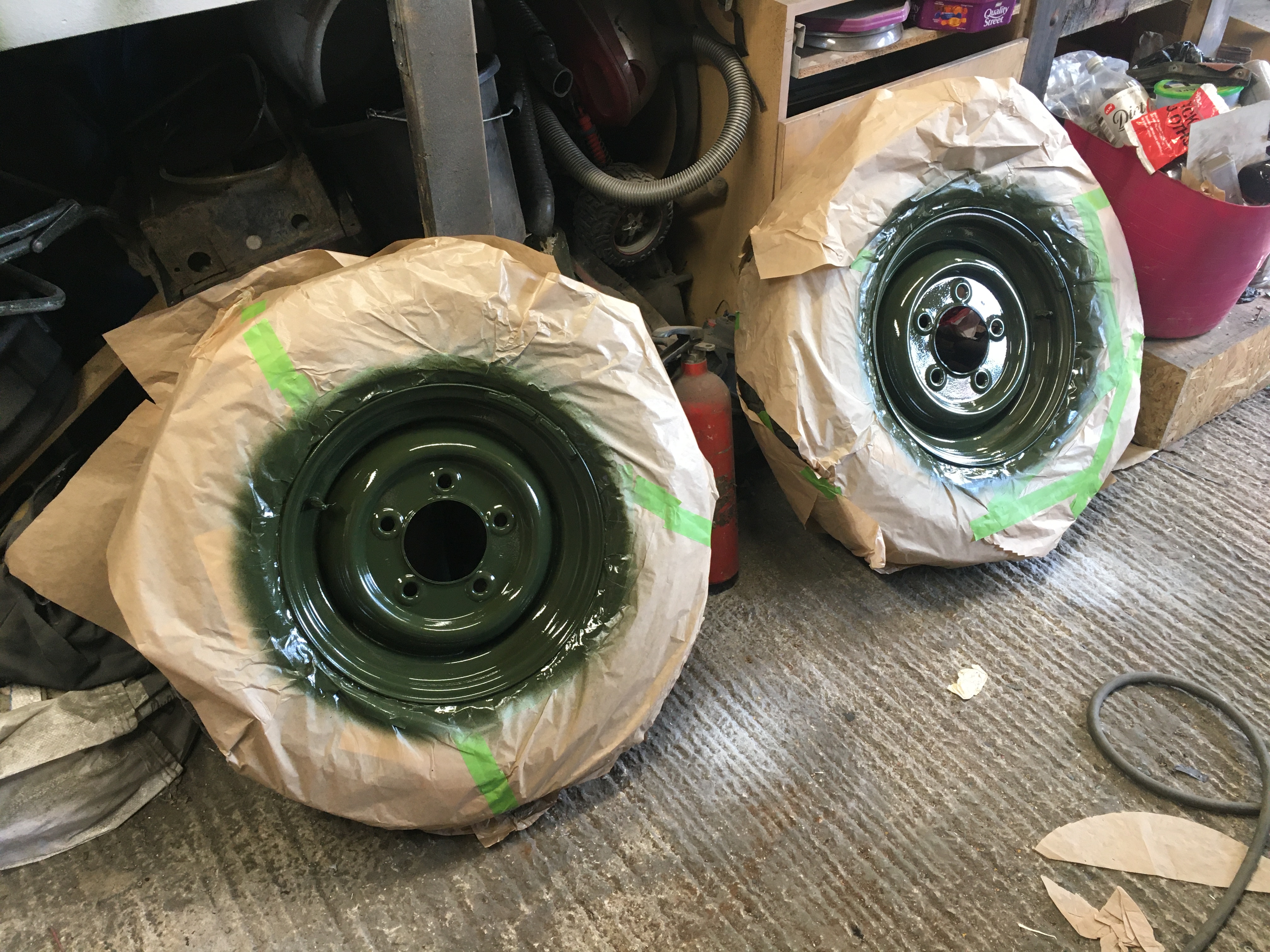

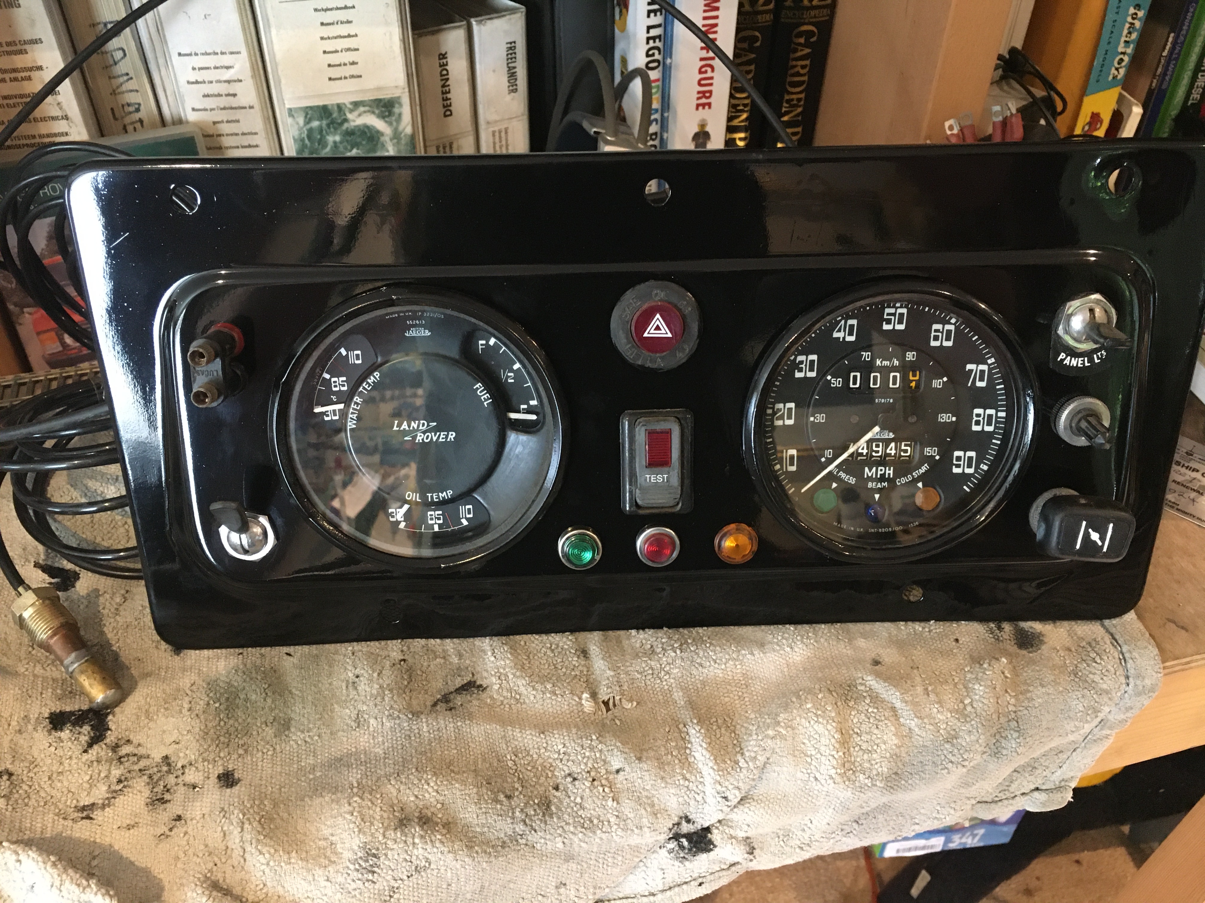

Finish coat on the wheels today, all being well get them on in the next few days, finally dialled the spray gun in with the enamel
, might re-do the wing tops yet, not sure.
Dash is also finished.
I’m hoping that helicoils in the screen hinges might work, if not I’ll use bolts and put a plastic cap on the outside of the hinge.
Got to finish the seatbox, sills and a few other bits then drag it out as wiring not here until September, swap it with my old series 3 so I can finish that for mot, then I can start on one of the 110s.

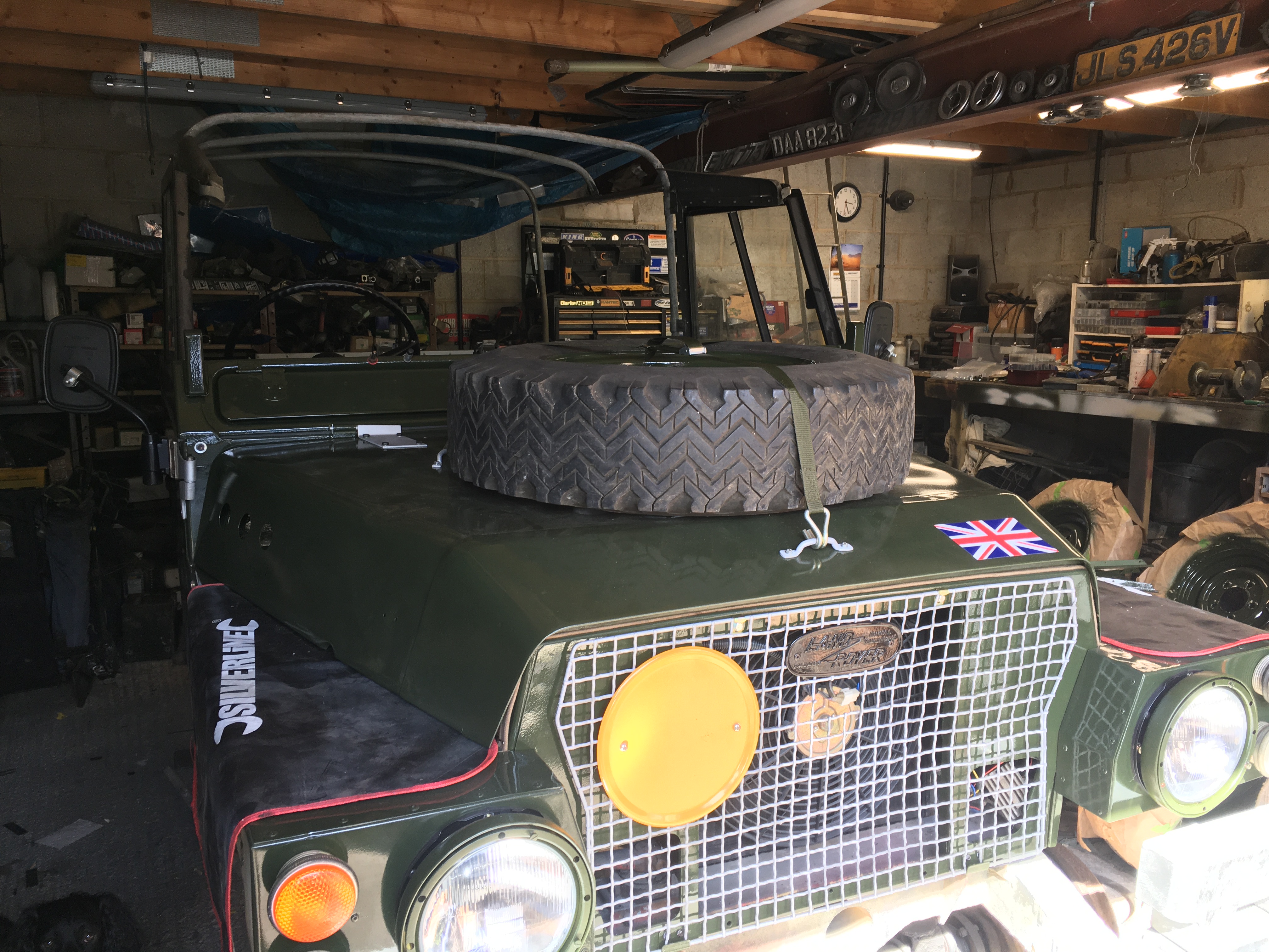

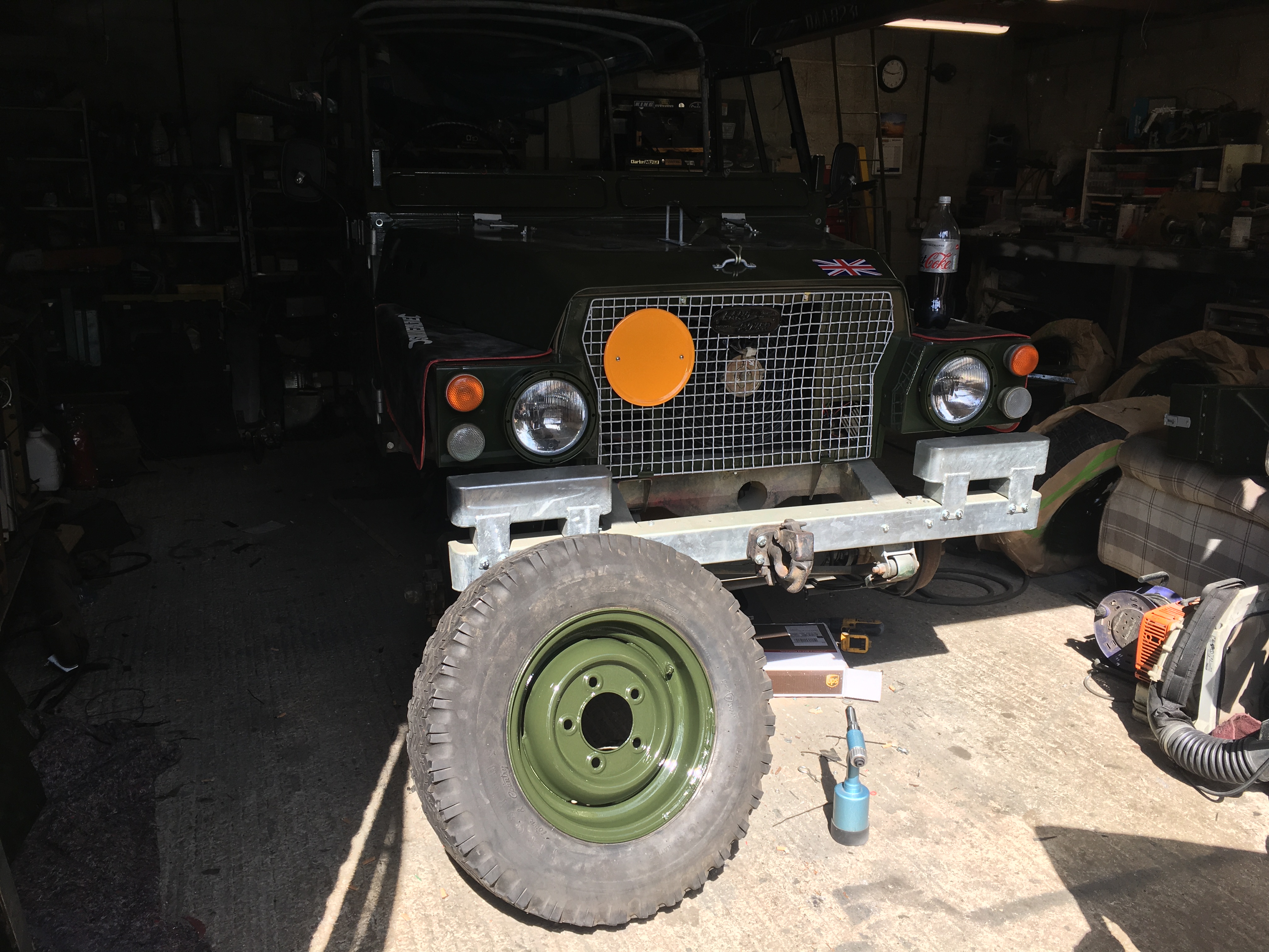

Couldn’t resist putting the spare on, first time the spare has been there in years!

Re: 19FM37
That really is looking good. I am very impressed with the wing protectors, "tidy!" as they say in these parts! Incidentally, a good easy way of asking tyres when you're spraying the wheels is to use a pack of playing cards. Wedged between the wheel and tyre and overlapped, they're quick to fit and quick to remove afterwards. Mine is a set of "Happy Families", but any set will do!

Cheers, I’m liking it more and more again,
I searched the house top to bottom for any part packs of cards, ended up using half decent printer paper, frog masking tape and masking paper, I was amazed it worked
Put them on yesterday evening, not tightened the nuts yet tho, looking at it now I might have to find a 2 1/4 petrol engine as it’s nearly standard again
Think I’ve got a way to do the screen hinge bolts, helicoil and jb weld, will look better than a bolt right through.
Nearly time to drag it out and finish another project and start another before the wiring arrives

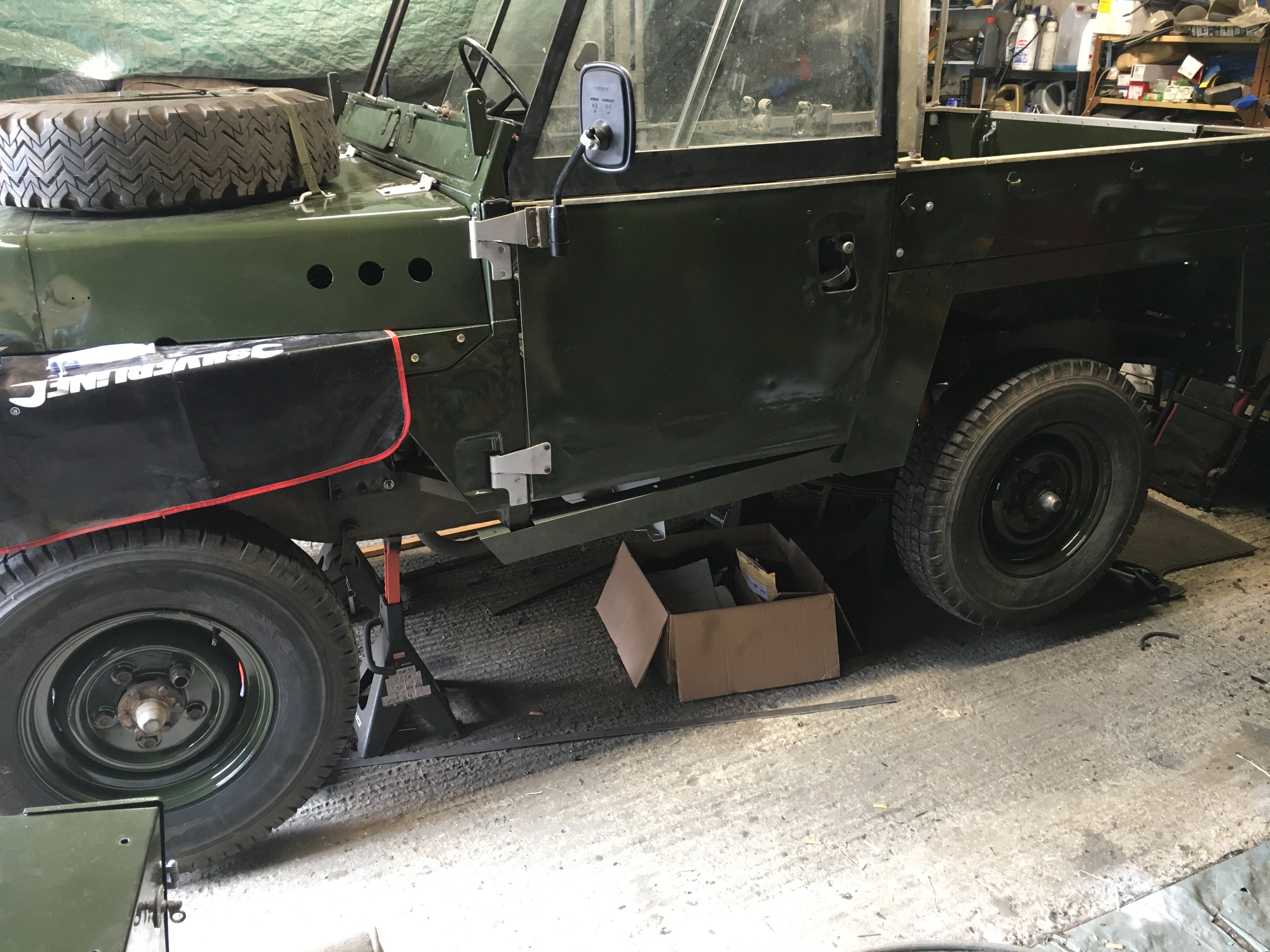

Bit of tinkering thus afternoon, having fun with the windscreen.......
The hinge itself on both sides when left as they were meant the gutter hit the washer jets, so took the jets off, still not going back far enough at the top
So thought of turning the hinge upside down, both snapped
but, screen goes back to where it’s needed.
Has anyone had similar? they need currently to sit in a “n” not a “u” if you get my meaning.
So, eBay to the rescue for two hinges, they don’t look as bent as the ones fitted before so we will see!
Fitted the vent panel door seals and painted up 2 of the 3 for the near side door so fit those at some point.
Drivers door has the seals on, seem to catch a bit and the seat box to tub bolts are a bit proud so the bottom of the door sticks out a bit
Need to find some night vision goggles too

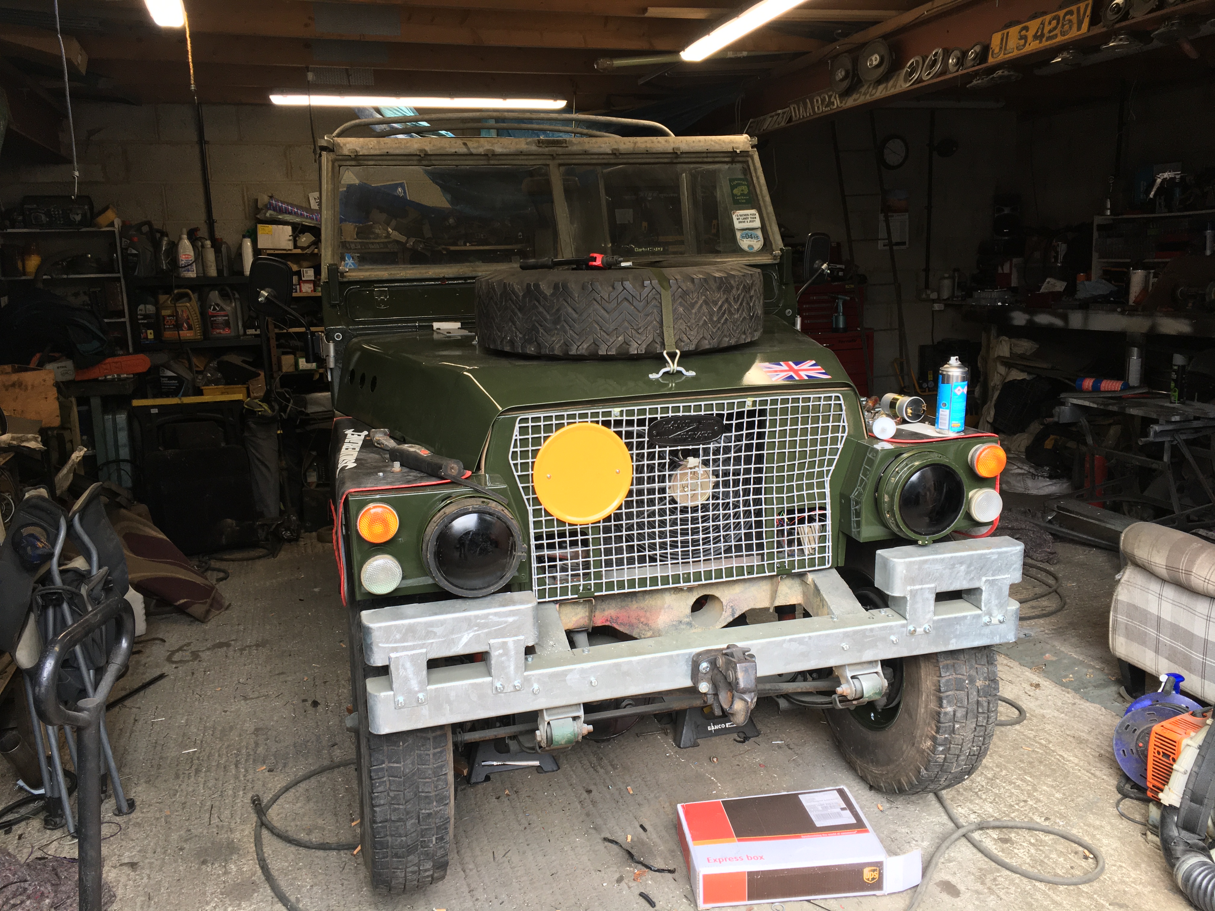

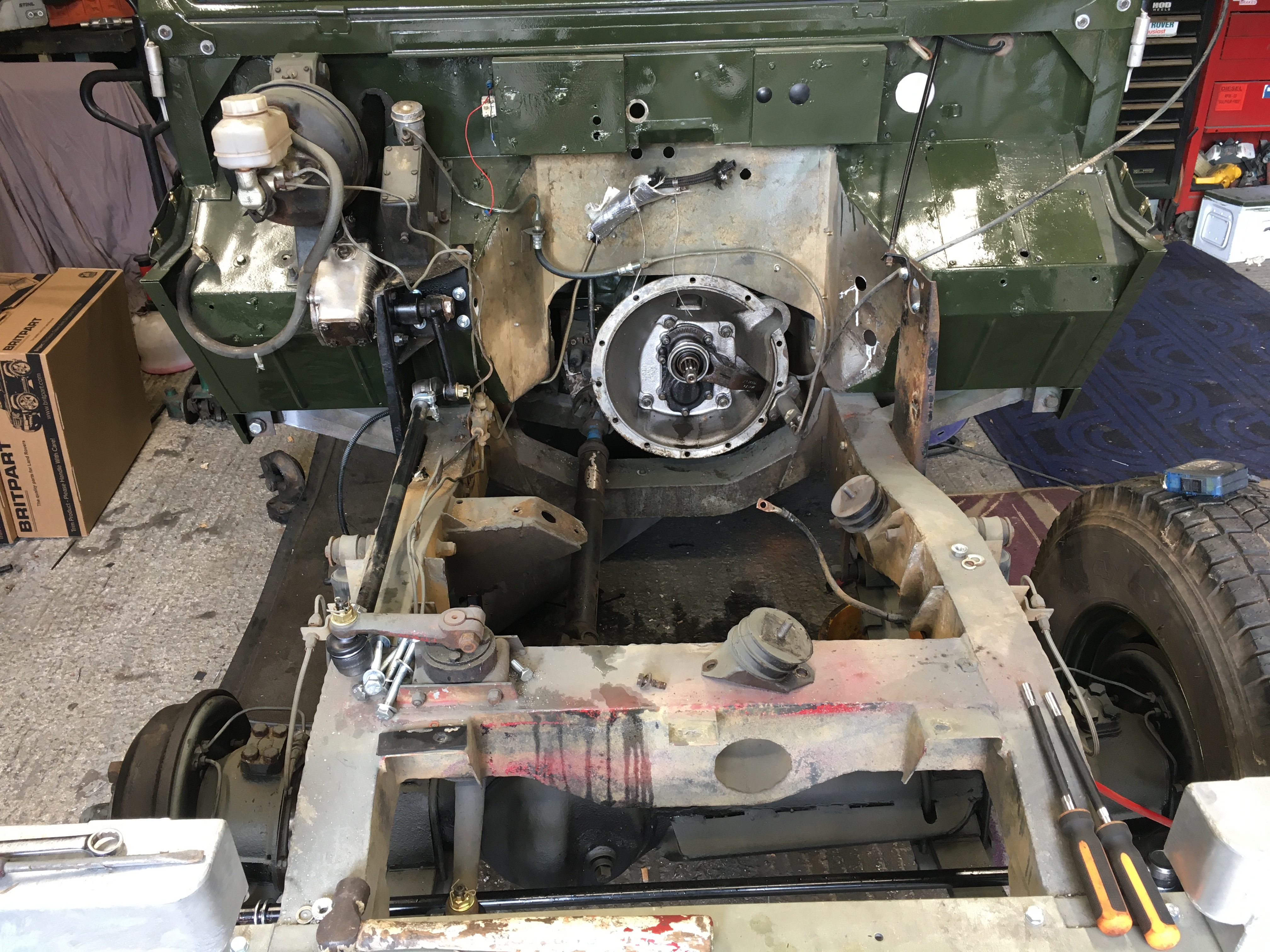

Hi all
Big change of plans today, out with the v8!
Going to fit an original 2 1/4 petrol which all being well will be here next week.
Some welding needed, no battery/ air filter mount but can pinch one off the donor along with the associated bracket.
Have got the fan cowl and a few other bits kicking round so all being well only need a carb elbow, new clutch, exhaust and a few other bits.
Will need to change both diffs at some point as currently fitted with 3:54s so will probably raid the donor again, guessing way over geared with 3:54s on 7.50s
Half the seats arrived today ( just the backs)
so the inside can be carried on with.
What’s the original colour of military engines? Chap says it looks tatty but rebuilt back in the day so will give it a coat of paint before it goes in, I’ll be running it on the crane before paying, but assured it’s a good runner, he is taking the donors old lump as a core unit.
Can finish painting the bulkhead too
The 110 might get a v8 next, dont think 3.5l will be enough in my 90 thanks to the weight and tyre size etc.
- 2B22BE28-2B60-4504-A213-A6698FB546B1.jpeg (2.83 MiB) Viewed 2266 times

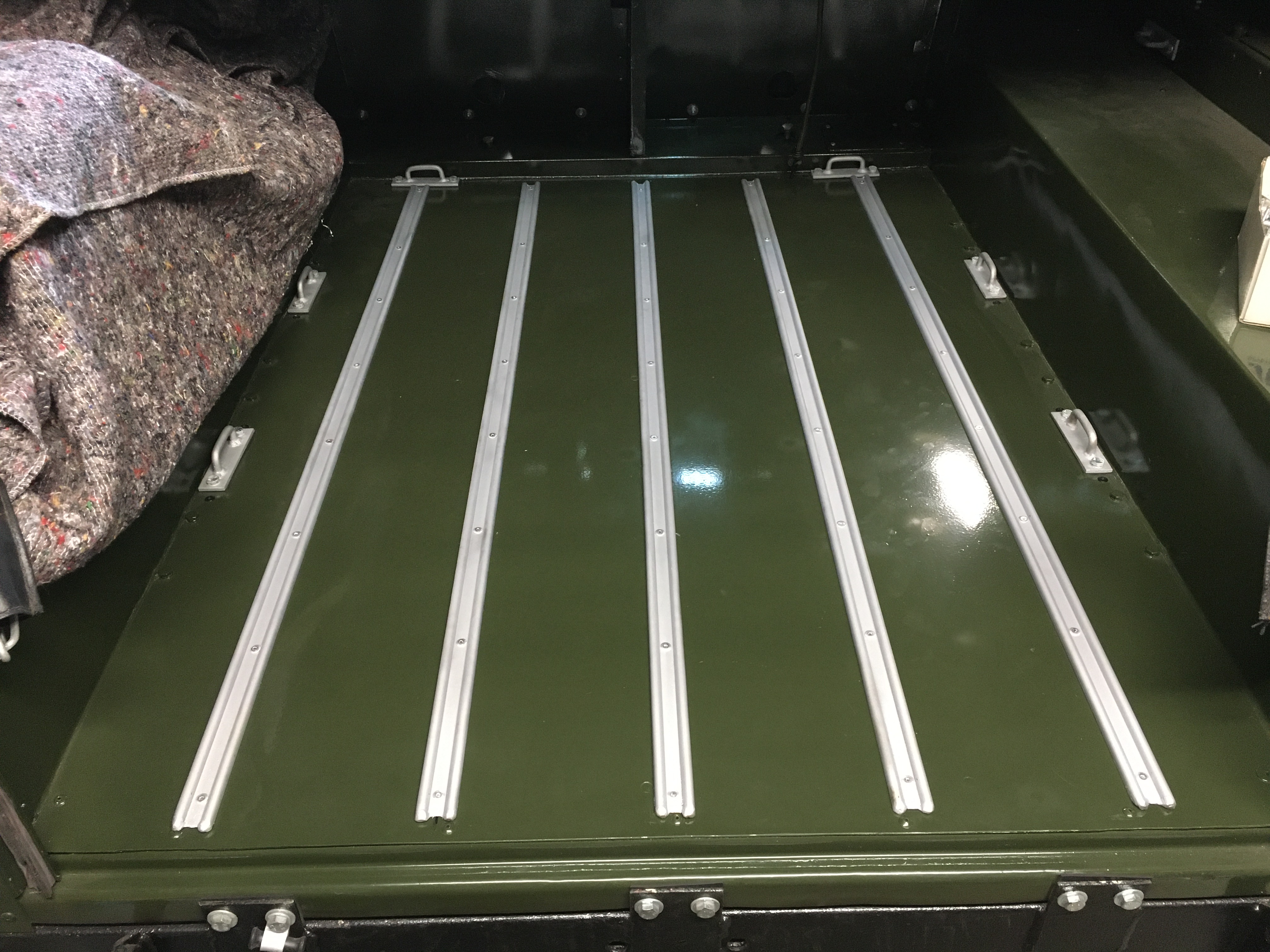

Waiting for the engine to arrive, so sorting other bits, bell crank for the throttle arrived today so cleaned it up and temporarily fitted ( so I don’t lose it
) welding hopefully done in the next few days.
Lots of bits on order so fingers crossed it can be fitted reasonably quick.
Fitted the tub floor strips earlier too, might mess with the seats later.
Anyone know the best screws to use to hold the base on?
