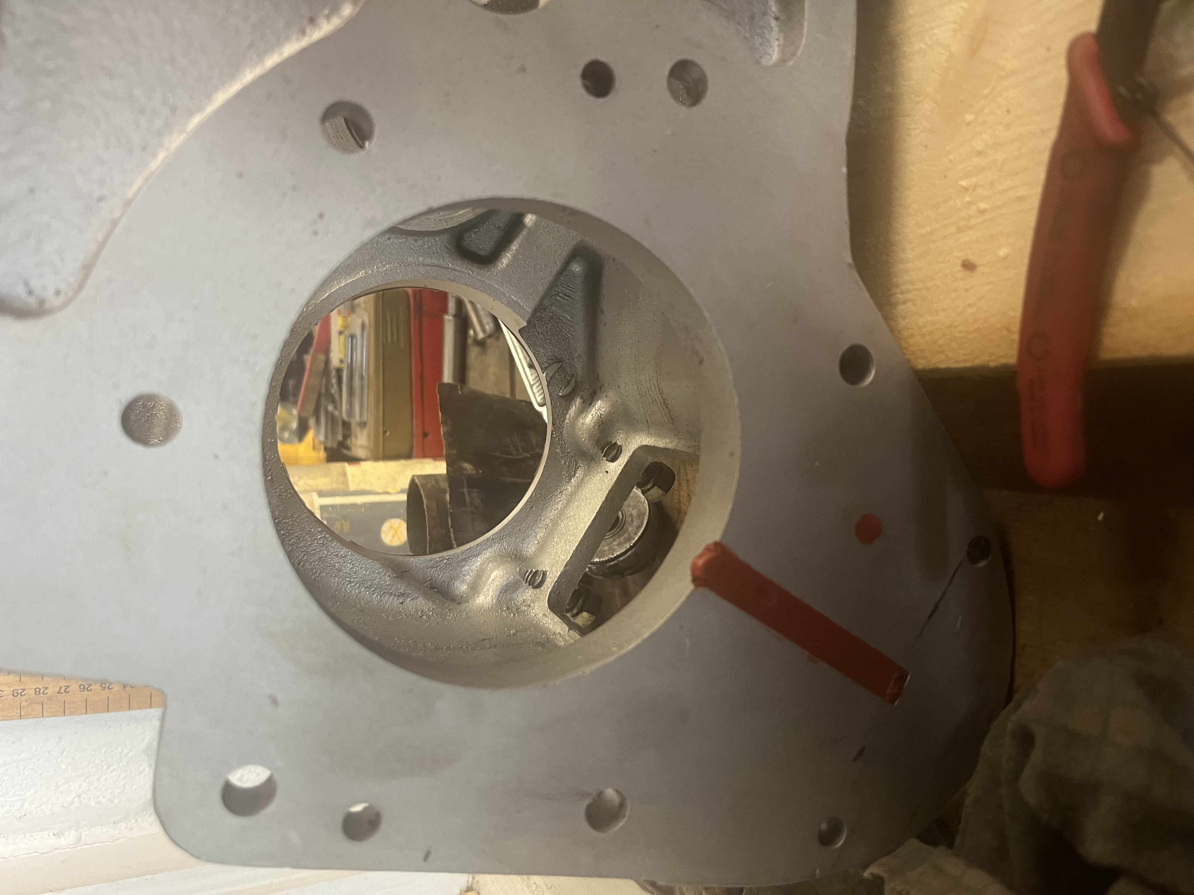

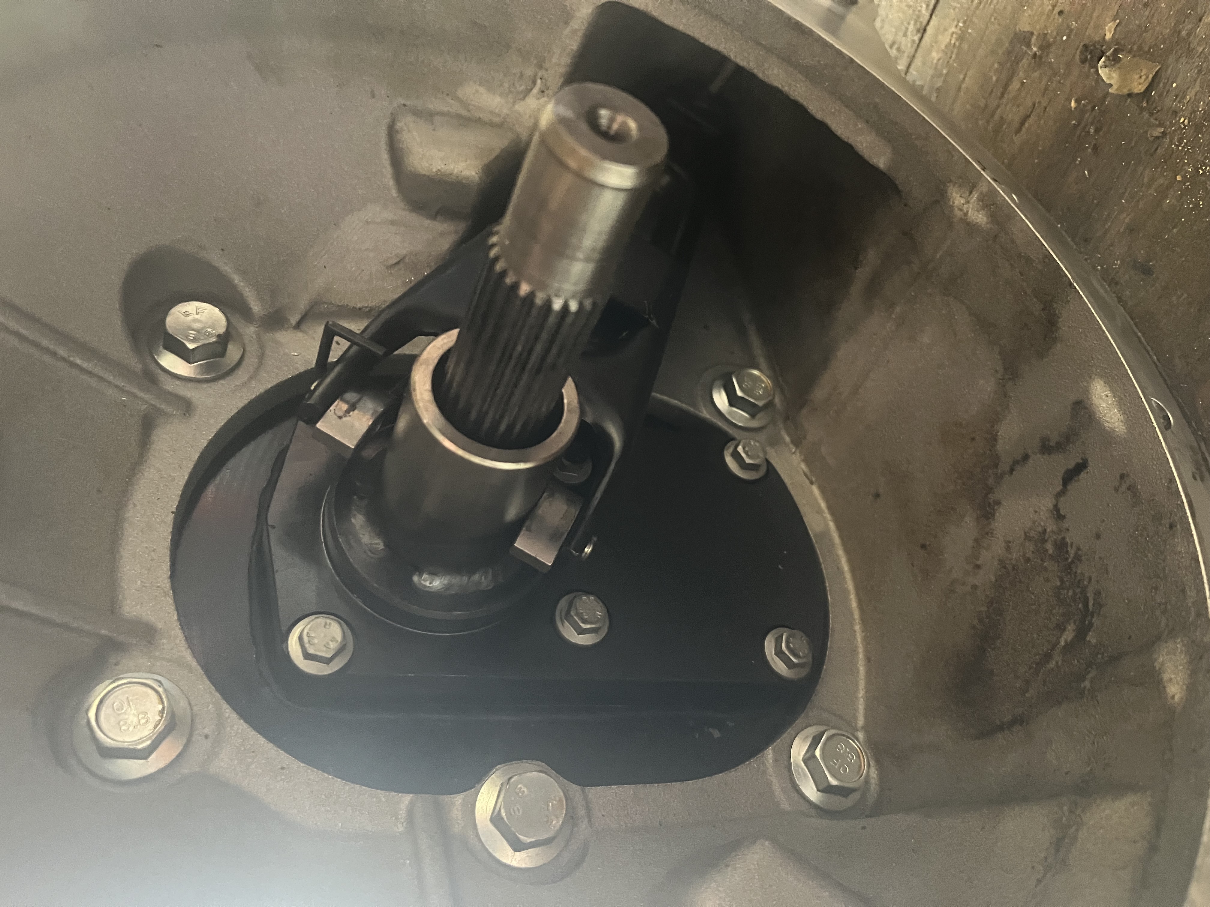

It’s now fully rebuilt and fitted to the R380 gearbox.
The next picture shows the Ashcroft Transmissions Series transfer box to R380 adaptor.

As most conversions don’t go exactly as you want them we found when fitting the R380 gearbox the engine no longer lined up correctly to the bell housing, despite using the Ashcroft Transmissions shortened version with all the correct hole spacings. The way round this was achieved by adding some small rubber washers 4mm thick to rotate the engine position. While the engine was out we took the opportunity to replace the rubber mountings.
