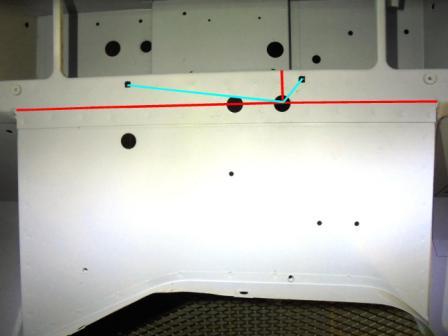

Re: 03 GF 12
Post by AR4412 » Sun Oct 29, 2023 2:50 pm
These measurements are for the left hand heater pipe hole, again a 19mm hole.
Heater Holes 2.JPG (29.24 KiB) Viewed 1411 times
The distance of the red vertical line from hole centre to the bottom edge of the binnacle hole is 38mm
The distance of the left red horizontal line from hole centre to the left edge of the firewall panel is 273mm, to the right edge is 227mm
The distance of the left blue diagonal line from hole centre to left dash screw hole centre is 130mm
The distance of the right blue diagonal line to the right dash screw hole centre is 80mm
Re: 03 GF 12
Post by AR4412 » Sun Oct 29, 2023 2:57 pm
These measurements are for the right hand heater pipe hole, again a 19mm hole. It's hole centre is 52mm from the left hole's centre.
Heater Holes 3.JPG (29.07 KiB) Viewed 1411 times
The distance of the red horizontal line from hole centre to the left edge of the firewall panel is 328mm, to the right edge it is 172mm
The distance of the blue vertical line from hole centre to left dash screw hole centre is 183mm
The distance of the blue right diagonal line to the right dash screw hole centre is 35mm
I hope these measurements help, and if they're not there and you require the measurements for the lower heater mounting holes , let me know and I can measure them for you. But, as a 1975 vehicle the rivnuts should be there in your bulkhead unless removed for some reason, like a snapped bolt, or rip out on undoing a bolt.

Those measurements are superb, it will be so straightforward for me to mark out and drill those holes. By the way, what are the other much smaller holes for? The one near the centre and the pair off towards the right?

I don't remember anything being in the small central hole, but would have to check the rebuild pics to be sure. The pair of holes on the right are for the starter solenoid mounting bolts.

Re: 03 GF 12
Post by AR4412 » Mon Oct 30, 2023 3:15 pm
I remembered what the small central hole is for in the bulkhead panel earlier, but have only just had chance to post. It's to secure the P-clip that holds the positive lead from the battery to the starter solenoid.
