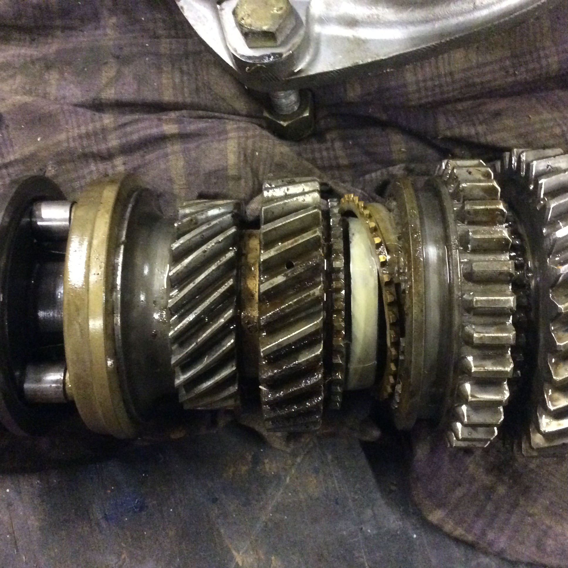

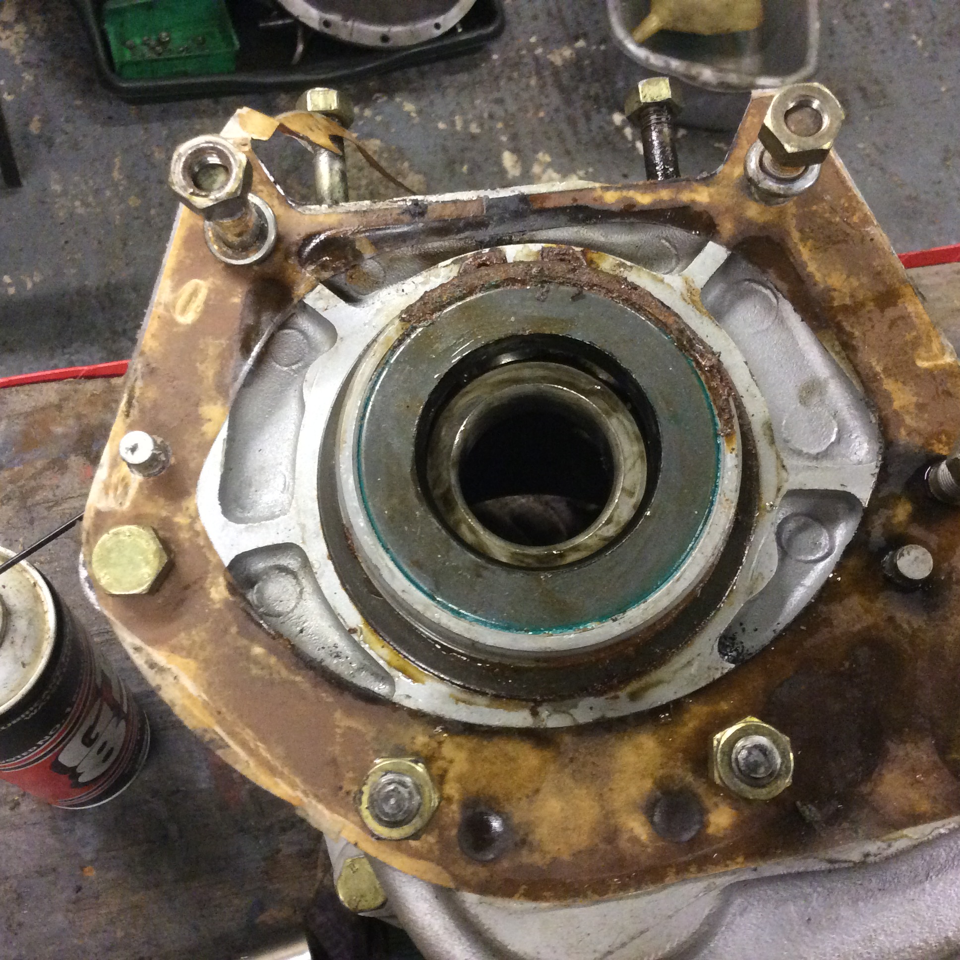

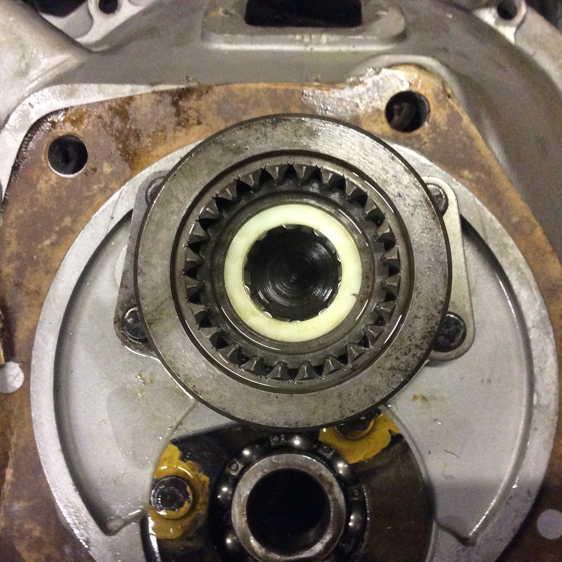

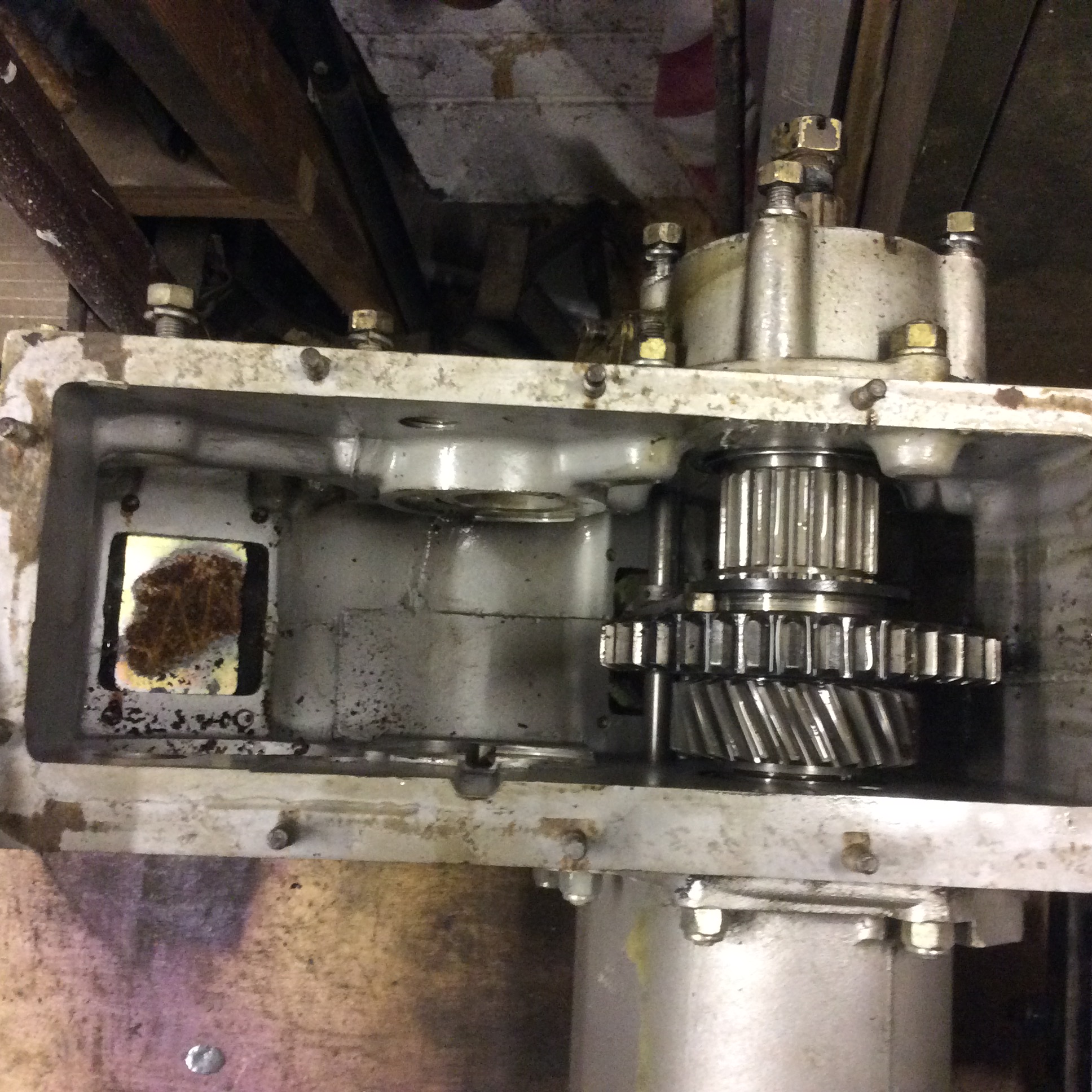

These are some previous ones of my rebuild gearbox after 200 miles driving and then 4 years of water damage without knowing. All caused by an inspection plate having been put on with sealer with a 10mm gap at the top edge (not by me lol).

More rust :shock:

Amazing what some plain water can do to a perfect gearbox.

landyseb
Re: Stu's Tdi project
Post by landyseb » Tue Mar 22, 2016 8:49 pm
Hi Stu, Quick Tip.... In the 3rd pic showing main gearbox case, please make sure the bearing/seal housing is a good and tight fit in the casting. If you have to remove it for any reason be sure to that the correct locktite compound is applied to it before refitting and that it is a tight press fit in the casing. If not it will allow all your mainbox oil to migrate into the transfer box and destroy the mainbox gears and spacers. In the last year i have had to repair 2 gearboxes for customers that had been reconditioned by a reputable specialist (who shall remain nameless) less than 20k miles before..
Cheers Adam
StuWright
Posts: 1740
Location: Southampton
Post by StuWright » Wed Mar 23, 2016 12:00 am
landyseb wrote:Hi Stu, Quick Tip.... In the 3rd pic showing main gearbox case, please make sure the bearing/seal housing is a good and tight fit in the casting. If you have to remove it for any reason be sure to that the correct locktite compound is applied to it before refitting and that it is a tight press fit in the casing. If not it will allow all your mainbox oil to migrate into the transfer box and destroy the mainbox gears and spacers. In the last year i have had to repair 2 gearboxes for customers that had been reconditioned by a reputable specialist (who shall remain nameless) less than 20k miles before..
Cheers Adam
Yes it was really tight Adam, but great tip that I would not have thought of. I will make sure I keep a careful eye on the levels.
