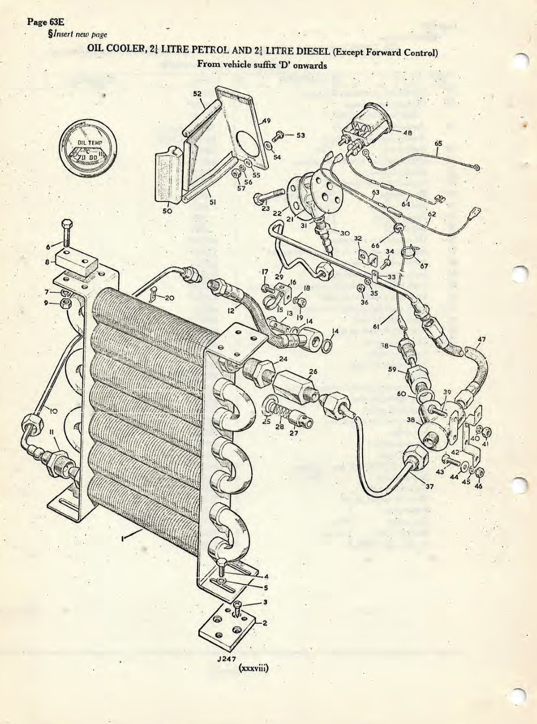

I've found a better version which covers more parts and and includes the ones marked NLS in the other diagram.
Does anybody recognise this page layout/font etc. and know where it's from, please?

That looks to be an ammendment page which would be added to an original parts list. The font does look to be similar to the one used on earlier LR parts lists. I have had a look at various lists/books at work, but haven't come across that particular image.

Spot the difference: - ^^^^
From the diagrams it is clear the systems had been reversed between S2a & S3.
S2a pipework runs from the oil pump on the right to the top of the cooler on the left. Then bottom of the cooler on the right to the sump on the right.
S3 pipework runs from the oil pump on the right to the bottom of the cooler on the right. Then top of the cooler on the left to the sump on the left.
This makes the S2a sump different from the S3 too.
Spot the mistake: - ^^^^
S3 diagram assembly 624094 appears to show the non-return valve the wrong way round - bound to cause confusion.
