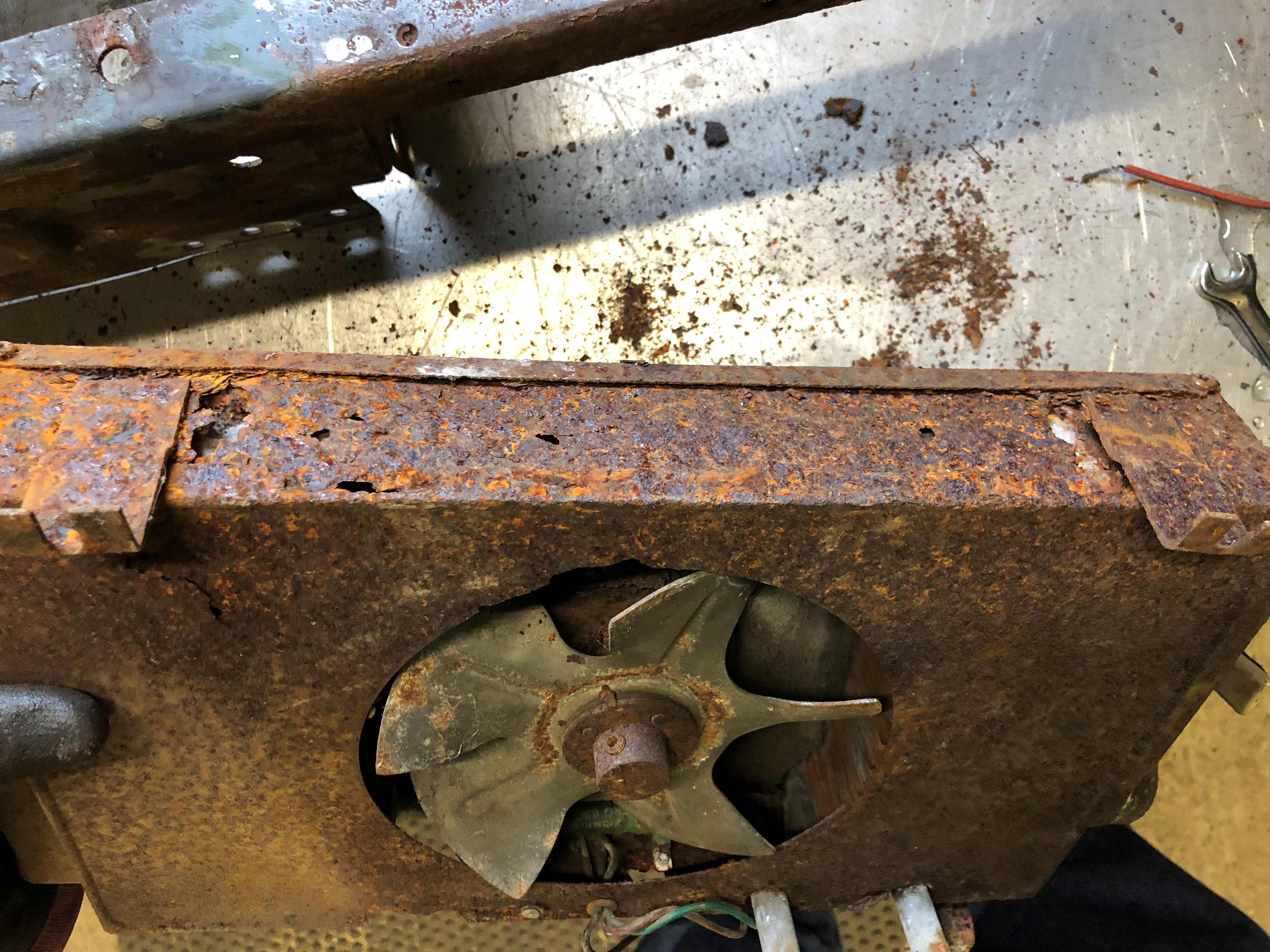

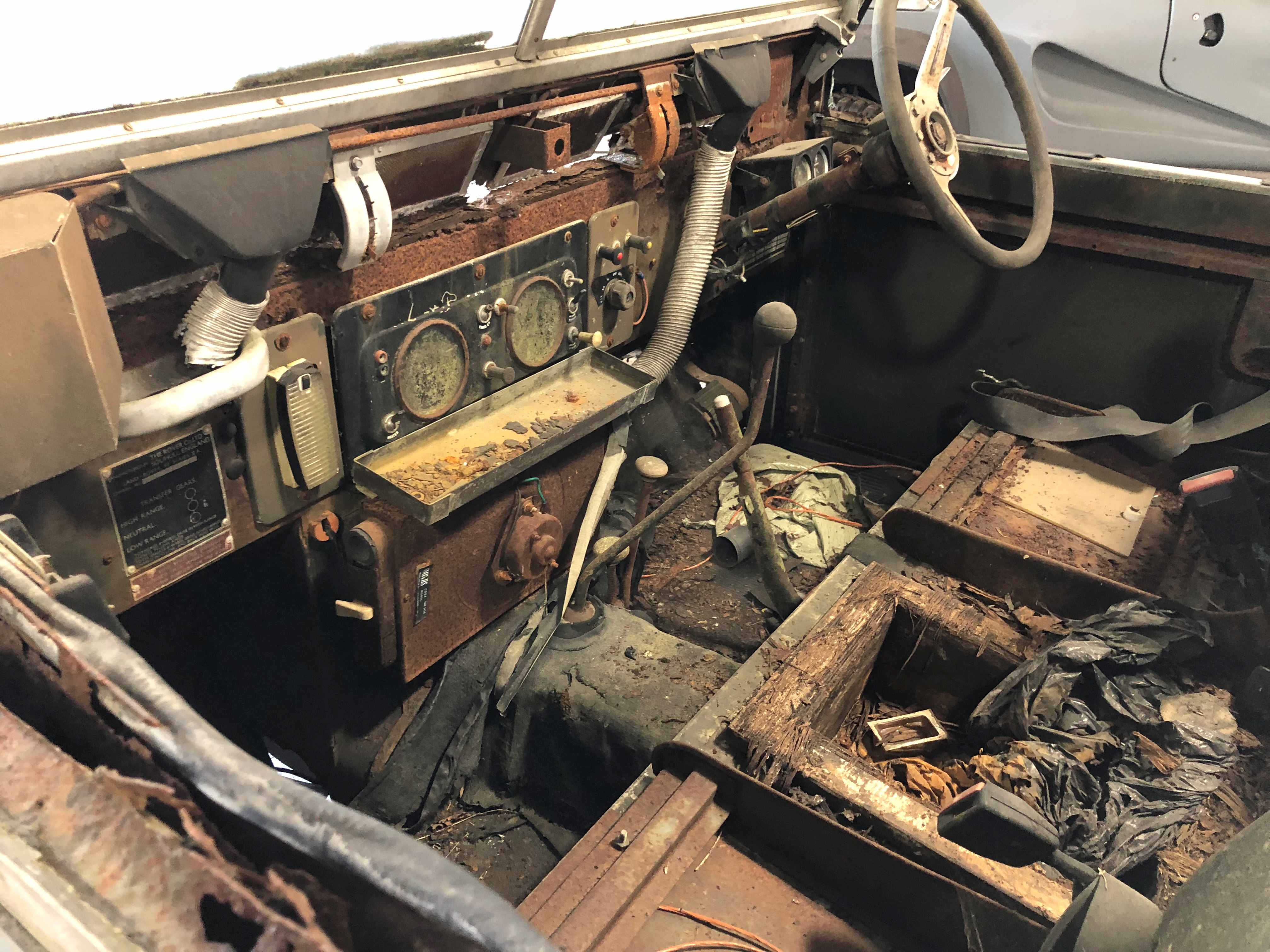

Can anybody explain what differences (if any) there were between the flat heater fitted to cvilin models and ones fitted to Lightweights? Also was there a difference between S2A and S3 units? My LWT is a December 1968 build and as it was one pretty much one of the first contracts (WV7478), I'm assuming that it was not originally supplied with a heater and that the flat heater in it was in all likelihood fitted after disposal. My heater was badly rusted up (as per the image) so I just rebuilt it into another casing I got on eBay. All the parts were compatible - hence wondering what the differences may be.

Except the 24 volt thing, where applicable, no difference, exactly the same I've got one of each.
The lightweight needs that bit of angled aluminium above it to give it something to bolt on to at the top. the S2A has the really useful little shelf thing which the heater sits under and bolts straight onto.
I believe the flat heater came out on the S2A when they also moved to a single wiper motor mounted in the corner, driving both wipers, which I think was around '68-ish.
I stand to be corrected but I think all lightweights got the flat heater as standard.

I'm unsure of timeline/Contact Numbers, but the first Lightweights weren't fitted with heaters IIRC. There is a Modification Instruction, EMER Q 027/4 No.4 for the Fitting of commercial heater/demister on contract WV8679 (only) and vehicles used in NW Europe., shown in the back of MJC's book. So, A guess would be that prior to WV9753 no heaters were fitted on production.
I haven't been able to find an copy of the modification instruction online, so I think the only likely place to find a copy is the REME Museum, or Clives loft. (Hiya Clive!
(Oh how I wish I had stolen/made a copy of this kind of information when it was available to me in my younger years.
How many heaters were retrofitted in service, and how many after, would probably be in the land of pure guesswork by now.
