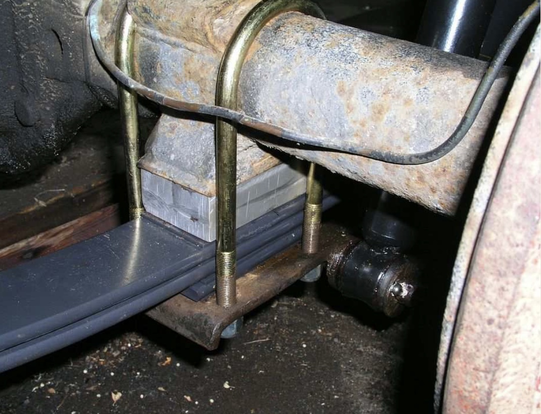

2. I’ve seen on another series forum where they lowered the height by installing blocks like the following picture shows. I have to say having read that late last night I need to look at the suspension to get my head around how this works.The intention is to drop it an inch to help the angle.

I did read about using wedges to alter the angle of the rear diff but I don’t really have much info of how this is done and where they can be bought from yet. If I could get the prop to be virtually inline it would eliminate that issue so any ideas would be appreciated.

Wedges will angle the nose of the diff upwards, (Or downwards if fitted the other way around.), lessening the angle the propshaft joints are having to work through.
Have a search for Land Rover/Series caster correction blocks/shims/wedges and plenty should pop up. I'm pretty sure that they are available in various degrees of correction, but haven't looked myself.

Yes I have found some wedges on ebay thanks listed as Land Rover Series 2/3 leaf spring castor correction plate pair. They are only £11,49 for some that goes from 0-13mm and classed as small correction.
Do you think these would be better that the blocks? I can't find the blocks but I have somewhere that could make some SS ones for me cheap if I give them the size I need.

The trouble with blocks as I see it are that they lower the overall height of the rear of the vehicle, which can, depending on the springs fitted and height of the blocks fitted, leave it looking low as if the springs have sagged. Not a problem if you have parabolics as most of them make the back end stupidly high anyway. Alongside that, you loose the block's height in clearance between the tyres and the tub, and the axle and the bumpstops, which can be a problem if the vehicle is used off tarmac and needs the articulation. The springs themselves will also be running closer to the ground in relative terms. Whilst moving the axle/diff upwards will lessen the angle the propshaft is running at, it will also shorten the propshaft's overall length. Loosing the free length in the propshaft sliding joint is again a problem over bumps and full compression of the springs, especially with a shorter than standard propshaft where it may bottom out. Only removing the prop from your rear diff and moving it upwards by the height of the blocks you intend to fit whilst still vertically in line with the diff flange will let you know if there will be any issues with the propshaft's new length.
Fitting the correction shims/wedges will leave the axle roughly where it is now as you're only really rotating the axle case to bring the nose of the diff up. Whilst it will move the nose of the diff closer to the transfer box than it was, they will lessen the angles the prop runs at, but it doesn't have quite such an effect on the overall length of the propshaft. Plus, for the cost, it has got to be worth a try before going to the expense of having blocks made.

Spot on reply that makes sense to me. I think I will start with fitting the 13mm wedges which are the first basic step and see how it goes. I am hopeful all problems relate to the transfer box and once rebuild it will solve the issue. I am doing the prop as a belt and braces approach now I know there is an improved way of doing this, even though the extra articulated joints nay have been enough.
