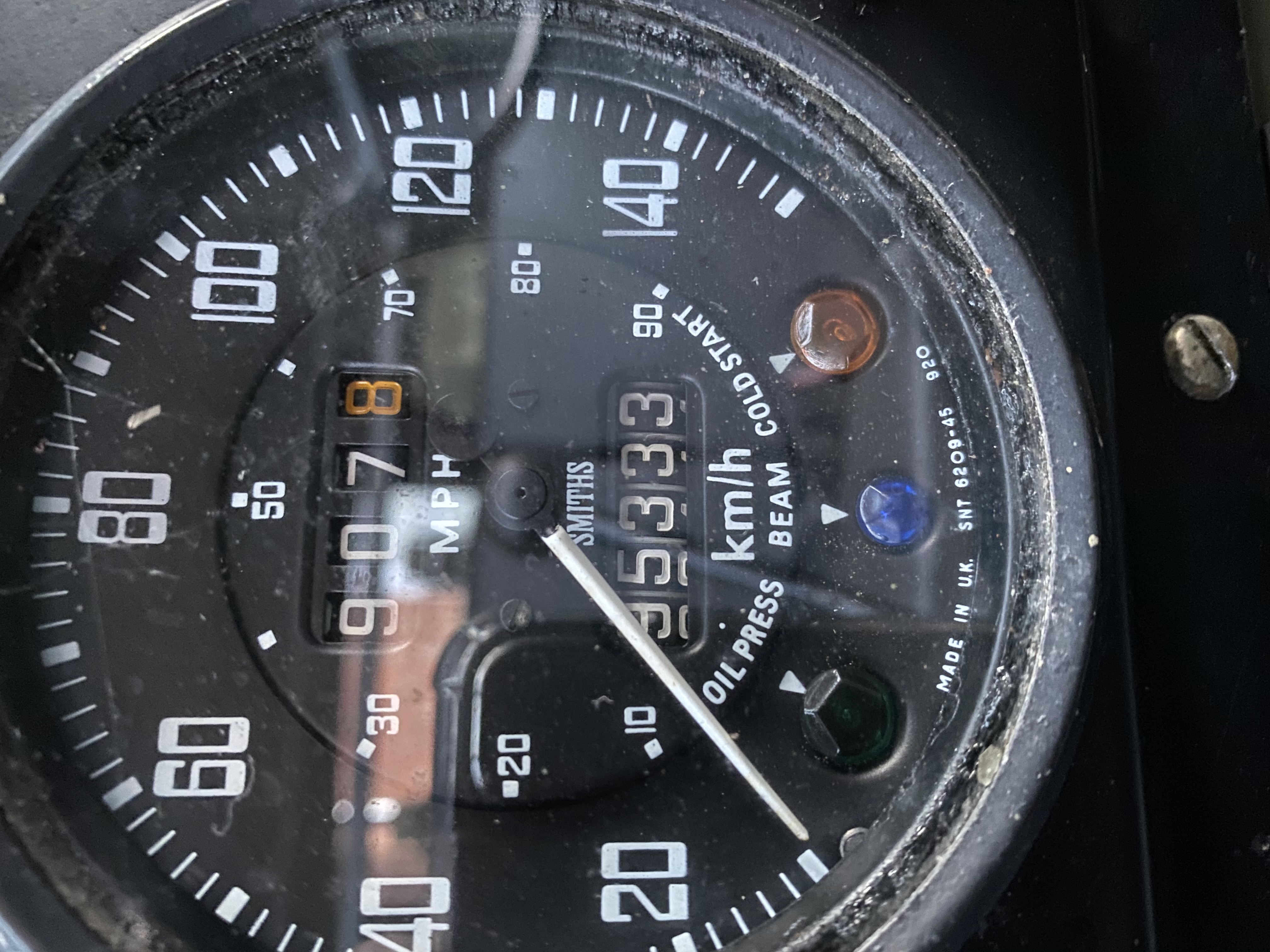

Post by Jamie » Thu Nov 09, 2023 5:35 pm
Hi Neil
Here is the front on my speedo if you can make sense of that.
Jamie

Post by AR4412 » Fri Nov 10, 2023 9:30 am
Hi Jamie,

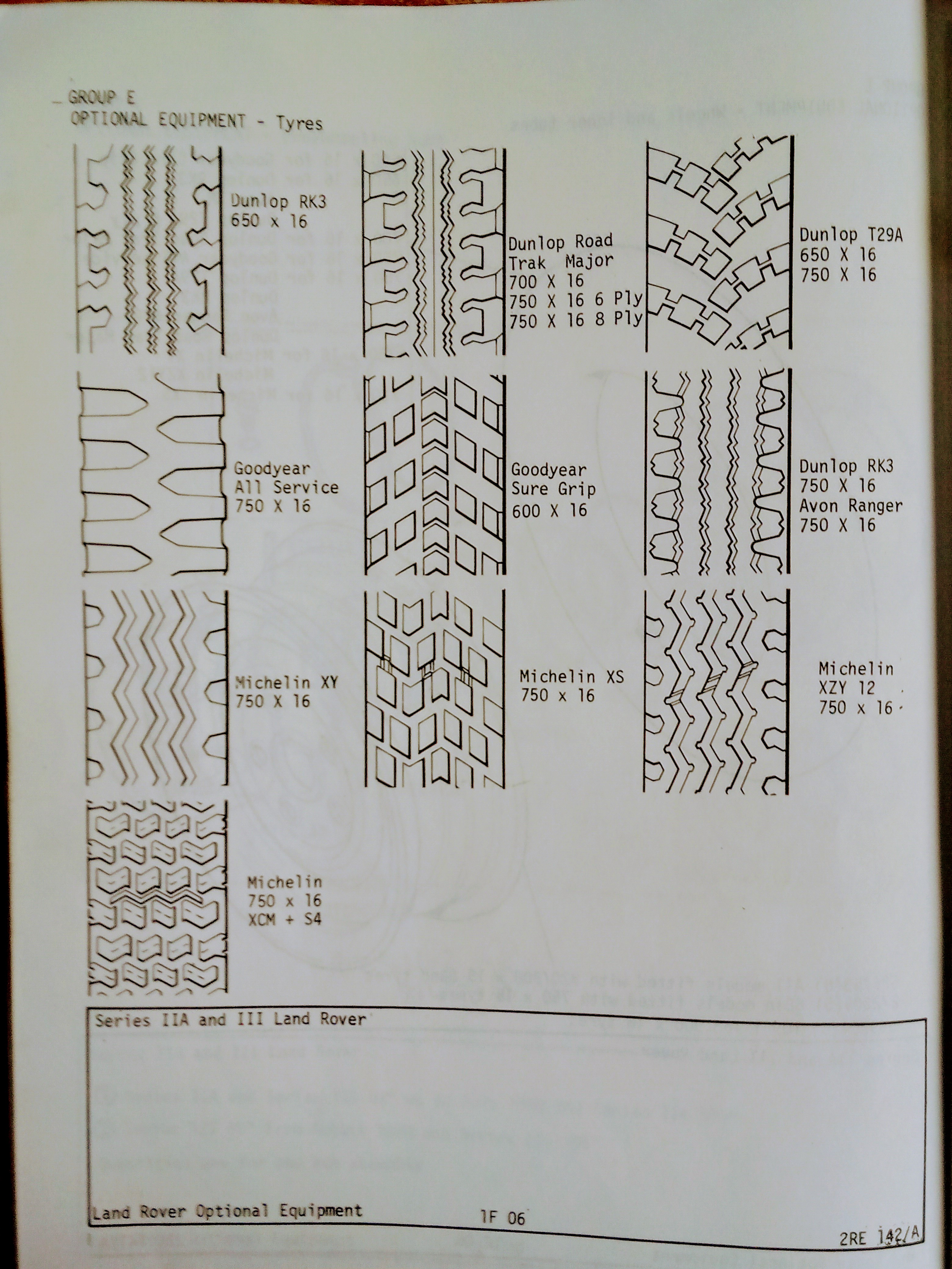

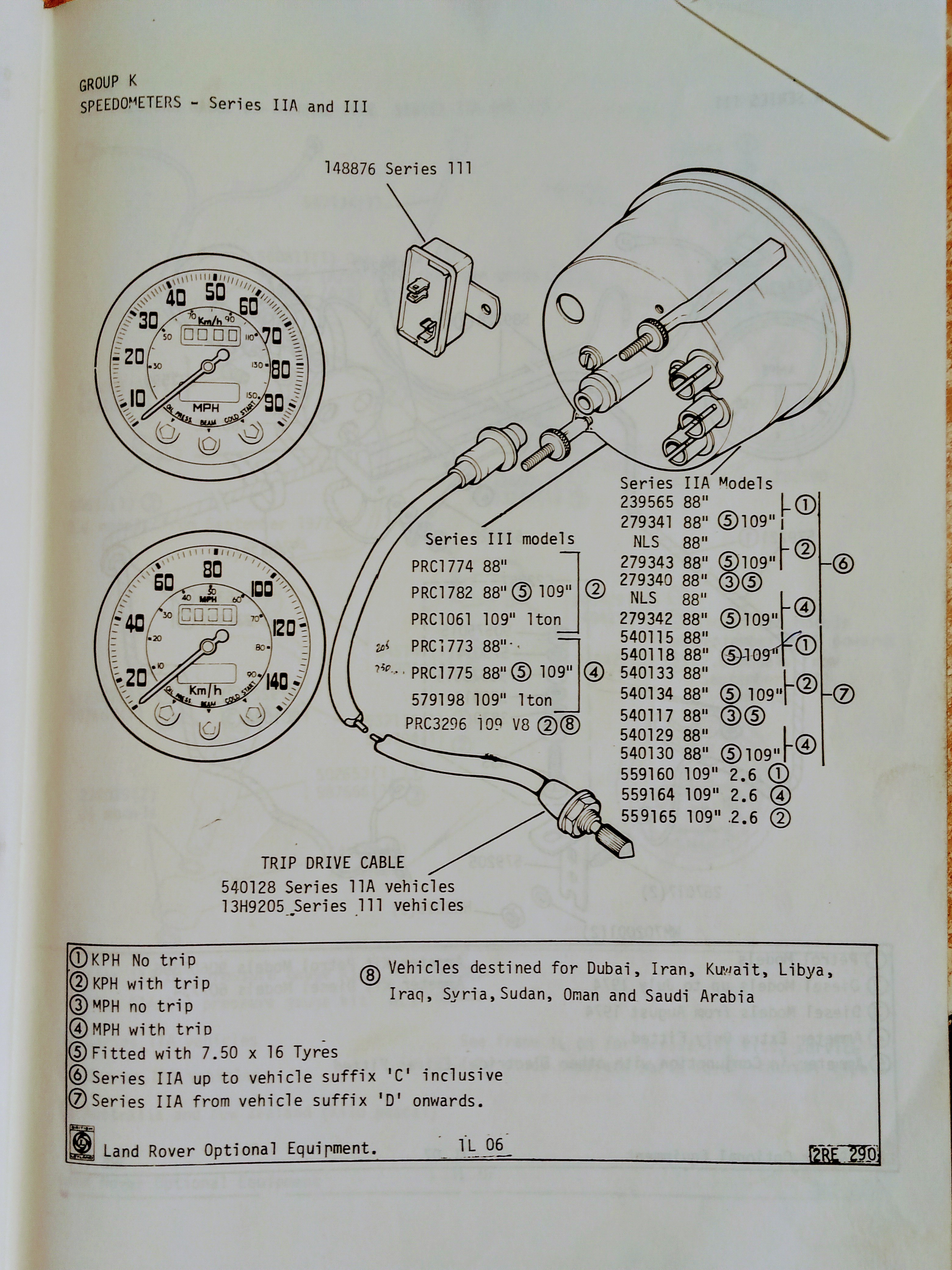

I tried finding that Speedo last night, but even the Smiths/Jaeger lists I found don't list an SNT 6209-45 speedometer. I did find some other applications that had a KMH '920' Speedo, but no Land Rover speedo's on the lists.
I looked into the optional parts catalogue as I was sure I had previously seen a 7.00x16 tyre in there, and I had.
So I looked a speedo options to see what was there.
We just need to find images of, or info on, the KMH ones to see if one matches yours.

Post by Jamie » Fri Nov 10, 2023 2:24 pm
Thanks Neil, I appreciate you looking. It is possible the speedo has been changed out by a previous owner but from what I can see of its history the mileage looks genuine.
These things are never straight forward. I posted a question on the Facebook lightweight group asking what the original tyre size would be for a 1983 lwt and I thing the general opinion was 7.50's... but who knows for sure. I actually prefer the larger tyre. I'm currently looking at some Deestone 7.50 x16's.
Again, thanks for your help, any info will be appreciated.
