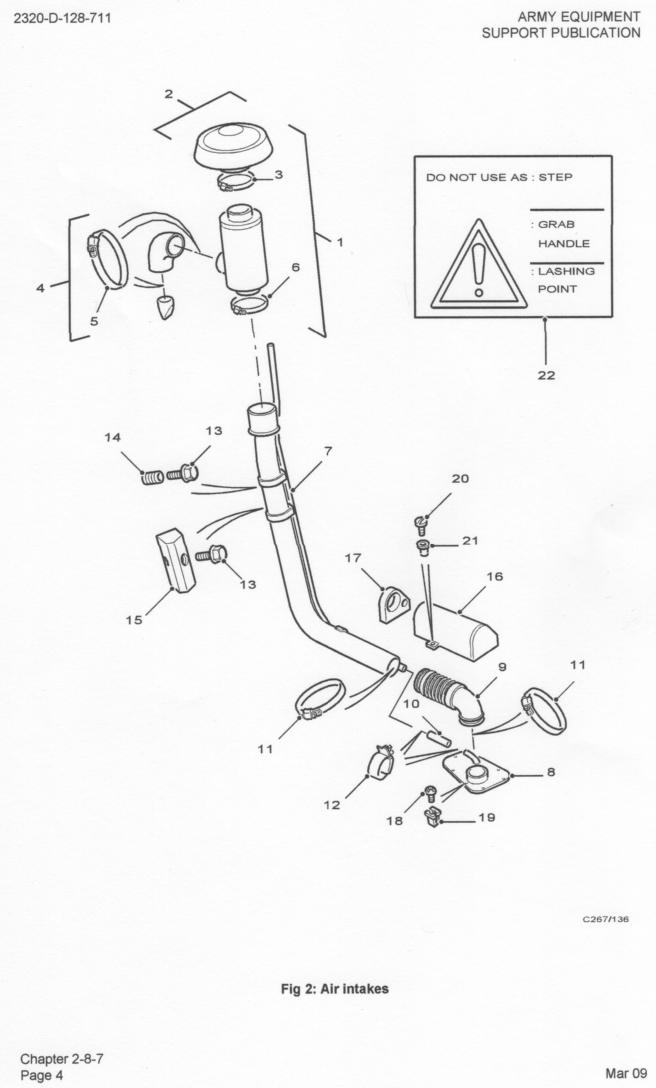

I have recently swapped my Series 2a Lightweight for a 1999 Wolf Winter Water recently decommissioned from MoD. The winter water comes with a specialist raised air intake. Mine was without the complete assembly when I bought it from the military supplier. It does have the unique Donaldson cyclone and the top wing mount section and cover. However, I am looking for the connecting pipework and breather tube if anyone has/knows where to get one of these? I would take a complete kit if that makes it any easier.
Wolf winter water raised air intake

I'm not aware of anyone doing a full kit for the Winter/Wader, but they might be out there. There was a part number for the full 'Desert' intake kit that was the Snorkel kit made by Mantec, so it is possible. You could try such places as Blanchards or Withams. IIRC Withams did auction off a pallet of the top sections, and I believe that even B###part do an OEM complete replacement for the top section.
Here's a pic of the intake parts. And here's the parts list with the relevant part numbers. Unfortunately, I don't have a single part number that covers everything from the wing to the top cap.

Thanks for that. Very useful parts list. I shall being my research, and this will be a great help. Mantec will be first port of call. Have spoken to Donaldson already, thinking that they might have built the pipework, but they don't and they knocked me from pillar to post. Withams etc require regular checking up to see what they have...very binary, but thanks for reminding me about them. Will call again tomorrow.

The Mantec raised intake, if you can find one, is totally different as it fits to the wing's side intake where the air is drawn in on the standard 300Tdi/Td5/Tdci .
It can be seen in this link.
https://rimmerbros.com/Item--i-LL1174MET
